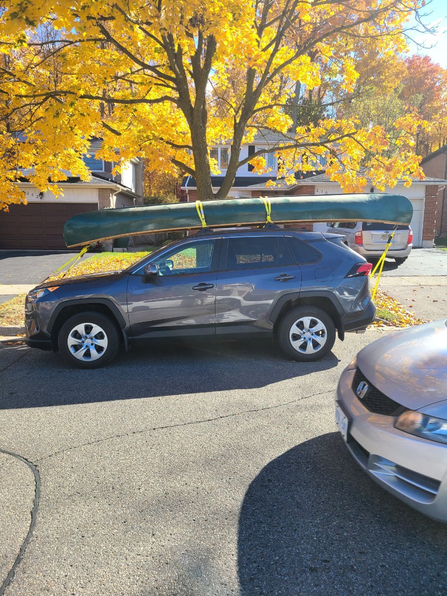

Fwiw, here's my 16' on our SUV. (Factory roof rack with added foam padding )
