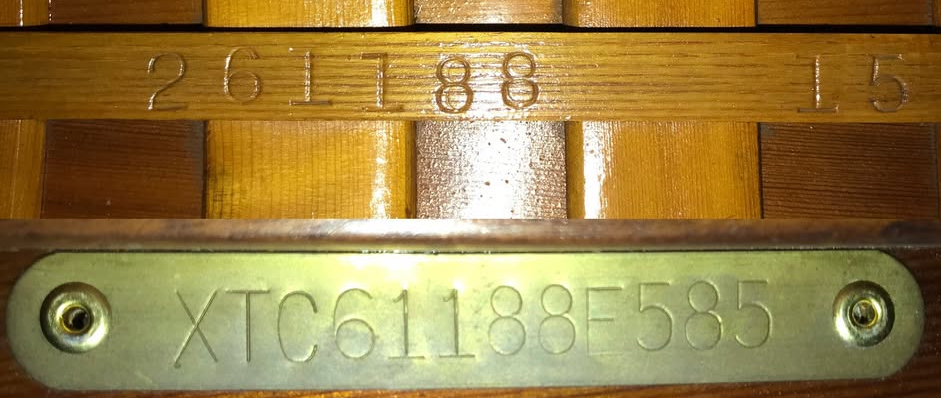

It has also been pointed out that the digits for ones and sevens along with threes and eights are frequently confused in serial numbers. The image at http://www.wcha.org/forums/index.php?attachments/41135/ may be useful to help distinguish these digits.

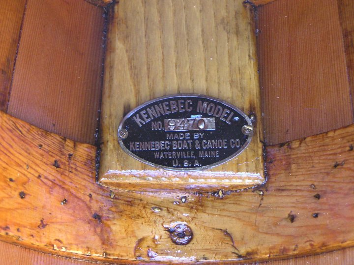

The Morris Canoe Company of Veazie, Maine is known to have used brass tags for their serial numbers in a variety of locations including the forward port gunwale, inside stem, and bow seat frame as shown below.
