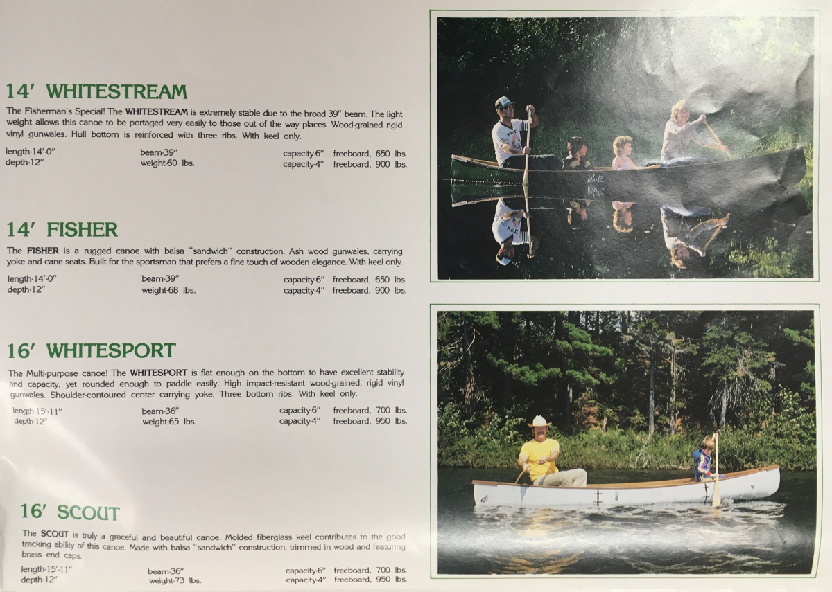

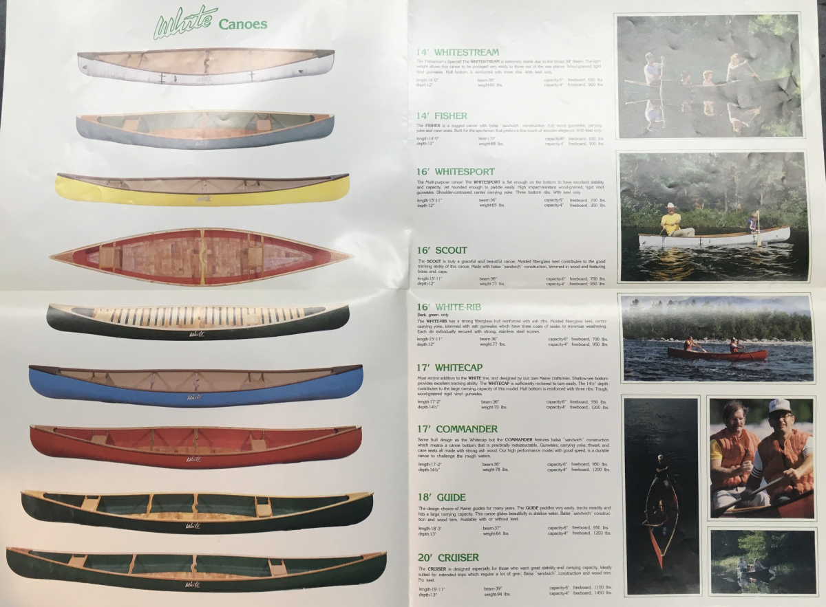

There are no White serial number records available from before 1984 when they were purchased by Old Town. The HIN indicates that it was made by White in May, 1980. The page below from an early 1980s White catalog may help. Good luck,
Thanks for the info. Would they have made the 16’ Scout in green as well as red? My canoe looks exactly like the 18’ guide and 20’ cruiser shown but definitely measures 16’.
Pufferplateau, the balsa doesn't add strength, it just keeps the inner and outer fiberglass layers apart, and the separation is what adds strength. Kind of like the vertical part of an I beam.
It was the “brass” end caps I couldn’t read. So when I acquired my boat 10 or so years ago it didn’t have any brass on it. Would these end caps be where the gunwales come together and are they necessary? I just found a guy here in Northern VT that makes gunwales and I’m going to order a new set from him as soon as I take a measurement!
