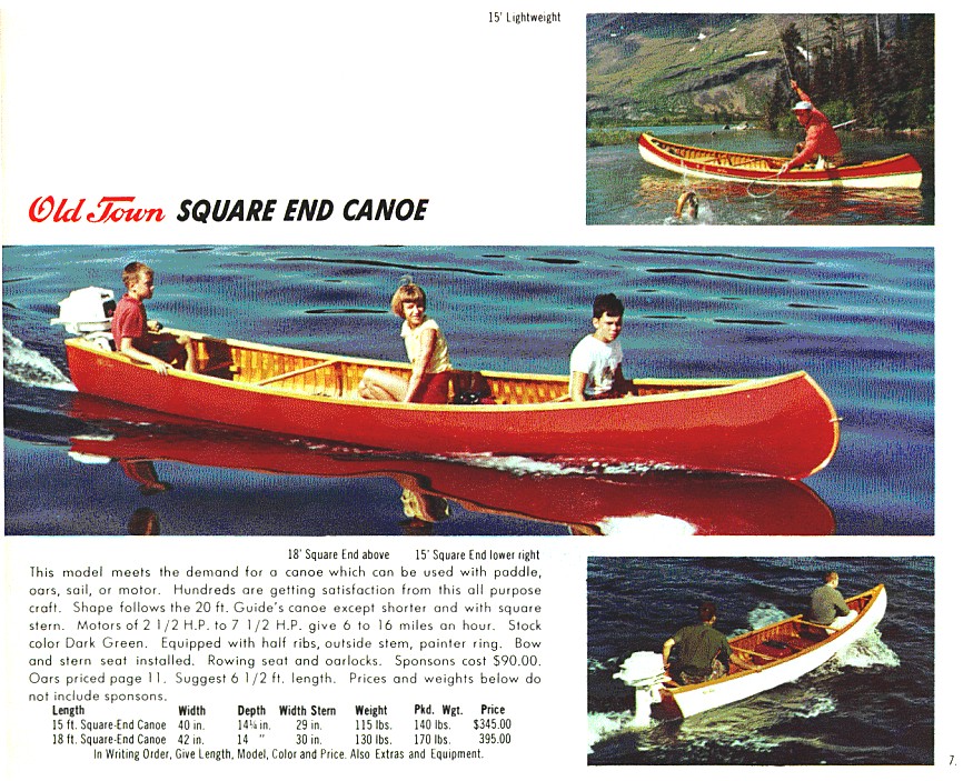

It appears to be a later Old Town square end model as Dan suggested. This is shown at https://forums.wcha.org/attachments/42320/ from the 1966 catalog. The suggestions at the link below may help you locate the serial number. It may be on the transom edge under the modifications. Please post pictures here if you find it.
