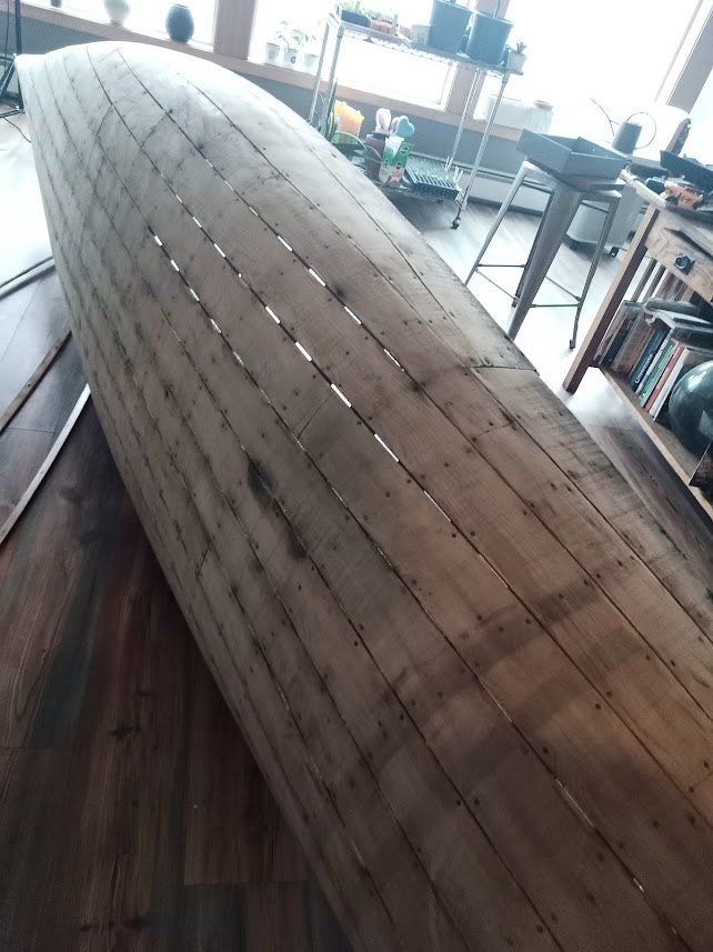

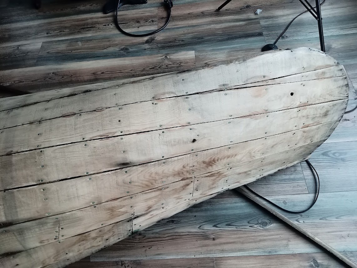

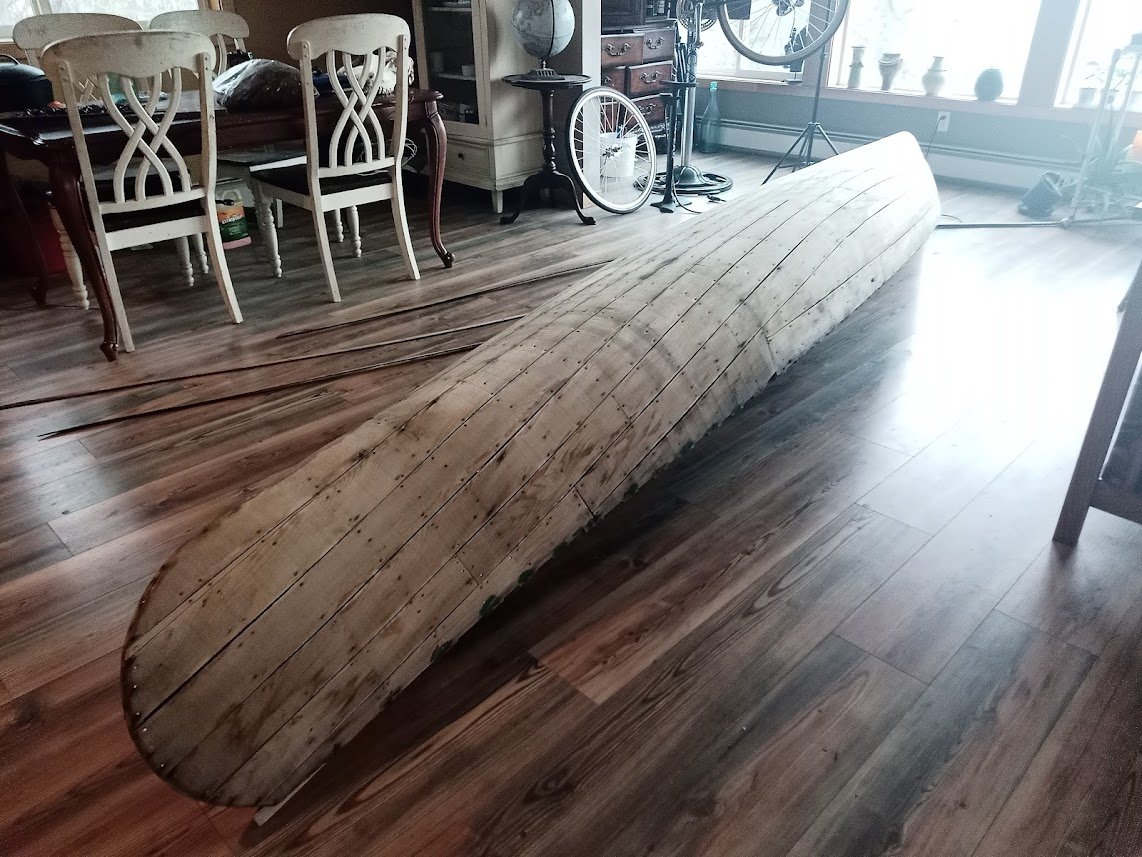

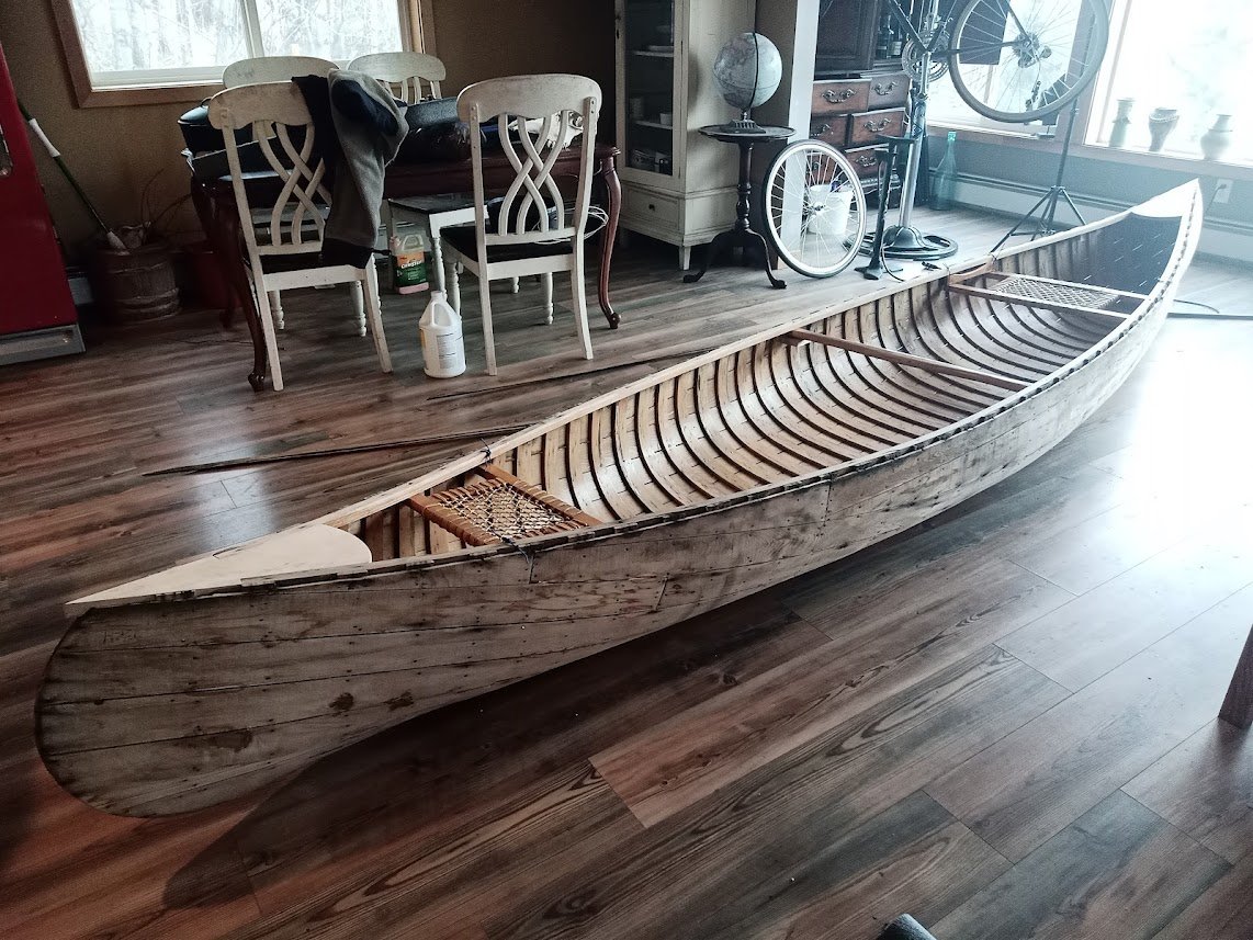

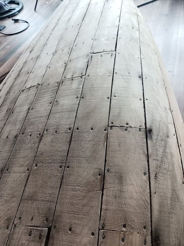

I have a good amount of experience with woodworking but this is my first canoe. The first decision I need to make is what material to use for the skin. I would like to use #8 canvas to save on weight (the canoe is not expected to see heavy workhorse type of use) but the frame has plenty of gaps. Even after sanding the surface smooth and proper filling, would the lighter canvas make those gaps more noticeable?

* Don't worry so much about the 'gaps' in the planking. Stretched canvas is wonderful for spanning these gaps.
* Be sure that none of the tacks stand above the planking - they'll be obvious through the canvas. And when in doubt, pull an old one out and tack in a new one. BUT be sure to place a heavy item (like a piece of brass, steel, smooth stone) behind the tack so the end of the tack can 'clench' properly.
* This canoe looks to me like some Canadian made model. They're not known for fine finish work on the outside of the planking. I'd recommend using some sort of sander and smooth down the outside - especially where two planks meet. Sanding is also a great way to identify 'proud' tack heads.

Resist the urge to mix anything with wood dust and use it to fare the hull. The canvas, as Howie notes, will hide a lot of imperfections. Unless you are making a show canoe for display or Omering, you will soon have it dinged up enough that those small imperfections will no longer be noticeable.
