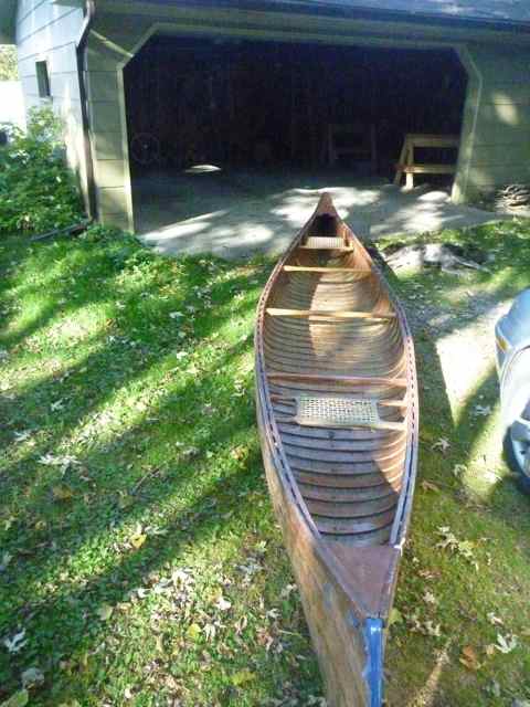

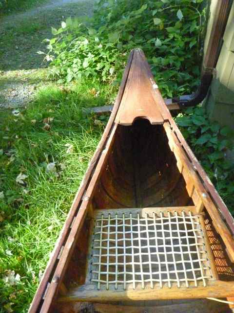

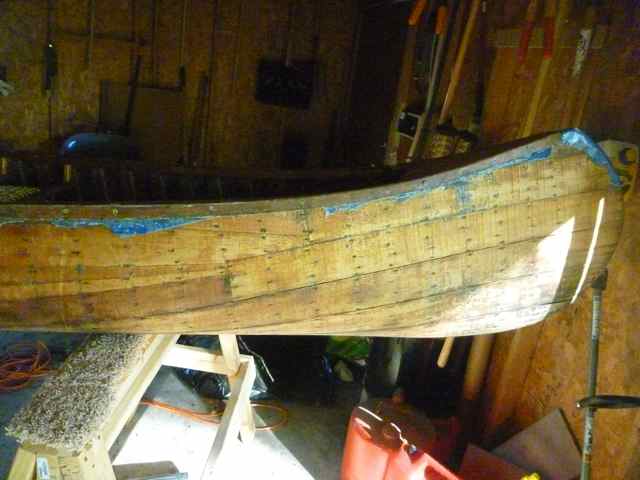

Hi everyone, I am hoping that some of you might help me ID the canoe I am working on restoring. The more I work on the boat the more I want to know its history!!!
We bought the canoe used, the previous owners bought the canoe 40+ years ago secondhand.
Here are the dimensions: 18'x~36"x~11.5".
I have been using the dragonflycanoe.com site as something of a guide, and I am a bit stumped.
The canoe has 3 thwarts (all different woods though apparently) and two seats, though the daughter of the previous owner recalls her dad adding a seat. So, beween all those there are a total of 14 bolts. Seven of those bolts are the diamond heads. For what it is worth, the diamondhead bolts all have square nuts and the round bolts all have, presumably newer, hex nuts.
So, that would lead me to believe it could be a Old Town, possibly a Charles River or Ideal.
However, I looked all over the stems and there seems to be no sign of any SN's. I know the previous owner did some work on the canoe, including glassing it (@&$@$&%!!). The Deck also seems to be not original.
So, while it is possible that the stems were both replaced, I am skeptical as they are not in great shape and based on the other work that was done to the boat I doubt he would have put the effort into replacing both stems. (For example, a very beat up rib was "fixed" with wood puddy and fiberglass).
The canoe had a keel on when I purchased it, which based on the hardware inside the canoe seems to be original.

If there aren't any half-ribs, your canoe wouldn't be the Ideal model.
You've done a lot of groundwork on the canoe's history-- it would be great to have that pan-out, so that you can come up with numbers leading to the build record. After using stripper on the stems, take a digital picture and see what shows up. Compare stems. This video has an easy-to-find serial number, and also shows how we look up the build record once we have the number:

If these numbers are correct, especially the first 3, then the boat looks to have been built in 1915. Two of the build records indicated sponsons, but they may have been removed. Also, there is hardware in one of your pictures for a floor rack, but none of these build records indicate a floor rack. You might also check the shipping locations on the records to see if any of them were in your neighborhood.

Otcas have a longer deck with coaming, and your canoe has the classic OT short deck-- so the Otca can be crossed off... we'll keep looking!

Otcas were built with long (20") decks with coamings through 1956. After that, they used the standard short (16") deck on Otcas. This corresponds with the replacement of the original 16' Otca molds with the Yankee molds.
The deck on the canoe in question is clearly a replacement. Hard to tell if it is a replacement for a long deck - telltales would be the location of screw holes and a small notch in the inwale where the coaming would have set into it.

I'm not as good at profile recognition as others here, but your canoe appears to have more up-sweep than I'd expect in a Guide model.
My thought with this short deck is that someone was trying to replicate what had been there, but it's a good thought to look for signs of an Otca deck.

I am not sure that you can draw any conclusions from these decks as they look tweaked.
It appears to me that these decks were installed over the top of the inside rails during an earlier repair.
Also if you look at the shape, they seem to be atypical.
A close up of the decks would be helpful to confirm this.
