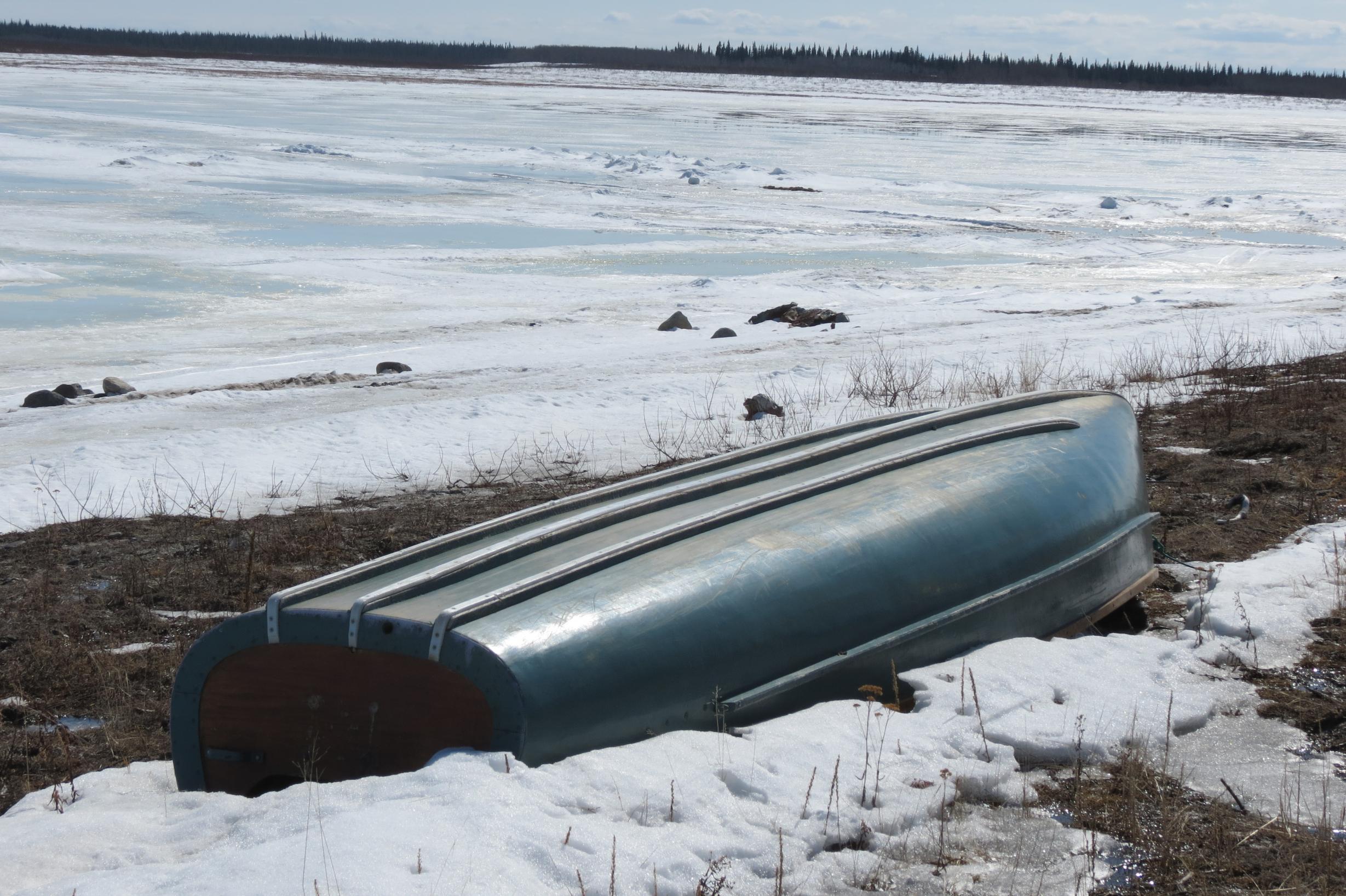

More photos from past weekend....some paddling kayaks already....other canoes waiting for break-up (or restoration)....
Freighter Hulls
More photos from past weekend....other canoes waiting for break-up (or restoration)....

This freighter (attachment referenced) is the only one I have noticed in your photos that shows a broad stern for planing. The ones in the shop photos all seem to have narrow displacement sterns, with barely modified underbodies.
Do many of the candidates for restoration have the broad sterns?
Larry Westlake
No they don't....but there are at least two including the one in the photo that will be restored eventually....it appears that this project may become ongoing....
