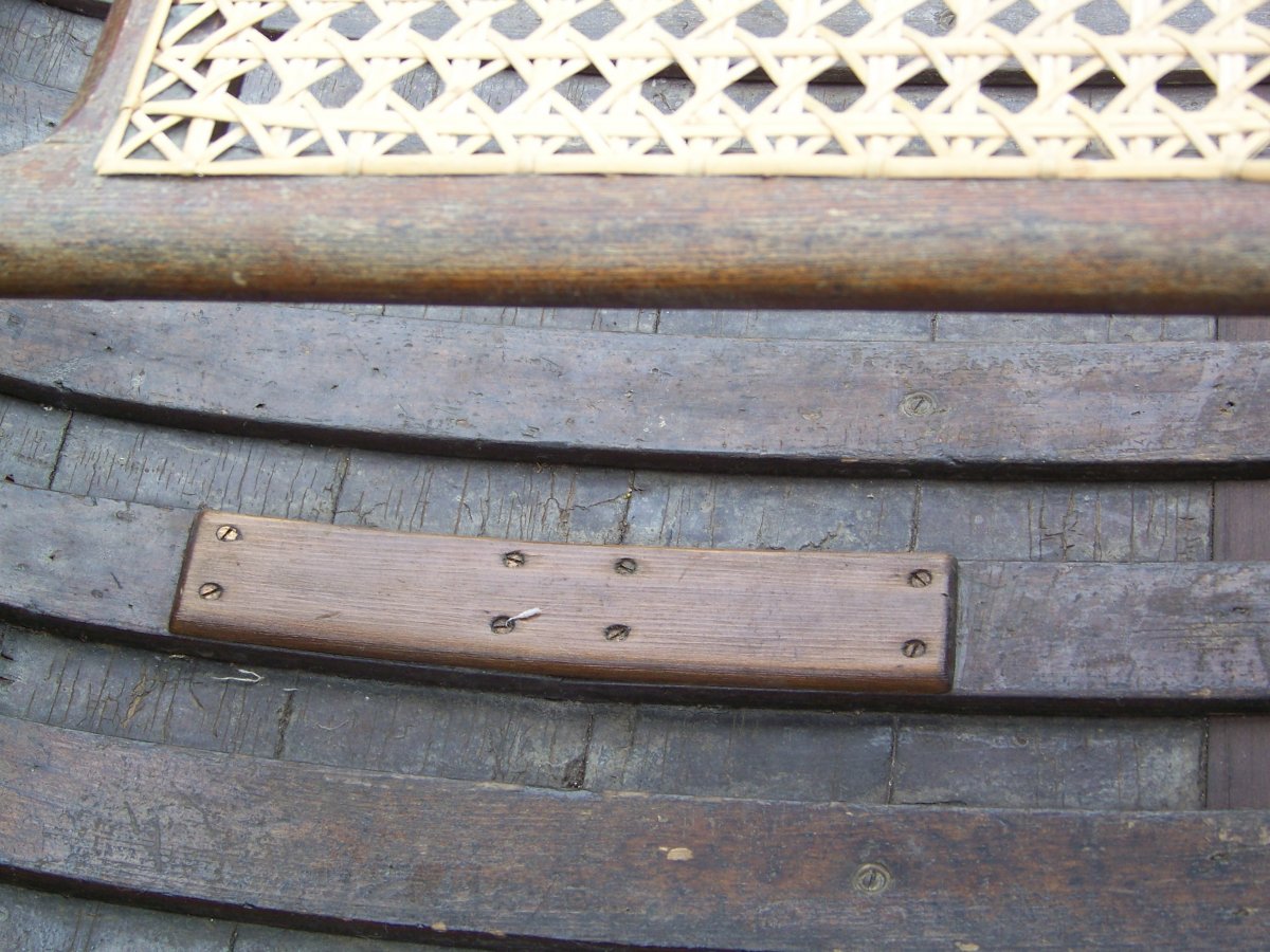

I have located a previous thread discussing wooden patches for ribs. I was going to source some white cedar stock and steam-bend the patches, blend the edges, sand down the varnish, and secure with Titebond 3 and some #8 3/4" silicon bronze screws into the existing rib.
The other option I have read is the use of an epoxy to seep into the crack itself.
This is the example I located.

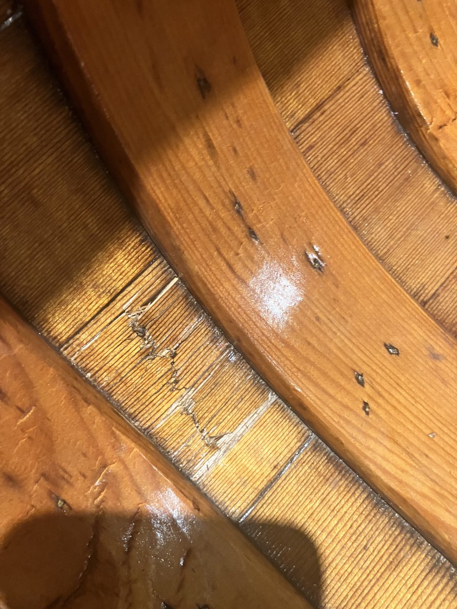

The last issue I see that needs to be addressed is a splintered plank. The canvas is not punctured, but it is soft due to the plank being compromised. I want to stiffen this back up and avoid further damage to the canvas.This is the one I am a bit at a loss for (though my above intentions could be misguided as well). I understand the planking is Western Red Cedar 5/32". Mostly find White cedar planking available. I was considering cutting out the section from the inside, cutting a small plank section to match, and then securing it to a larger wooden patch and securing it to the adjacent planks with epoxy or glue.
This is the soft section.

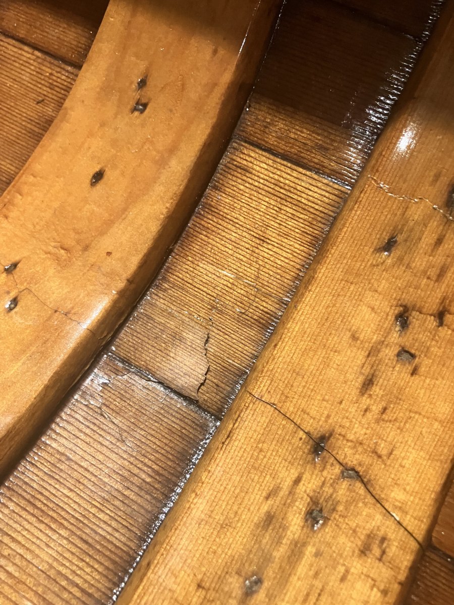

Another similar section. Though still solid underneath, it is an example of the rib cracks.
