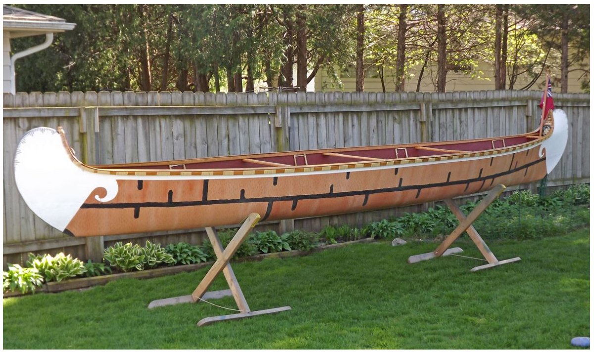

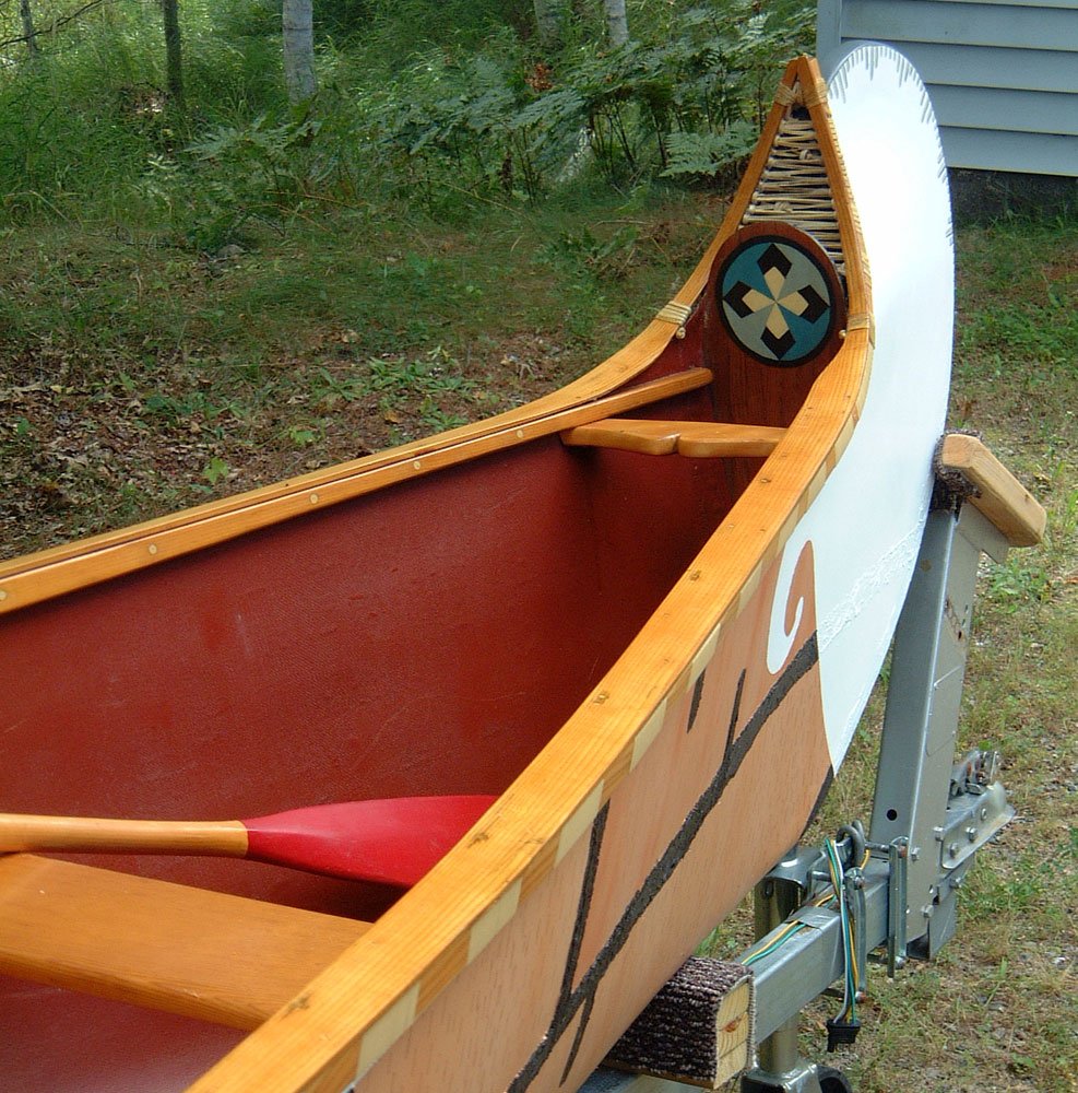

Epoxy resin would be good, except for the fact that it has terrible UV resistance, and that part of the boat is going to be subject to UV every time you use it. It would need paint on top of the resin to protect it. Personally, I'd lightly sand off the stickers, clean it well and give it a coat or two of polyurethane floor enamel or something like Home Depot's "epoxy" (not much) concrete floor enamel. This strip canoe has True Value polyurethane floor enamel which is over 50 years old on the inside, and the outside is the Home Depot concrete floor paint. No primer needed.

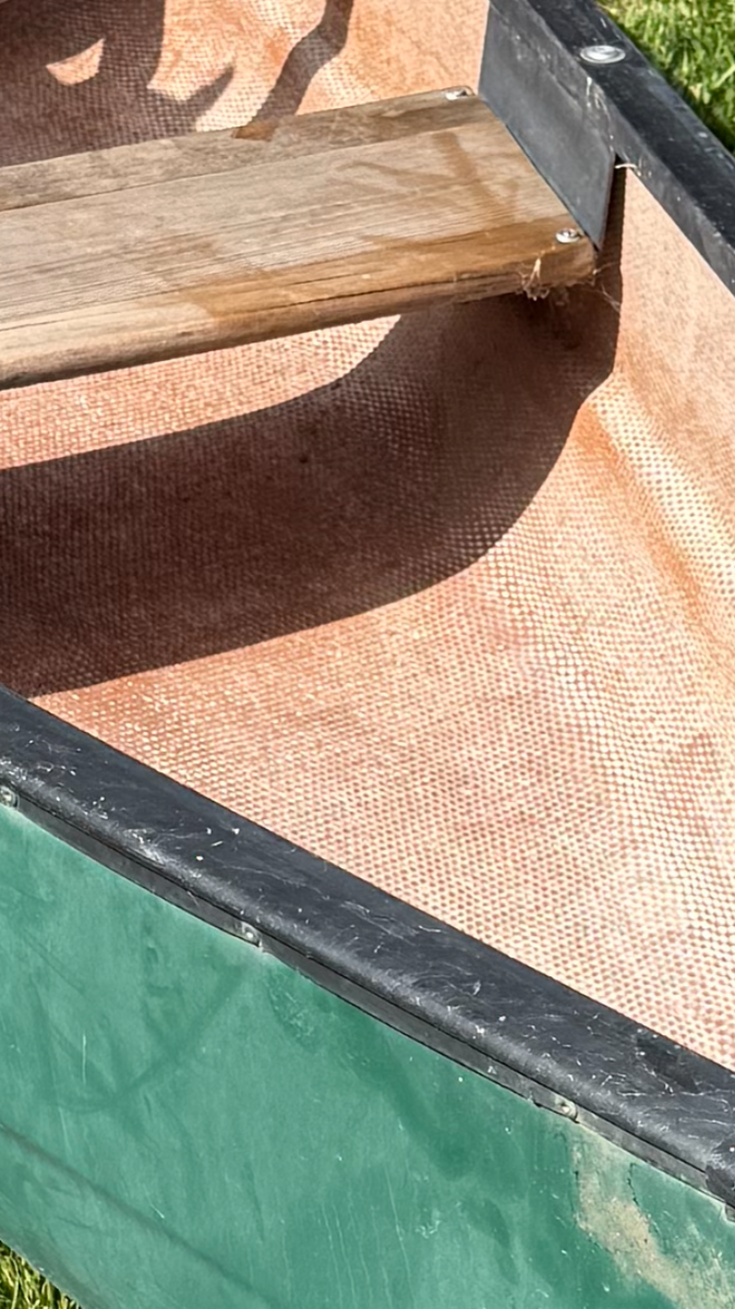

I attached a photo-not a great photo-to show the interior weave.

Interesting. That is not the typical weave I am used to from Old Town. Apparently the boats were done a bit differently than the canoes. I'm going to change my suggestion for how you deal with that based on seeing this.
I would pull the seats and power wash it. I would not sand it. I would also not put resin in there. I would probably use a good two part epoxy paint to try and seal those fibers and then call it a day.you could probably do nothing at all and use it as is as long as you don't roll around or kneel in it.
There really isn't anything unusual about the weave being visible on the inside of a fiberglass canoe. It is standard procedure as filling the weave with more resin adds excess weight to the boat as well as brittleness to the fiberglass. It also makes a pretty good non-skid surface. What is unusual in this case is the interior color. Normally, the inside of a fiberglass boat shows the exterior color, as the layup resin is clear. So, the tan color is either pigmented resin for the final layer or painted. I'd just wash it well and paint it.
