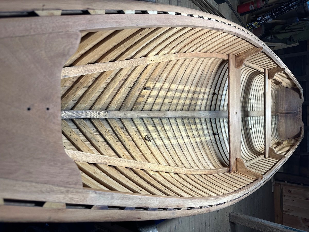

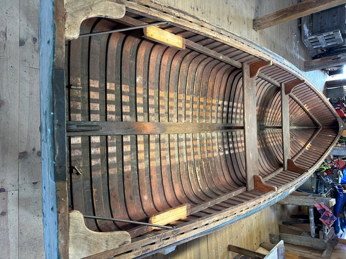

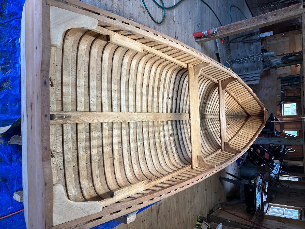

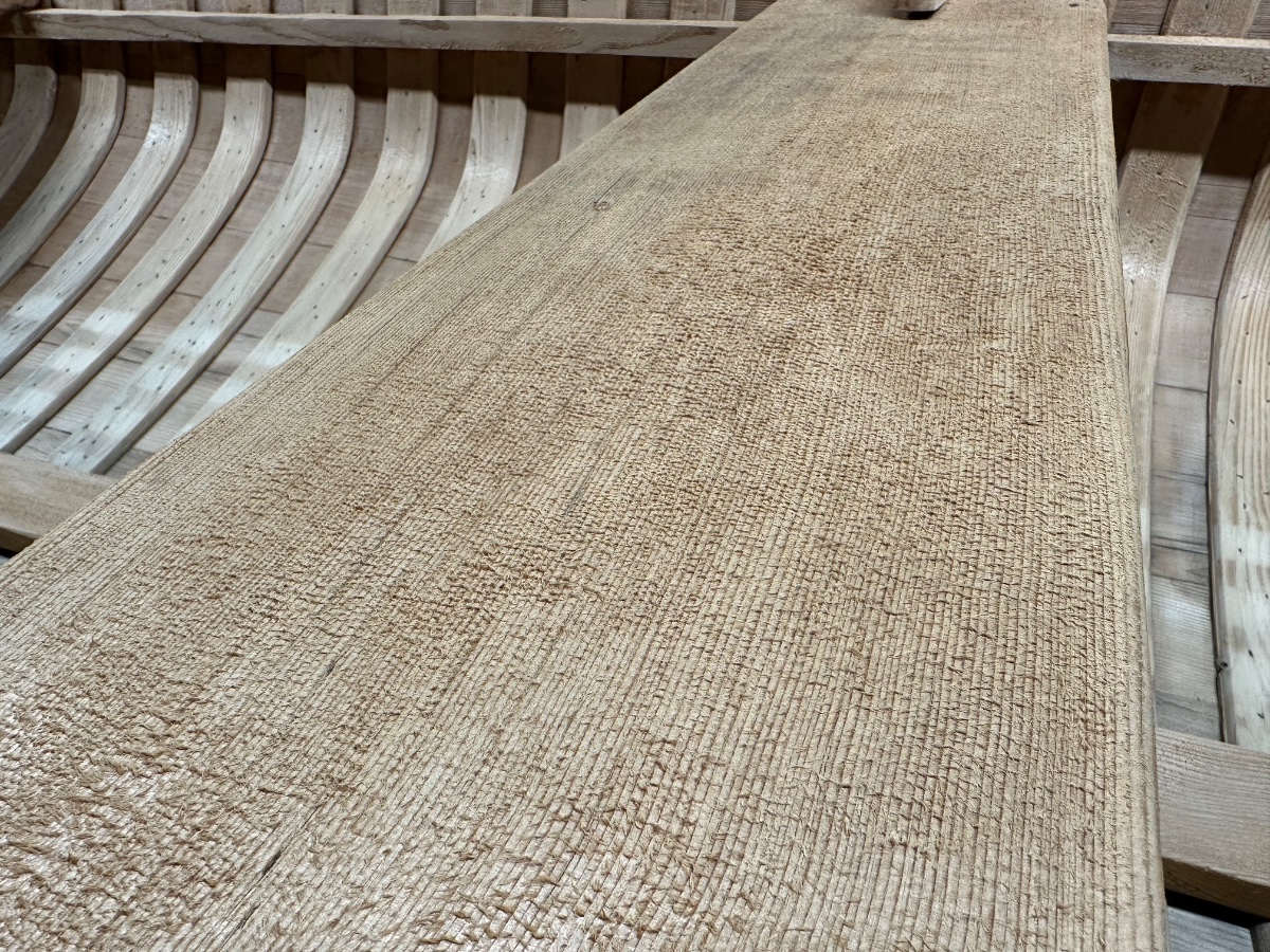

I’m slowly making progress on this boat. I’ve been picking at stripping the interior varnish all spring and summer, and finally have that done! I had to go over the whole thing twice - with the first pass it took me nearly halfway to refine my technique for the best removal. I tried CitriStrip and Klean Strip, and decided I liked how Klean Strip Premium Stripper worked a little better than the CitriStrip. I found the key to getting the gunk and residue out was using the stripper afterwash and not skimping on it! I definitely used more 3M pads, stripper and afterwash than I thought I would too. The pads gummed up pretty quick, even after scraping away the stripper residue with a plastic putty knife. If I could have dedicated a whole day to it, it probably would have been more efficient, but I had to make due with 1.5-2 hour work sessions; with setup and cleanup that meant I was only stripping 4-6 ribs on one side of the hull at a time.
Next is stripping the outside of the transom, keel, outside stem and floor rack. I figure it’s probably easier to strip the keel while it’s still on the boat and held in place.
Planking looks OK, but I discovered a few splits in bottom planks near the stern. I’ve included a couple photos. Should I replace these planks since I’m there (once the canvas comes off), or is this not a big deal if I can make sure everything is fastened tight? I recognize that replacing them comes with the challenge of trying to stain new wood to match, so I’m hoping to avoid it, but I want to do what’s best for the long term - the plan is to use the boat, not have a showpiece.
With respect to wood color, you can clearly still see where the floor rack was. I was contemplating bleaching, but am leaning away from it because I don’t want to find myself chasing it over the whole boat to keep the color consistent. Plus, when the floor rack goes back in you’ll never see it. In my opinion, the subtle color variations from aged wood gives the boat character.
Obviously, I have a lot yet to do (canvas removal and sanding) but I’m thinking ahead and I have a loaded question - what to coat the hull planking with prior to installing new canvas? I’ve read about everything from boiled linseed oil mixes to thinned varnish to deks olje. Then I met a rep from Epiphanes at the Wooden Boat show in June who suggested using their Easy Flow product as a wood treatment. Has anyone ever used that product as a wood treatment/sealer? Documentation on it says it’s a blend of natural oils, but I can’t discern exactly what. I am currently planning to finish the boat with Epiphanes varnish and yacht enamel paint. I could just go the thinned varnish route, but I was hoping to possibly find something that penetrated the wood a little better, so I’m tempted to try the Easy Flow product.

Craig, the interior looks great!
Another option (just to make your choice even harder!) is TotalBoat Wood Sealer/Varnish Primer from Jamestown Distributors. I found it very easy to work with.
Your stripping job is excellent. No need to worry about the split planks - they will be fine as long as they are well attached. You might add some tacks on either side of a split of one are very close to the split. As for the color under the floor rack, don't worry about that at all. It may be nearly impossible to make that ghost disappear and as you said, the floor rack hides it. However, consider giving the entire interior - seats, decks, gunwales - and both inside and outside the transom a treatment with a two-part teak cleaner/bleach (NOT household bleach!). This treatment will do wonders for the final appearance of the boat. Search threads here; there's a lot of discussion about these, the brands, and how to use them. Two great products are Snappy Teak-Nu and Te-Ka. Total Boat also makes one. I haven't used it but suspect it's just as good as those two.
You don't need to worry about any special pre-treatment of the wood. Epifanes varnish is an outstanding product. I've used every traditional spar varnish made by all the major companies, and Epifanes is now my first (only) choice always. Simply go by the Epifanes instructions for bare wood. Start with a coat diluted 50% with the recommended thinner, then gradually increase concentration of varnish relative to thinner until you're applying 100% varnish coats. This technique has worked perfectly on thousands of boats.
When you say that you wanted to "find something that penetrated the wood a little better", what does this mean? If you don't know how well any of these products "penetrates" the wood, then how to find one product that's better than another? Is there some kind of magic to "wood sealers"? I don't know, and none of the makers of these products won't say what exactly they are. They promote all sorts of benefits of these sealers, even without information to back ups the claims (I'm not knocking them; just wish we could make truly informed decisions). TotalBoat, as one example, promotes cost savings by using wood sealer because it "saves expensive varnish for the finish coats." Their sealer product costs $37.99 on their site, and they say you should use 2-3 coats. Their Gleam spar varnish is not much more at $47.99. A simple calculation shows that 3 coats of the sealer costs 14% more than 3 coats of their varnish thinned at 50%, 70% and 90% (90% varnish / 10% thinner). That's not counting the cost of thinner, but it's probably a break-even proposition altogether.
[Disclaimer - I like TotalBoat products, and they aren't the only company promoting mystery sealers.]

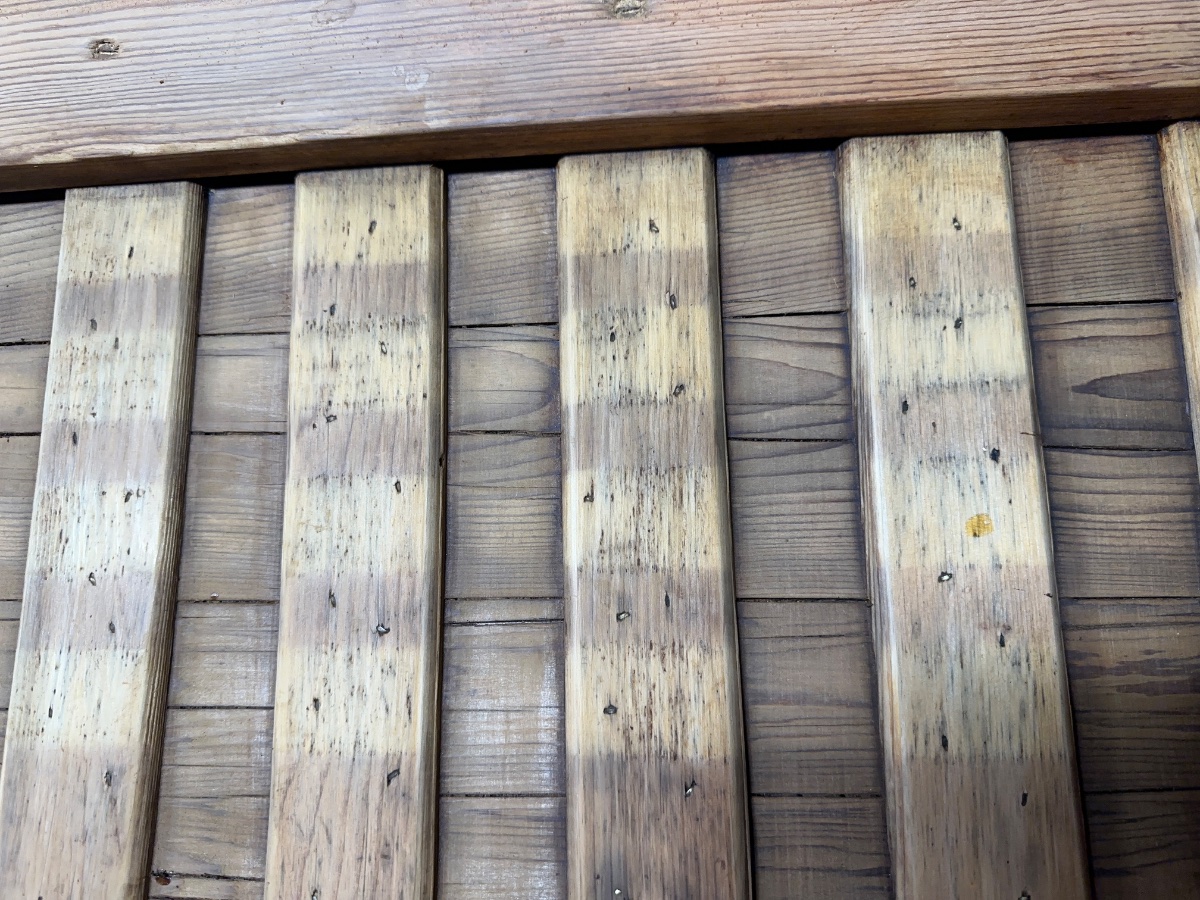

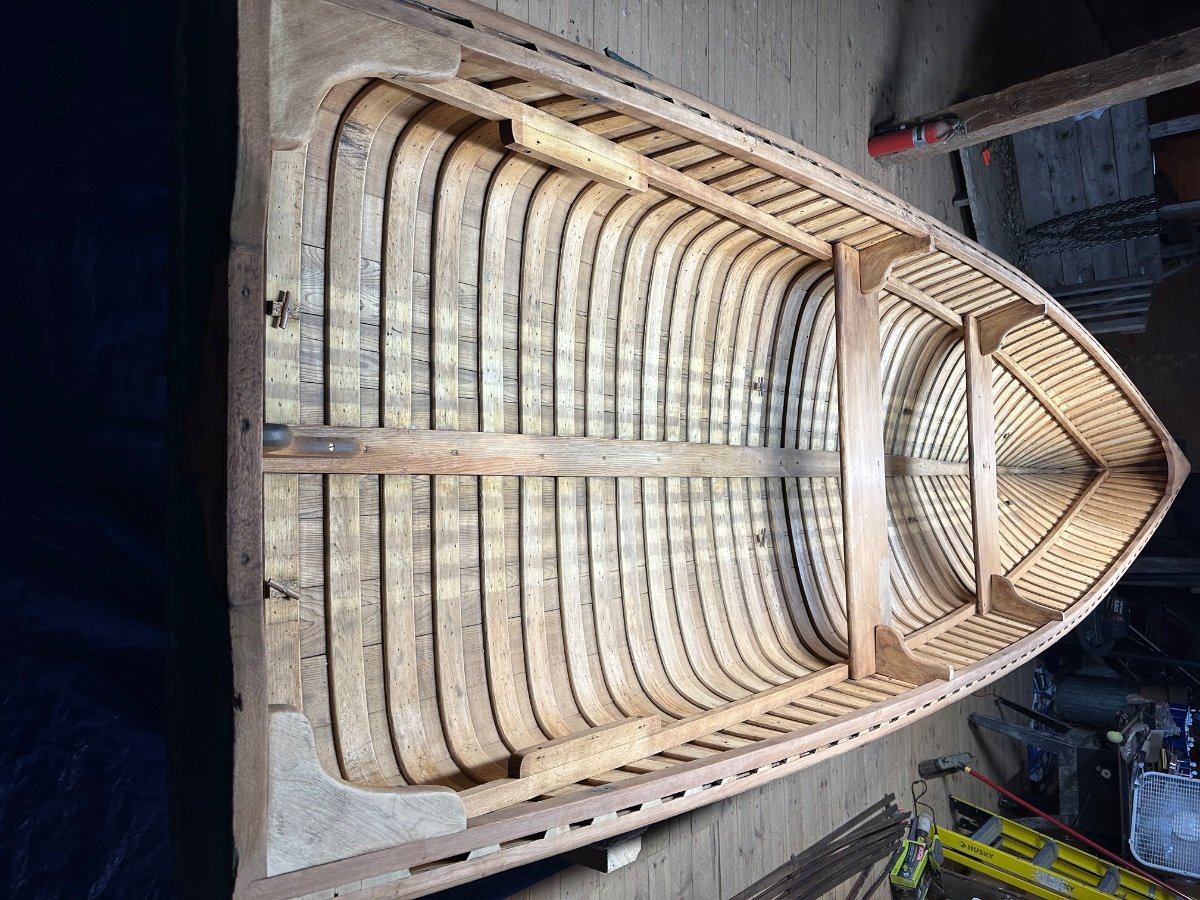

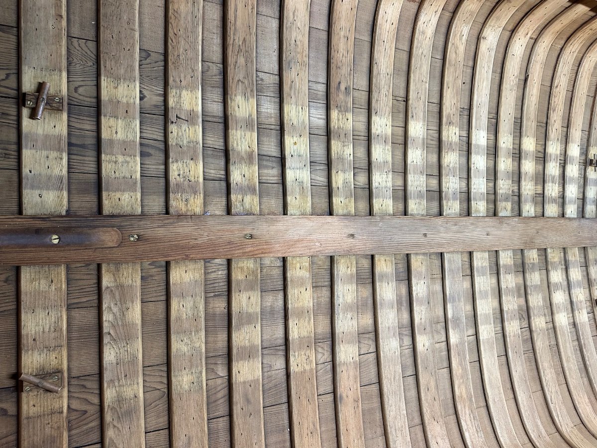

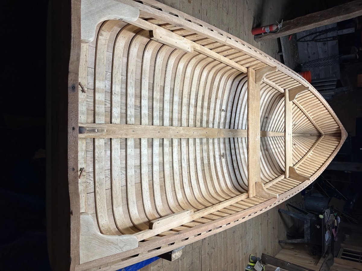

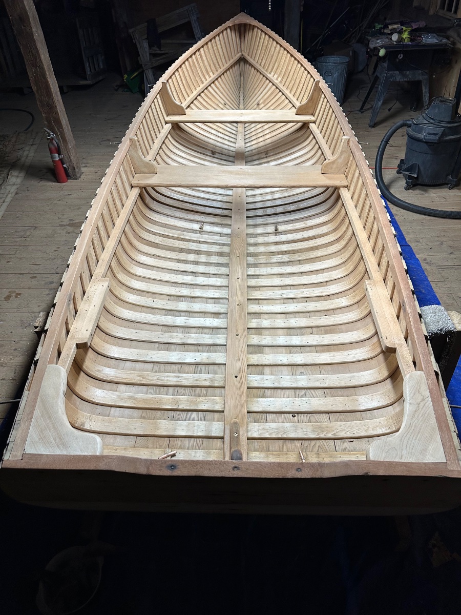

Based on the recommendation, I used the Snappy Teak Nu two part teak cleaner on the whole interior, transom and gunwales (basically all wood that will be varnished). It was an exercise that again took a bit more time than I thought, working in sections. I still have a couple spots to get a little better (especially in the tight area of the bow beneath the deck), but I’m generally pleased with the results, especially on the mahogany and cedar. I’m a little less impressed with the outcome on the spruce components, which ended up with very raised fuzzy grain that will take a little more to sand away. I used the cleaner full strength rather than diluting it. For whatever reason, I found I used more of the part 2 liquid than the part 1 in trying to achieve a uniform brighter color after part 1 made everything dark.
I thought leaving the canvas in place would be good to prevent the chemical cleaner from dripping through, but that ended up not working so well because you have to keep the wood wet and I ended up with water pooling in the boat so the cleaner got diluted and couldn’t do its job well near the centerline where the water accumulated. So, I ended up cutting the canvas and peeling it back to allow water to drip out through the gaps in the planking. The keel and outwales are still in place, so the canvas is currently hanging down with flaps on each side, held by the keel.
The series of photos shows before stripping, after stripping, and then after cleaning with Snappy Teak Nu. No question the cleaner brightened things up and made the wood more uniform in color. You can still see where the floor rack was, but it is much less pronounced. I also added a photo of a spruce seat showing the resulting raised fuzzy grain.
As I work through each step in the process of bringing this boat back to life, I gain confidence that I can see this through and quite possibly achieve even better results (more beautiful outcome) than I thought I could do as an “amateur.” My 6 and 8 year old sons are already very eager to get out on the water in this boat - they regularly ask when it’s going to be ready. I tell them, hopefully before the end of next summer if everything goes well!

Nice looking boat. After a thorough sanding, the uniform, pale blond color of everything is going to really pop when you apply the first coat of thinned varnish, and then it will just get more and more beautiful with each subsequent coat. Snappy (and similar products) do fuzz up spruce, and sanding does only a mediocre job of taming the fuzz. Just apply your first coat or two of varnish, then go back and sand the spruce thoroughly. Cured varnish solidifies the fibers on the surface of the spruce, and they then sand down perfectly. You'll be very pleased with how well this works, and with the beautiful patina of your vanished wood - cedar (red and white), spruce, and mahogany.

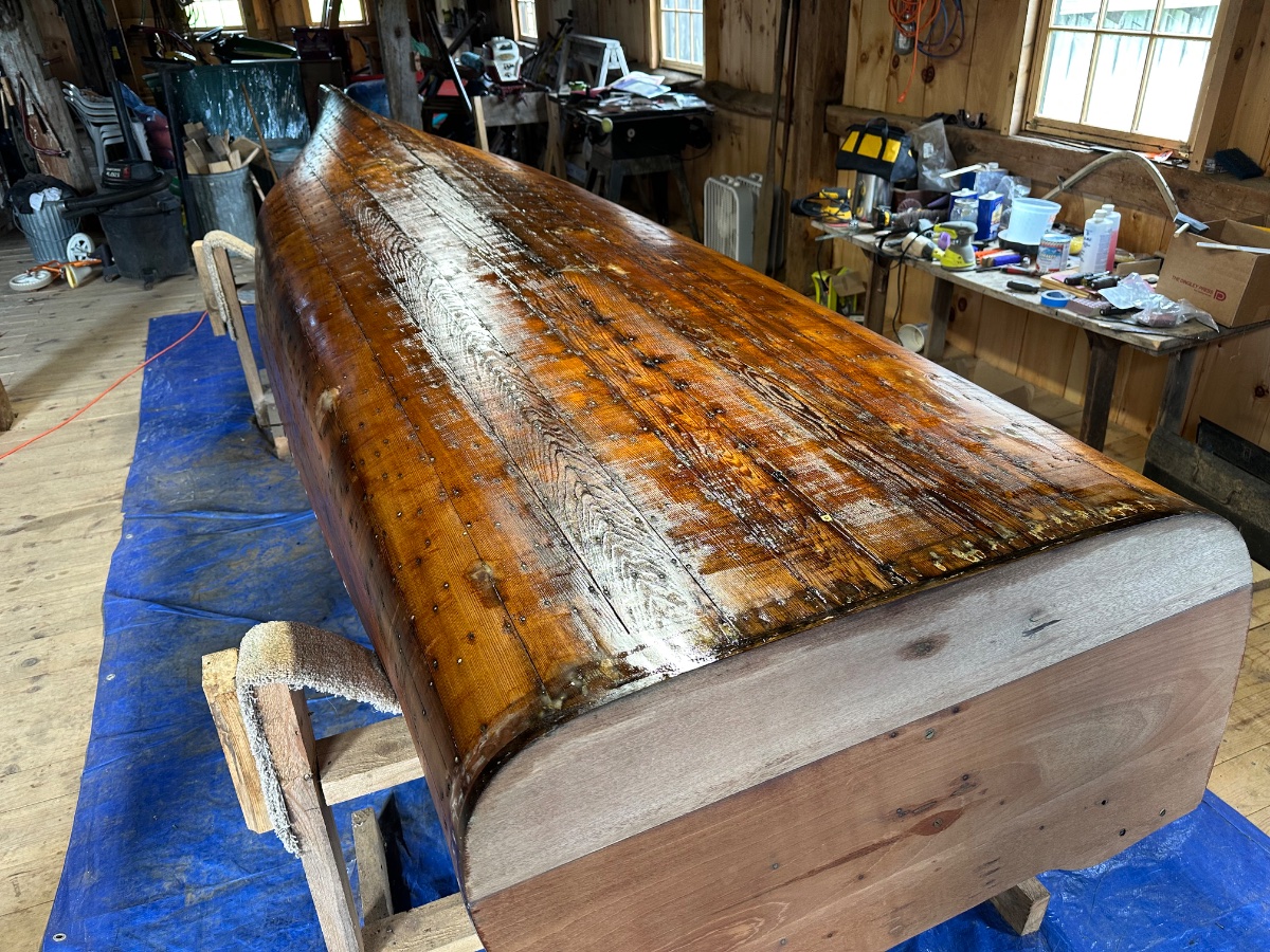

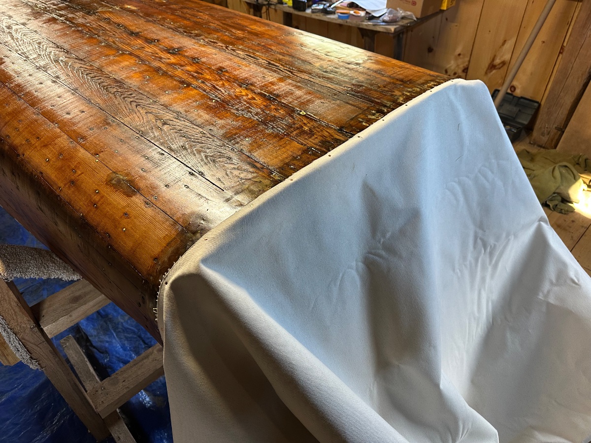

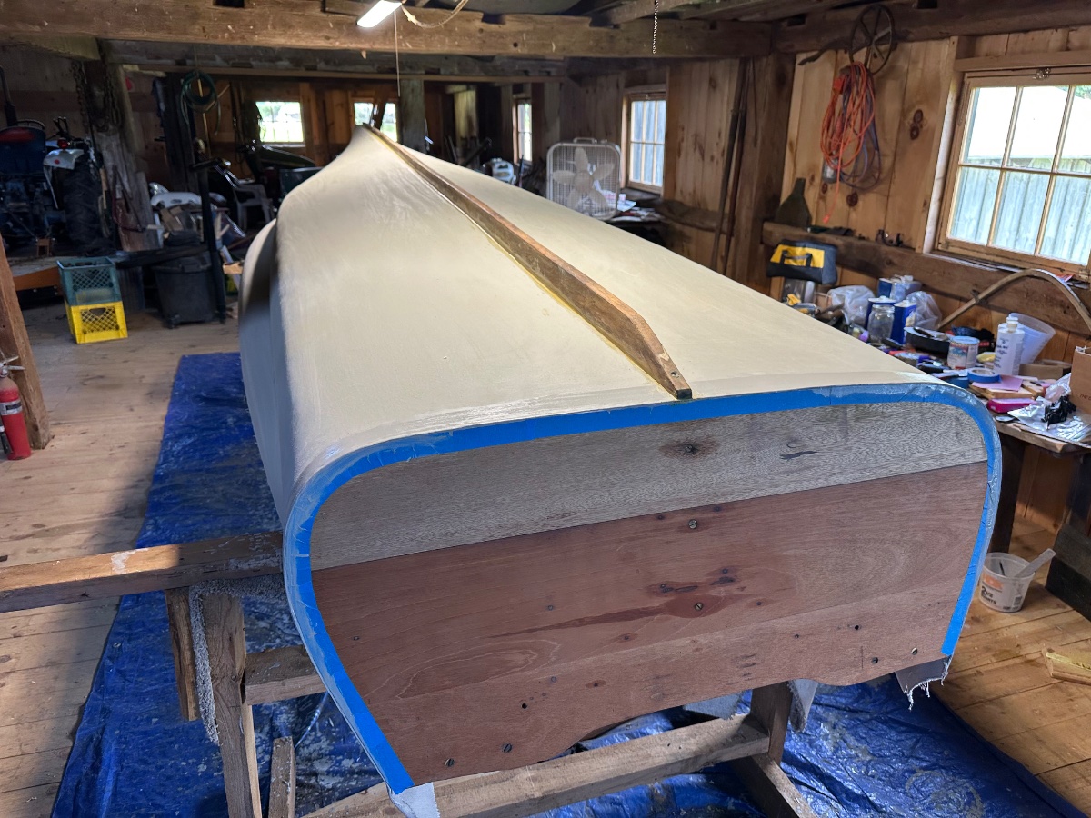

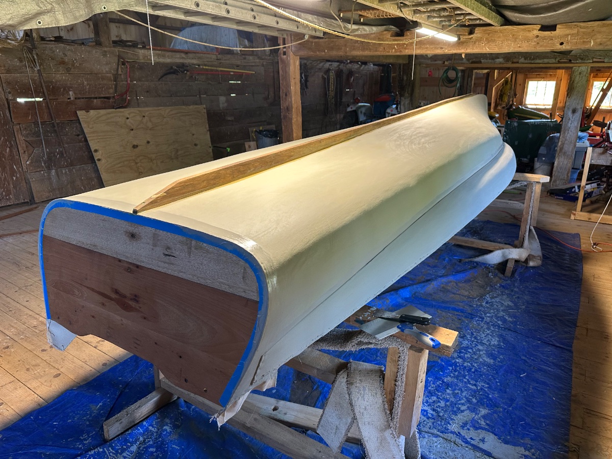

I got everything sanded over the winter and the weather finally got warm enough to be confident in good drying when coating the exterior of the planking. I went with varnish for the exterior to put a layer of protection on the planking. I purchased canvas, tacks, filler and bedding compound from Northwoods canoe. I decided to follow Rollin’s recommendation of the fold over approach to attaching the canvas at the transom, rather than the tuck method. It seemed to work well. Now I just need to set up a rig to stretch the canvas so I can get it tacked at the rib tops. Stretching will make the ripples/bubbles in the canvas by the transom disappear, as a gentle hand pull gets it smooth and tight on the hull.

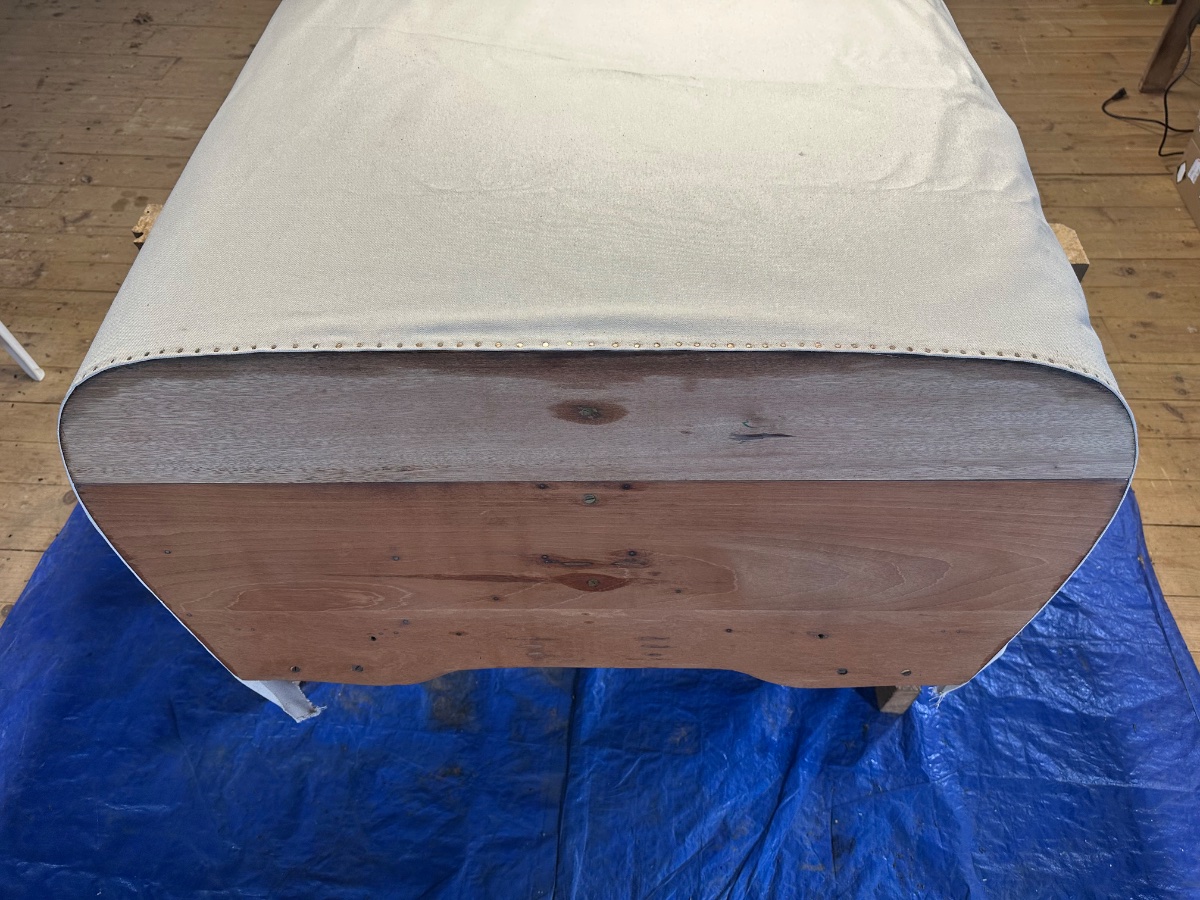

I’m thinking of filling the hull canvas and then attaching the sponson canvas and sponsons after, then filling the sponson canvas. That looked like how it was originally done. Does it make more sense to attach the sponsons first and then fill instead? Does it matter? I was thinking filled canvas behind the sponsons adds a layer of waterproofing, but if the joint between the hull and sponson is well sealed/filled, maybe it doesn’t matter.
I’ve included some progress photos.

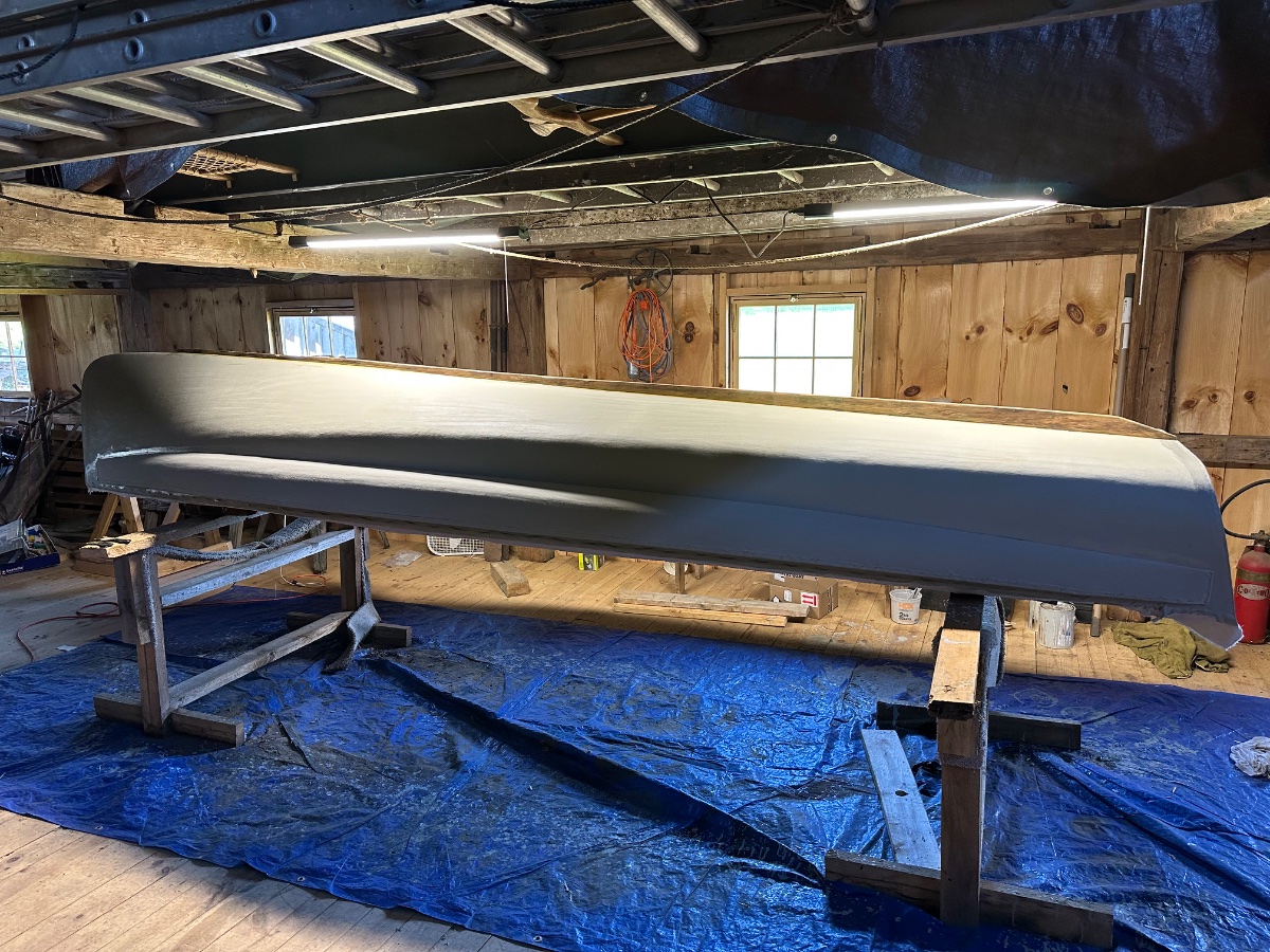

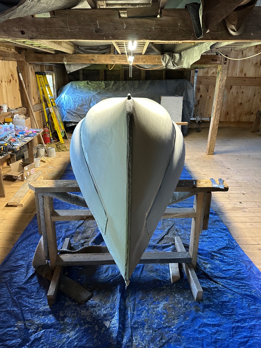

I always canvas the hull, then pull more canvas along the sheer, put on the sponsons, then wrap them in that second canvas (I believe this is the way it's described in The Wood & Canvas Canoe). Then I fill everything at once. Some people worry about water getting in behind the sponsons but (1) this is the method that's apparent on original sponson canoes I've torn down, and (2) I've re-canvassed a good many sponson canoes and this method passes the tests of time and use. Just be sure to really work the filler into the junction of the canoe and sponson. Just like everywhere else on the canoe, the filler, fills, levels and (along with paint) waterproofs.
I finished stretching the untreated 6ft wide canvas on the hull, applied Coppercoat to it as a treatment (copper napthanate), attached the sponsons and stretched treated canvas around them (it was a 17ft long by 5ft wide piece that I cut in half to have 2.5ftx17ft pieces), and filled the canvas with traditional filler. A few days later I bedded and attached the keel. I haven’t bedded and attached the wood outside stem yet. In about 3 weeks I’ll be able to continue with light sanding of the filler, then prime and paint. It’s coming together! The end is in sight, but the finishing work will be tedious to get it really nice. After a primer coat, I’ll be using Epifanes yacht enamel in dark green on the hull exterior, and Epifanes varnish on the interior.

I added some additional filler there after it had set up a little more to try to cover the nail heads better. It was tricky to get satisfactory cover with the coat thickness for a fair surface.

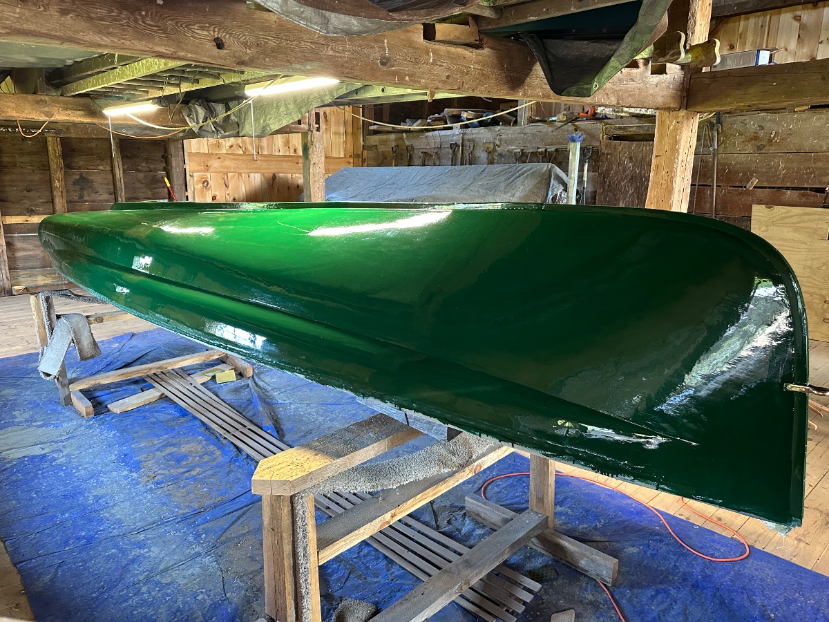

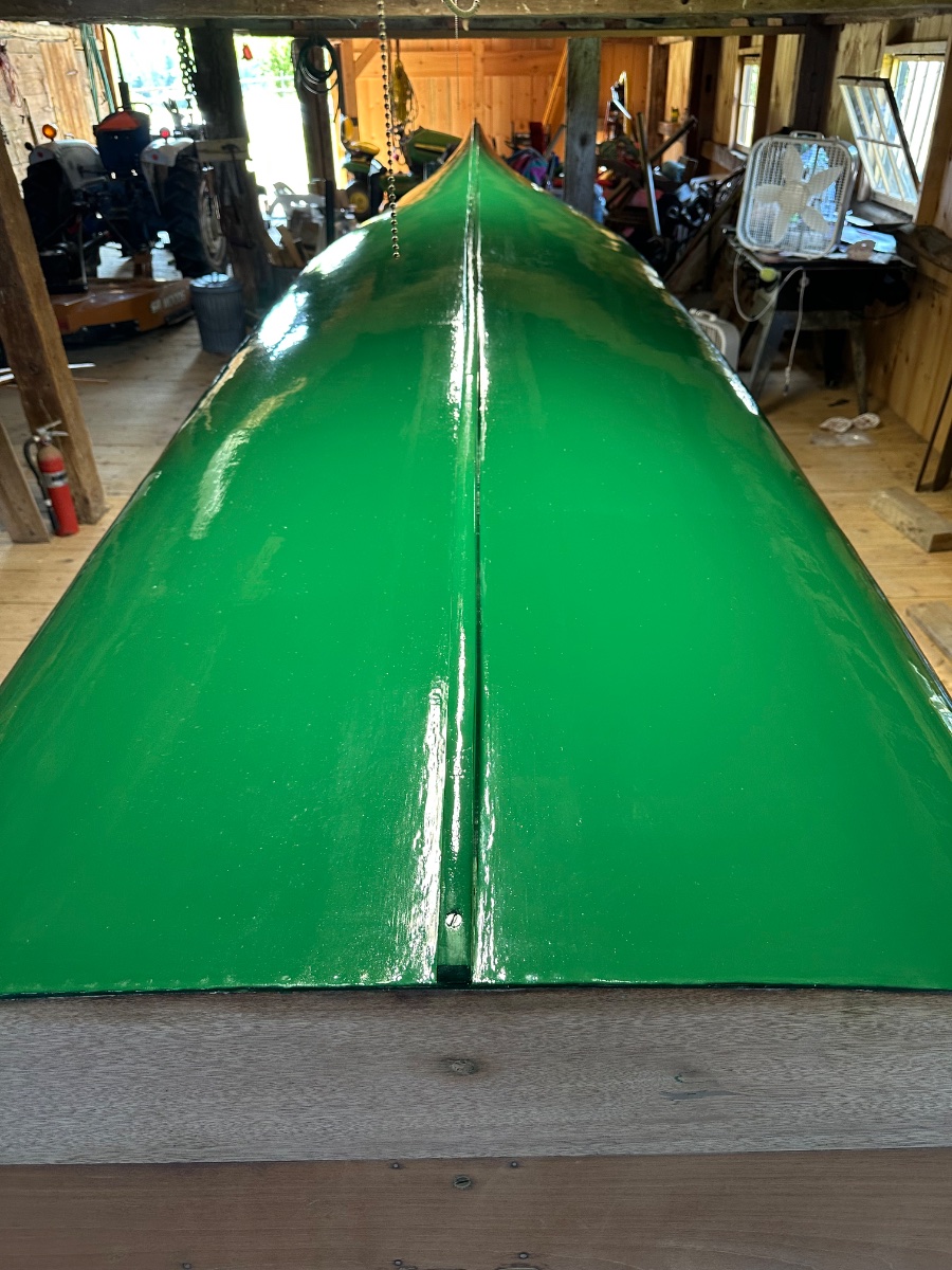

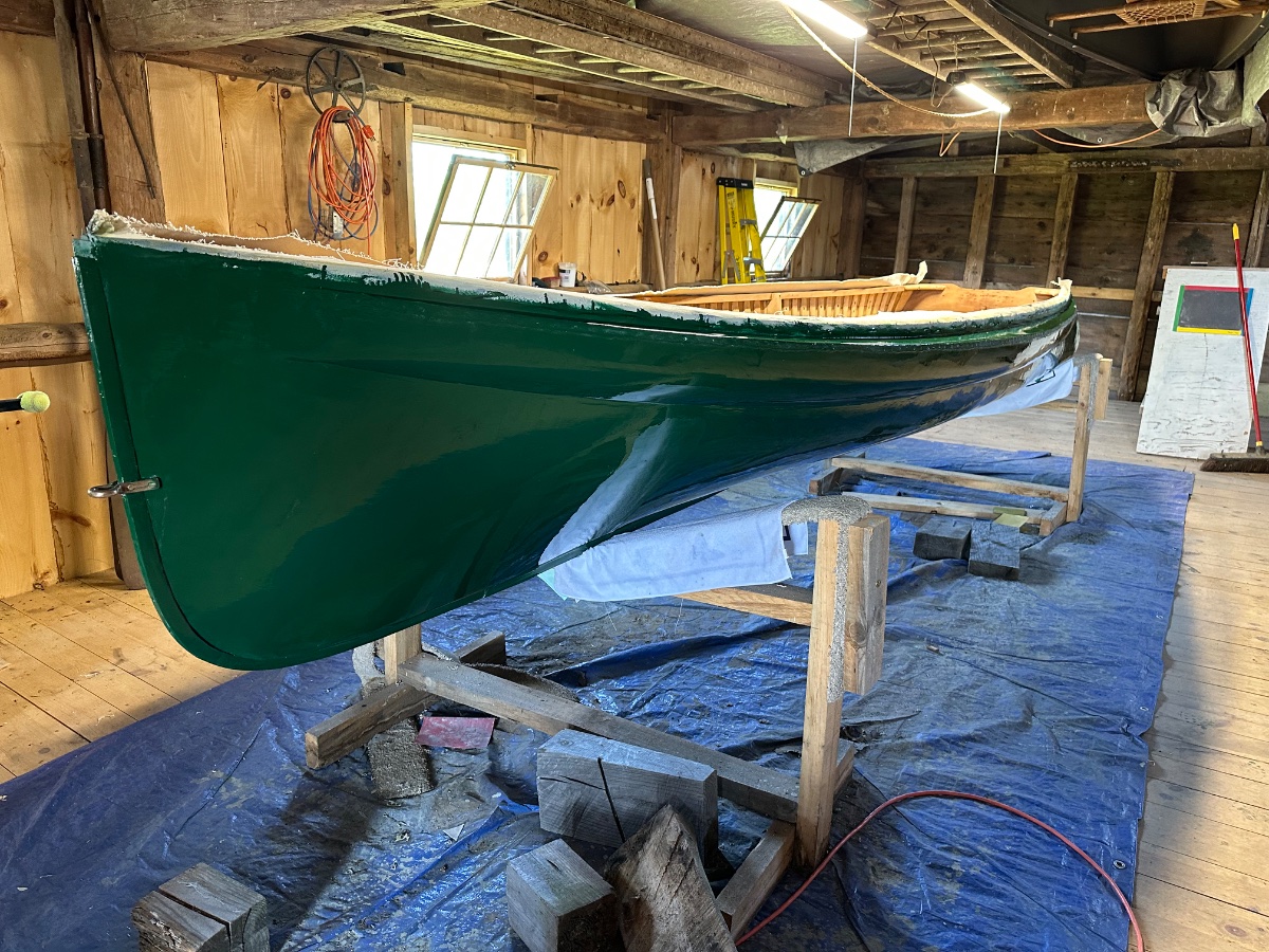

The boat is painted! I used two coats of Epifanes multi marine primer and then 3 coats of Epifanes yacht enamel in dark green (color 72). I used a 6” foam roller and tipped with a quality brush. It isn’t perfect, but you have to look carefully to spot the imperfections. The combination of lighting and camera in the attached photos doesn’t really do it justice. Overall I’m very pleased with the result. Another coat or two of paint with sanding would make more imperfections disappear, but I decided the additional expense in paint and time wasn’t worth it because the boat is going to get used and between me and the three kids (mainly the kids), it’s going to get scuffed anyway.
Now it’s time to trim the canvas to the edge of the planking and complete outwale installation and interior varnish!

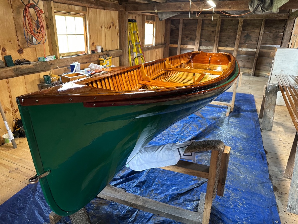

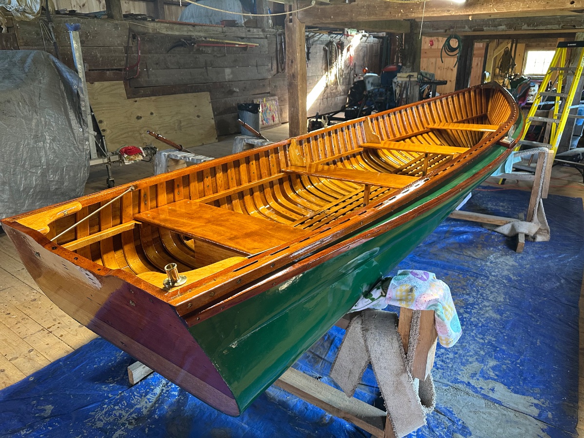

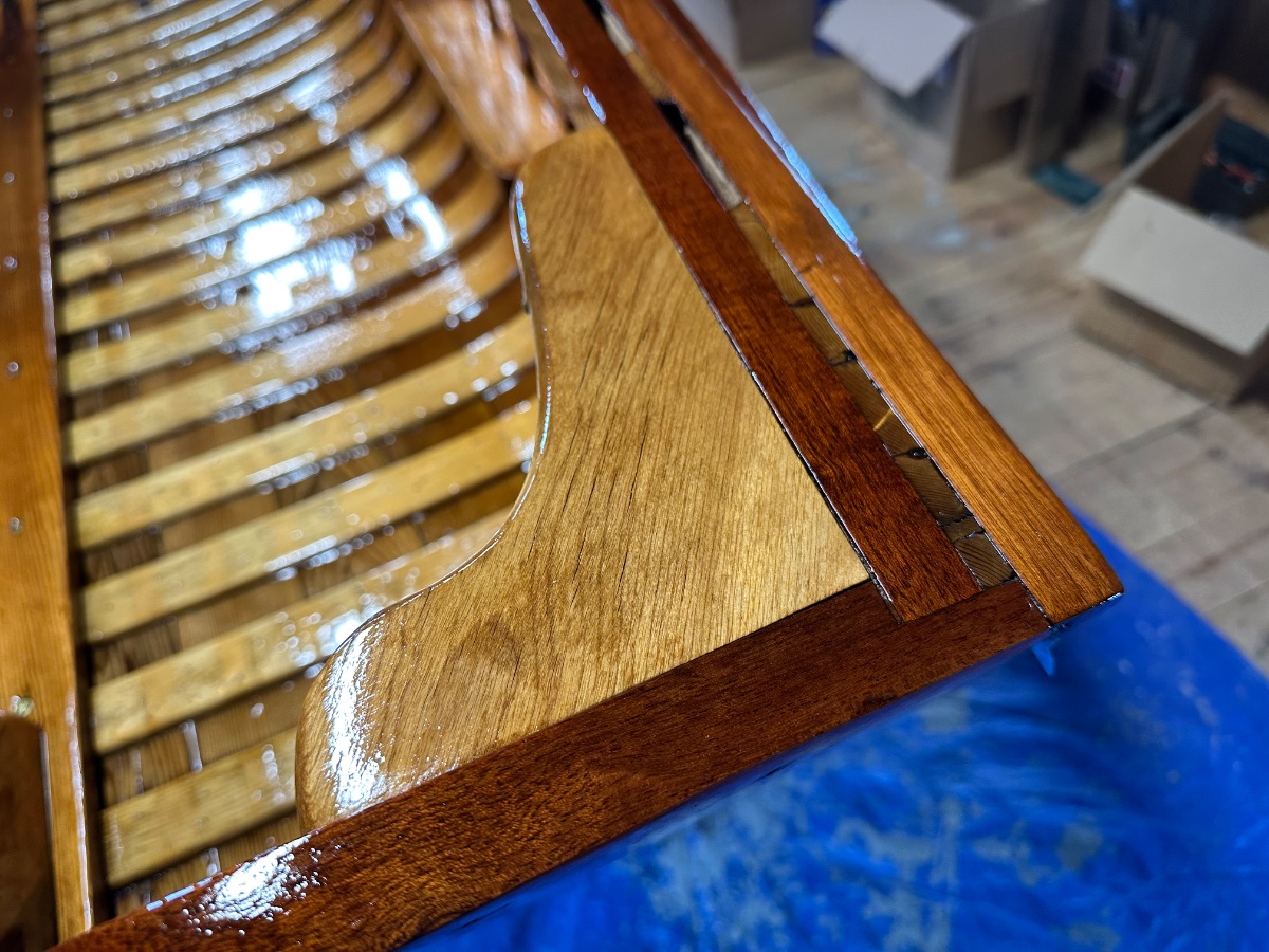

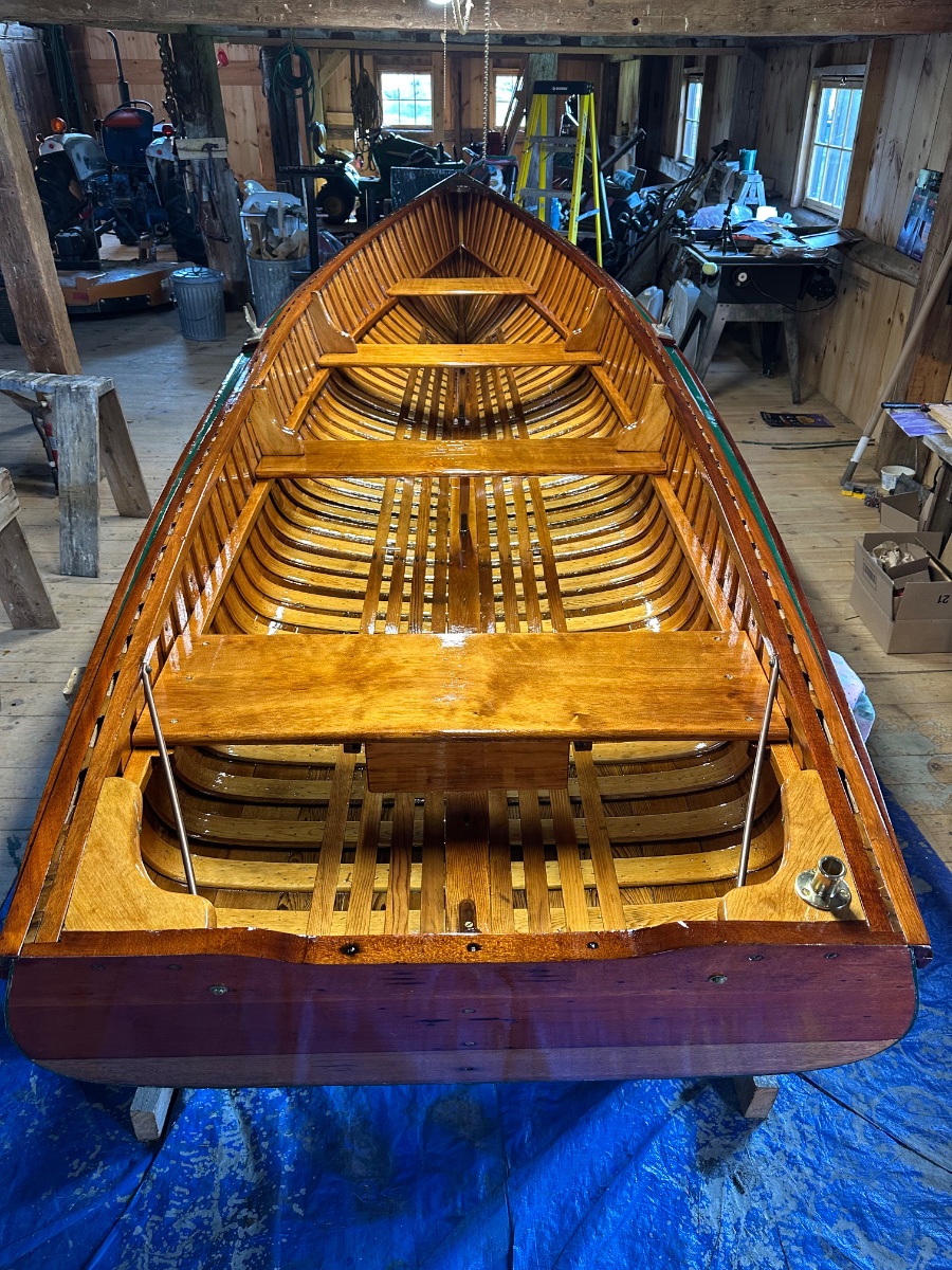

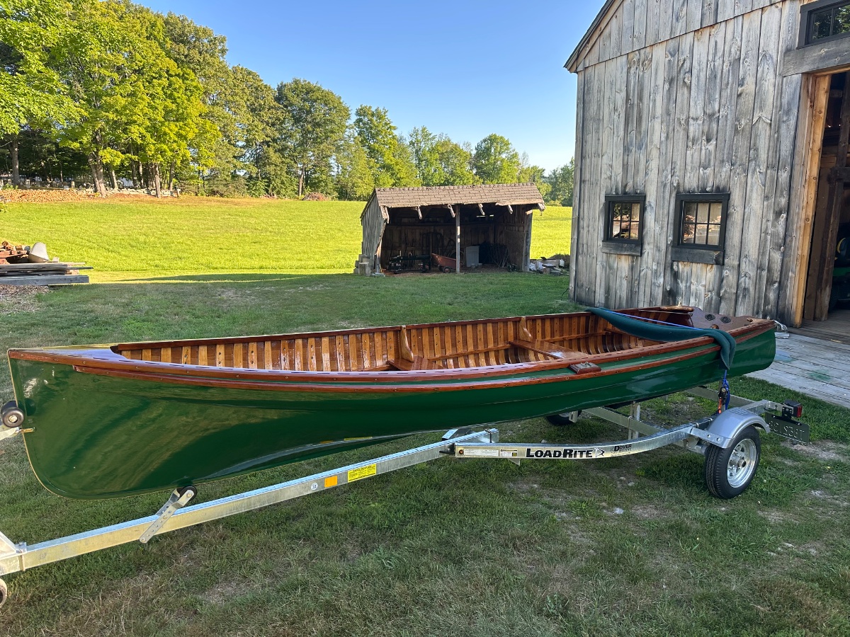

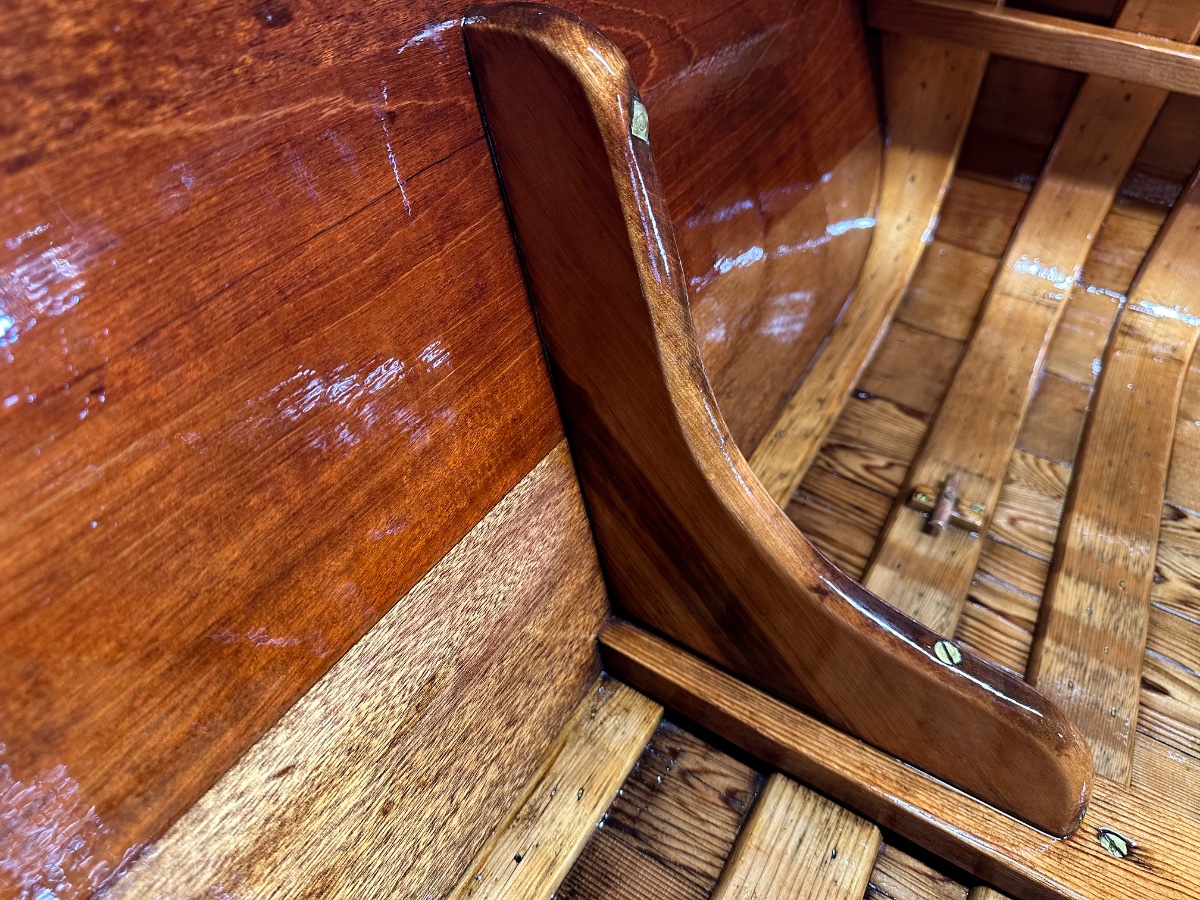

It’s finished! The interior received 6 coats of Epifanes RapidClear with sanding after the third and sixth coat, followed by two coats of Epifanes clear gloss varnish with sanding between each. The RapidClear was nice for building up the coating on the wood while saving on sanding labor, but the semigloss appearance of the finish is no substitute for the clear varnish.
It’s not perfect, but as an amateur doing this for the first time, I’m very pleased with the result! I’m the only one who will really notice the imperfections, and normal wear and tear will occur as we use the boat anyway. At any rate, I now have a very attractive and functional boat! We water tested it and observed no leaks, and she glides through the water under oars beautifully. Maintaining 3mph into the wind was easy. It was harder to stay on course going across the wind or downwind. Seems the windage of the hull is a noticeable factor. I look forward to getting the 1957 Johnson 5.5hp motor running right. Until then, I have a 1979 2hp Evinrude that runs well and I can use!
Many thanks to all who followed the project and provided advice and insights along the way! It’s very much appreciated. I don’t think I would have been able to achieve this level of success without this forum and community!
