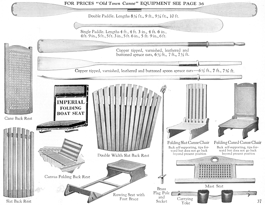

The canoe has a cane seat that I don't believe is original. (The canoe might have had cane seats, but I dont believe the frame is original -- it looks to be after market.) The other seat, I believe is an original frame, but the caning? was replaced with metal straping which was then covered by canvas. Is there a way to determine what type of seats the canoe had originally and is there a resource for a correct replacement?

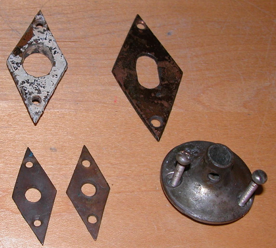

Lastly, the stern deck has a decorative? diamond shaped plate around what I believe might have been an eye-bolt hole in the center of the deck. What is the hole, and what original hardware might have been there?

The original seats would have been hand caned with a pattern similar to the ones shown at http://www.wcha.org/catalogs/old-town/specific.gif and http://forums.wcha.org/attachment.php?attachmentid=36 from an Old Town catalog. Diamond headed bolts like the ones at http://www.wooden-canoes.com/images/filler/oldtownbolts.jpg started to appear on Old Town canoes around 1920 so it is possible that they may have been used originally on your canoe. Ordinary carriage bolts like the ones at http://www.wooden-canoes.com/images/filler/carriage.jpg countersunk with wooden plugs may also have been used. Square nuts were typical in this era so any bolt with a hexagonal nut is probably not original. Correct replacements are available from Old Town as listed at http://oldtown.wcha.org/parts.html here, the Northwoods Canoe Company at http://www.wooden-canoes.com/material.htm and many other suppliers. Diamond shaped plates on the decks were most commonly used to reinforce flag pole socket holes as shown at http://forums.wcha.org/attachment.php?attachmentid=3942&d=1200017914 and http://forums.wcha.org/attachment.php?attachmentid=23&d=1100196086 here.
