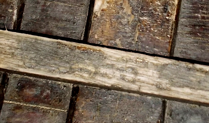

Got back to the canoe for more pictures. There are numbers stamped on the stem foot which look like 9375. If an Old Town then that puts the build around 1926-1929 according to a chart on WCHA. Anyone have the CD to see if this is a match. The length is 19' 9" and has a floor protector.
The Old Town canoe with serial number 9375 is 16 feet long and shipped in 1909 so that probably isn't this one. The only twenty foot long canoe in the 9375x series is number 93756 which shipped to Greenville, Maine in 1927 without a keel or a floor rack. Some of the tips at http://forums.wcha.org/showthread.php?791 may help you discover the correct numbers. Good luck,
Benson, thank you. I'll go back out to the canoe with a flashlight and get a better view.
Can you attach the photos of the numbers from each end? The Old Town with serial number 9875 is 17 feet long so that probably isn't the correct record. The Carletons with numbers 9375 and 9875 are 18 and 15 feet long respectively so they don't match either. The Old Towns with numbers 98754 and 98755 were both 20 feet long. The first one was CS grade with bilge keels and the second was AA grade with lots of mahogany and a floor rack. Are there any signs of extra keels or mahogany on this canoe? Additional pictures might really help in this case.

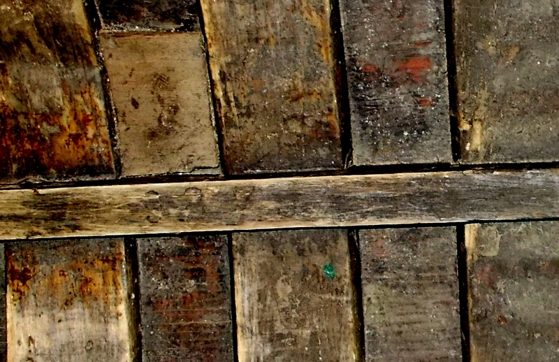

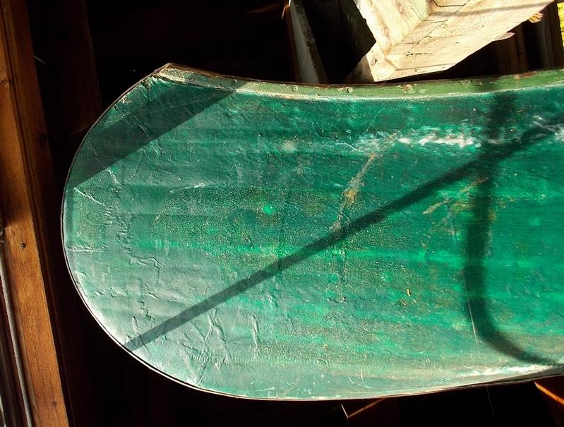

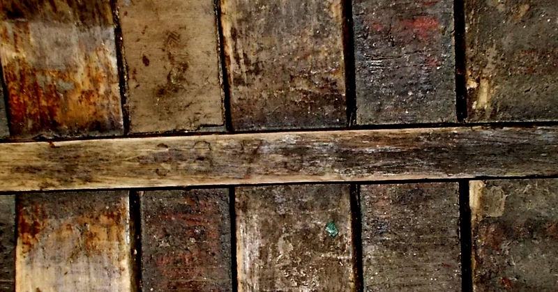

When I first went out there I only found numbers on one end.
I’ll post pictures of the numbers, seat attachment and thwarts.
I went out there yesterday with a flashlight and got a good look at the numbers and could not find a trace of a digit on either side of the 9875.
There were no bilge keels but the canoe has been classed over and they may have been removed.
Given the money and family the AA grade makes sense
I’ll go back out there today and go over it again.

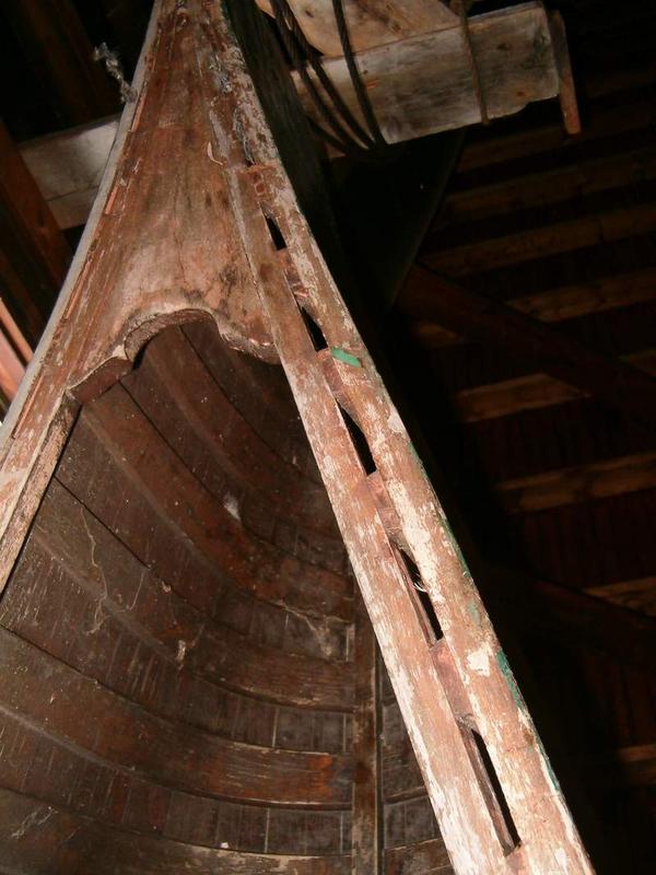

Benson,
Glad you mentioned looking at the other stem which I did today…(another hike in so getting my exercise). The picture shows the missing trailing 5. I cleaned off parts of the deck and gunwale and they are mahogany.
