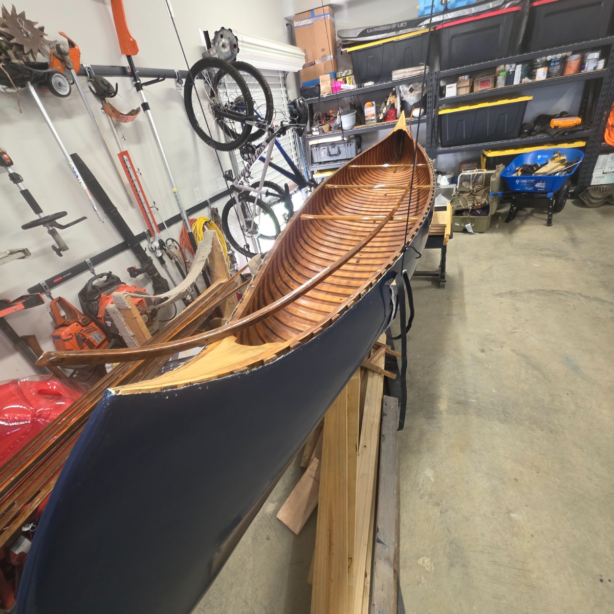

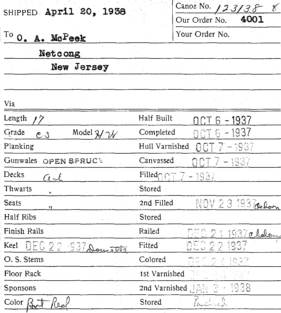

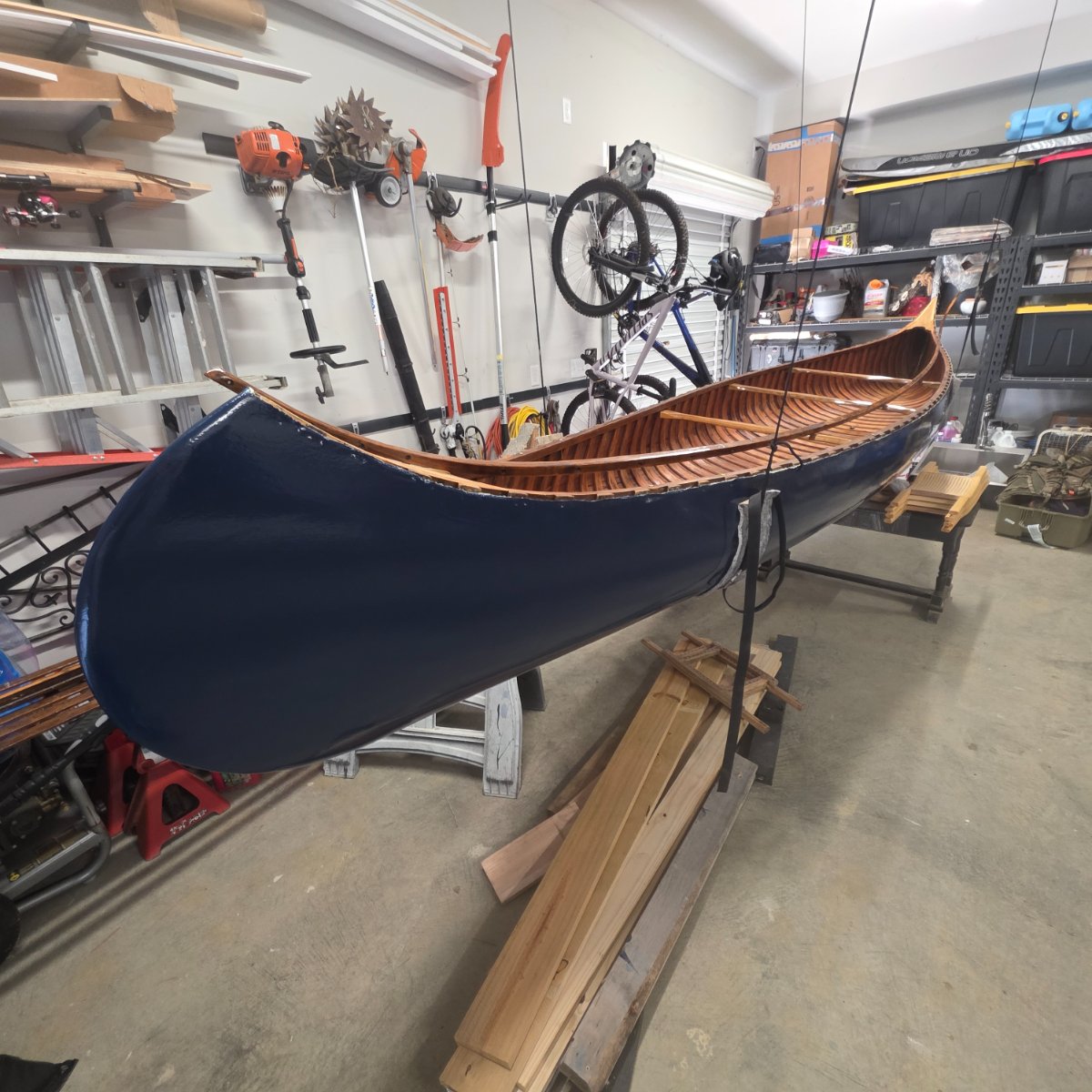

Update... I found the build sheet. OT 123138 17 is a 17ft H.W. finished in CS and colored Burnt Red. It is now recanvased with repaired stems and gunwales, cane seats (+2 for the littles) and finished in Kirby Flag Blue. Varnish should cure in time for autumn paddling. If you've any more info I'd love to have it.

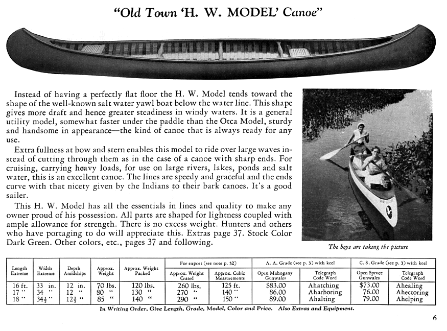

This build record is attached below in case anyone else is curious, along with the 1938 catalog page for this model. I think that the original color was probably bright red. Nice project,
