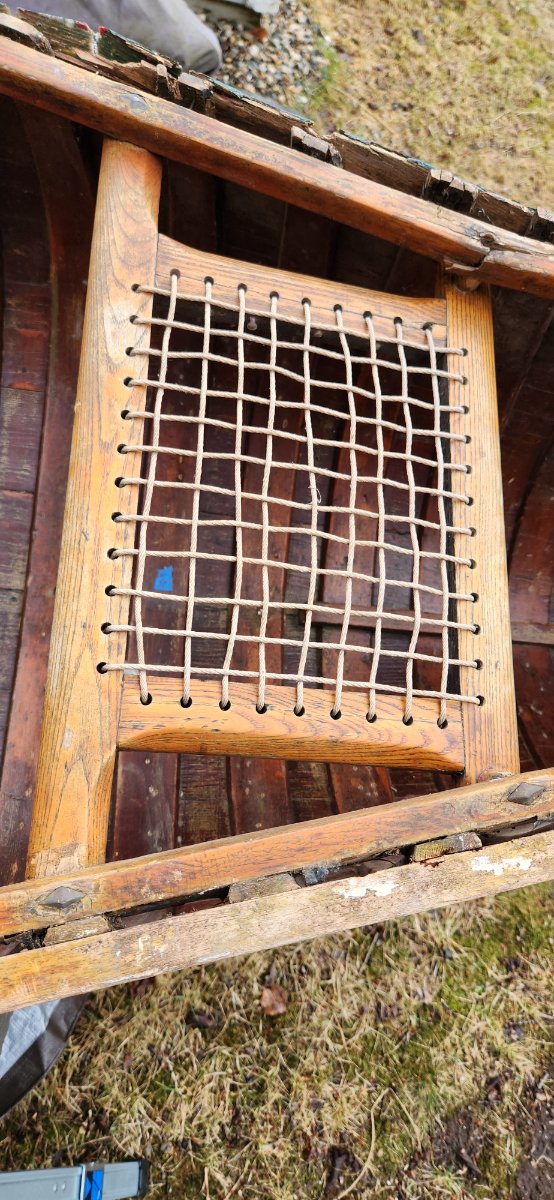

On a drive home from Northern Maine a few months later, I swung by Island Falls Canoe in Atkinson where I met Jerry Stelmok and received my order and his helpful advice. Caning the seats looked beyond what I could tackle. I sent the refinished frames to Dennis King at Maine Caning in Orono, who did a great job.

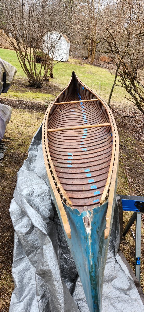

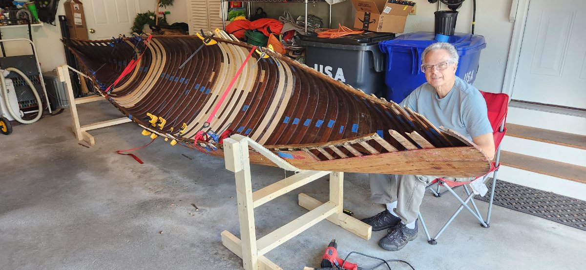

I stripped off the fiberglass and began woodwork in Summer 2025 at the fist-sized hole through the planking and rib near the stern seat. I soon discovered cracked ribs and weak planks. I replaced 12½ ribs and over 50 feet of planking by the end.
In time it became clear that dozens of the rib tips were in no condition to hold new fasteners, so I had to scarf or repair all the remaining originals. The original birch thwarts were decent. I repaired the ends and cut thin brass plates, modeled after the V-plates Old Town once used, to help the thwart bolts handle strain and serve as integrated washers. One of the original red brass diamond head bolts was missing, so I replaced it with a replica yellow brass one. The other bolts and nuts cleaned up well after soaking for a week in ketchup.

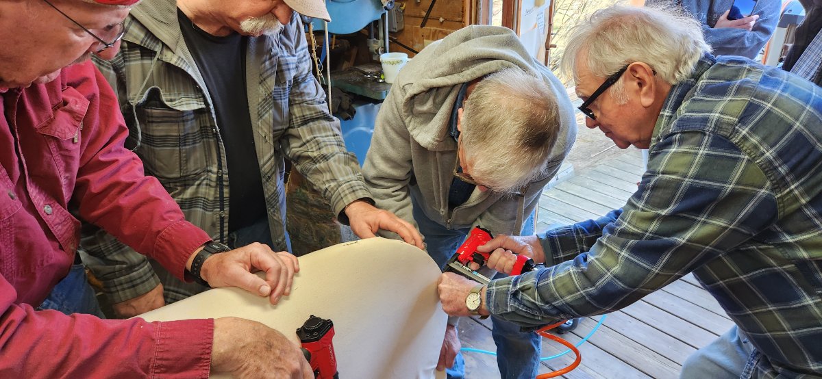

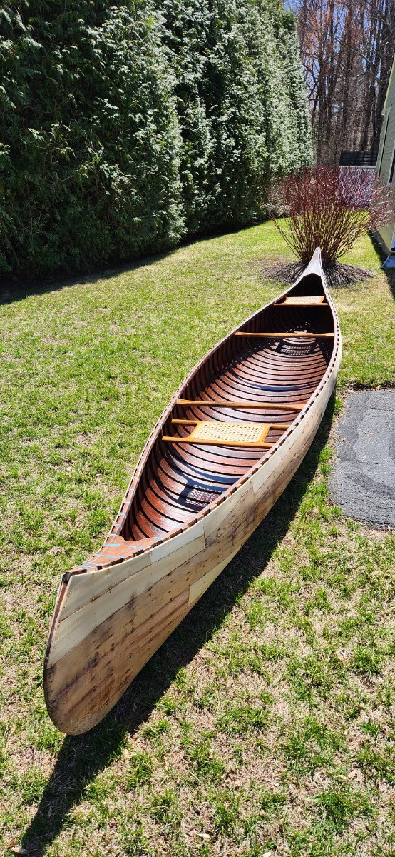

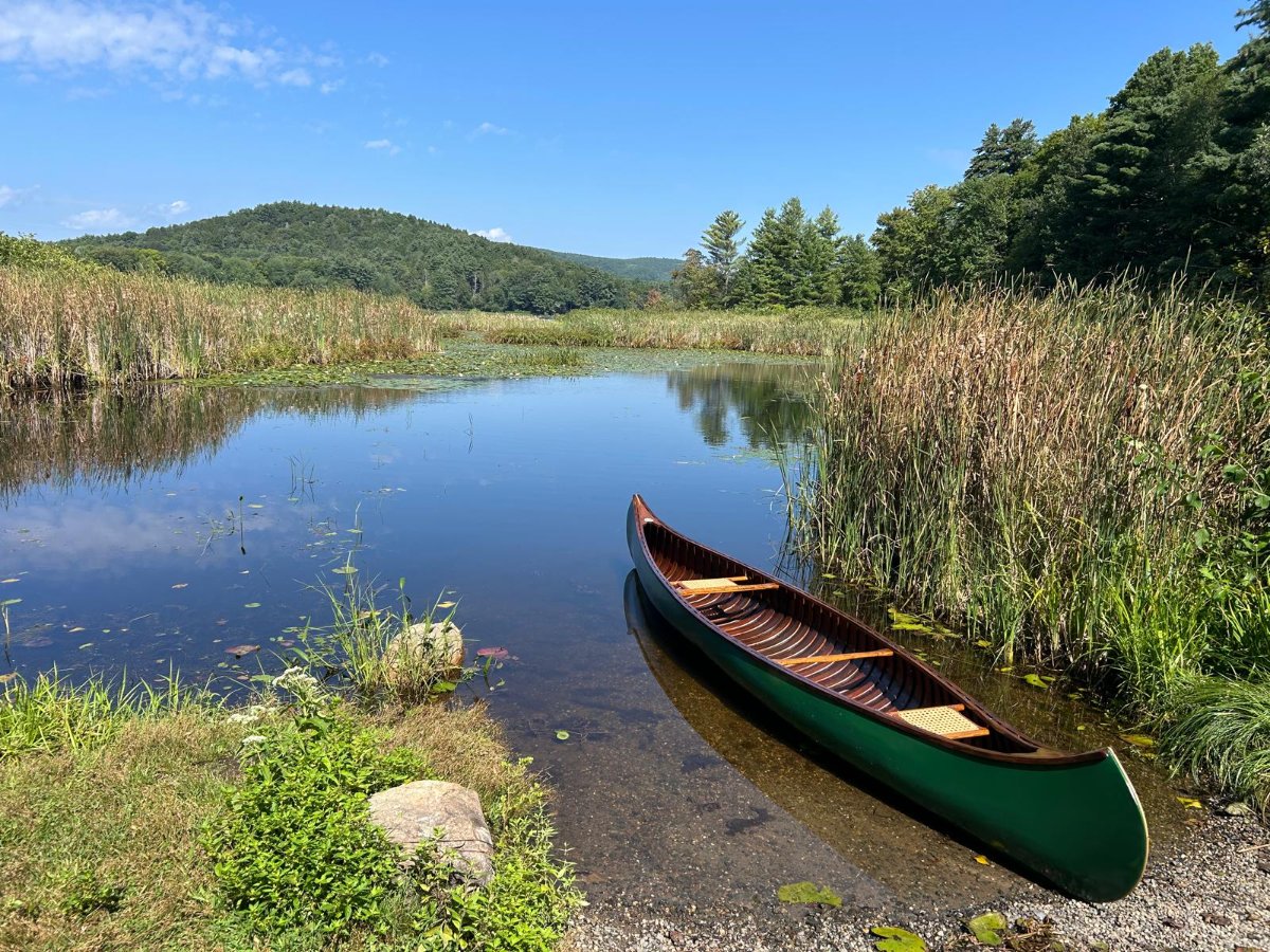

Originally I supposed that re-fiberglassing the hull would be the best option. Over time I learned the disadvantages and risks, and that canvassing is done for good reasons besides restoration purity. I hesitated at doing the canvas job on my own and reached out to Norumbega Chapter president Chuck Cossaboom for his advice on finding someone. Fortunately, he asked if I’d be open to a canvas party where the expertise and hands-on help of members would make things easy. Well, didn’t I jump at that! Chuck, Steve Lapey, Barry Goldberg, Paul Charos, Jeff Morrill, and Lawton Gaines helped Marlene and me put a beautiful canvas job on this Old Town.
In spring I filled the canvas and left it for eight weeks, then spent much of the summer on the remaining steps needed to get this 101-year-old into the water. Finished out, she’s slender and 69 pounds.
WCHA Norumbega Chapter Canvas Party - 20260410_104157.jpg175.2 KB · Views: 13 -
