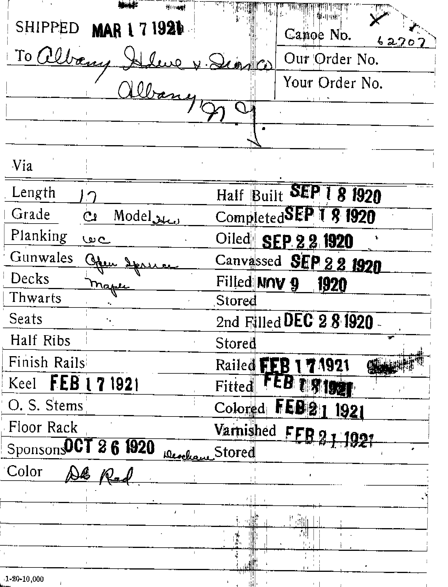

I received the build sheet from OT for my 1921 HW # 67304. Next to "planking" on the sheet are the words "Aspen Spruce" My thoughts were that OT used only cedar for ribs, so since there is no place on the sheet for ribs, can one assume they are one of these woods or is it actually cedar?
Welcome, the build record for the Old Town serial number 67304 appears to have "Open Spruce" written on the planking line as shown in the attachment below. My guess is that this is a clerical error since that phrase is usually written on the next line down to indicate that the canoe has open spruce gunwales. The ribs are typically white cedar and the planking is usually red western cedar as described at http://www.wcha.org/catalogs/old-town/specific.gif from a period catalog. The image at http://forums.wcha.org/attachment.php?attachmentid=11403&d=1278023924 shows a more typical example of a build record from this era. Can you tell what woods were used to build each of these parts in your canoe and if it has open gunwales?

The person filling out the build record form is one line off-- the gunwales are spruce (inwales and outwales)-- the decks, thwarts, and seat frames are ash. So-- ribs are cedar, inwales and outwales are spruce, and decks/thwarts/seats are ash (unless they have been replaced at some point).
