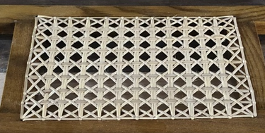

Here, I'm midway through the 5th step of 7 step caning.

Based on where you stopped, I'm guessing your frustrations mounted when weaving the diagonals. This is where it begins to get more challenging and where experience makes it easier and better. But here's some concrete, practical advice for you:
Pull out those diagonals and weave them the opposite way! That is, at every intersection with the vertical and horizon strands, you have the diagonal going over the top strand and under the bottom one. Do it the opposite - under the top one and over the bottom. It seems counterintuitive because you might think your diagonals will slip all the way inside the pairs of vertical/horizontal, but they won't. There will be much less strain on your diagonals, they will pull easier, and they will look much better in the end. You might need to zoom in on the photo below, but compare this with your pattern:

Actually, I stopped where an individual cane finished (and it was time to set the table for dinner!), not out of frustration. I have finished that seat with both diagonals but I'm going to try your suggestion for the next one. Hopefully only I will notice the difference once in the canoe! This is my fourth seat so far using this pattern, and perhaps by dumb luck the others were woven in the correct direction. I did wonder while pulling the cane why it was more difficult than I remembered. Another thing I should do is reserve the really long canes only for the first four steps which don't require much 'weaving'. Doing this only once a year is perhaps a poor way to become proficient.

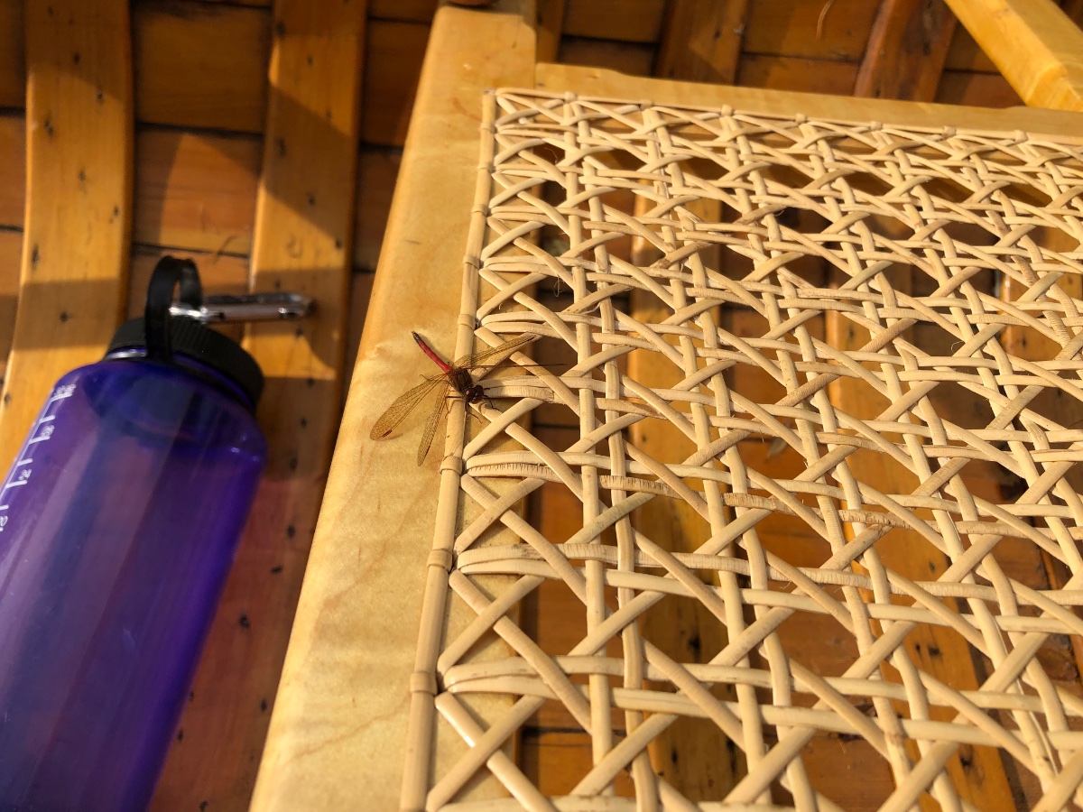

Now that I'm reviewing my current seat.... I looked back at one I did for a new seat frame on my solo-rigged Island Falls Willow canoe. I photographed a hitchhiker while paddling in the Adirondacks and the picture does illustrate the "under the lower, over the upper" process for diagonals- if I'm seeing it correctly. I recall that this seat was an easy one, though part of that is surely the fact that the hole spacing was 7/8" rather than the 3/4" for my current seat. It's good to know one more detail; you learn something every day!

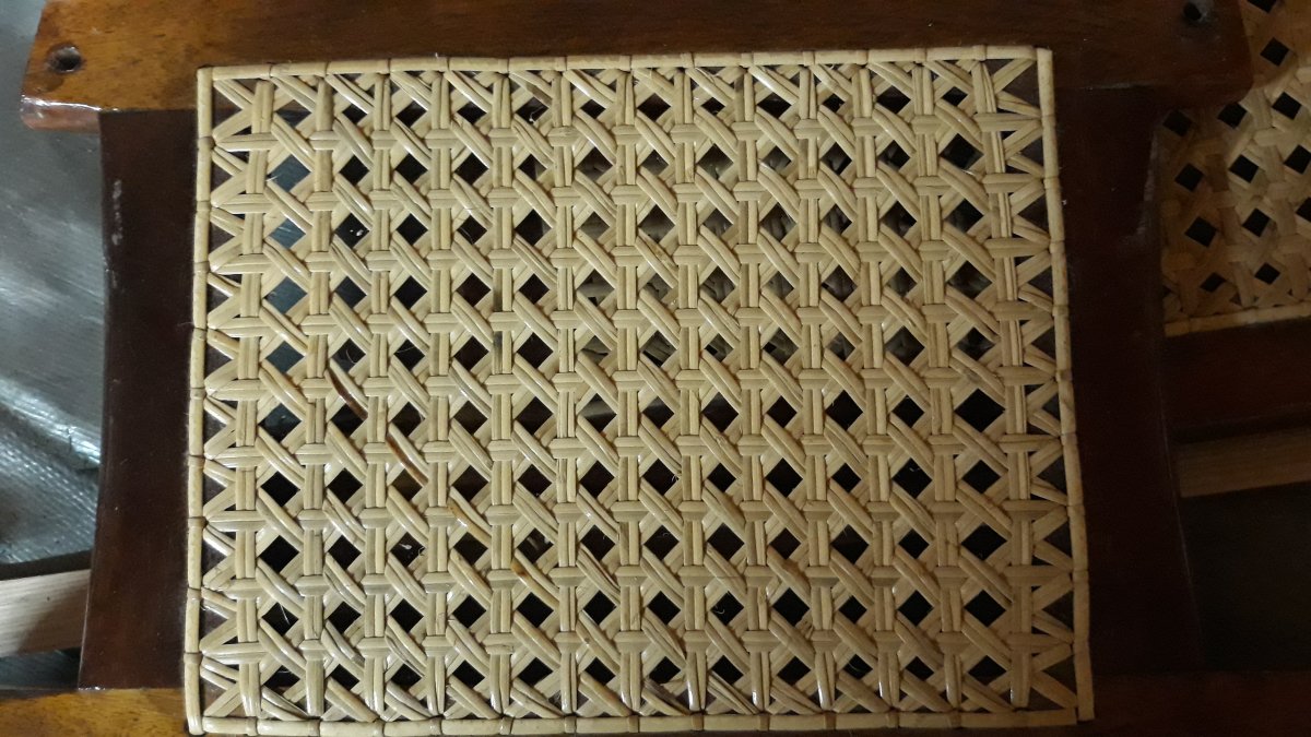

To see what I mean have a look at Patric's (nicely woven) seat below. See how the pattern is different at the edges? That's certainly not Patric's fault - he had to use the holes that were in the seat. The problem lies with the position of these holes.

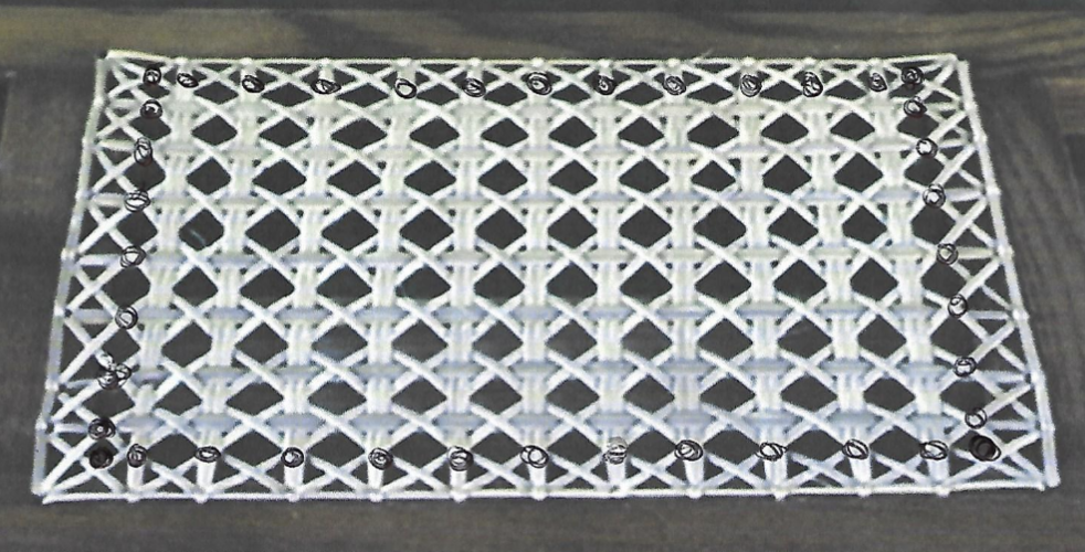

Note that every diagonal crosses the horizontal & vertical strands at a distance halfway between the holes in the wood. To keep this pattern at the edges of the seat simply drill the corner holes at a different position. See the black circles I added to the pic below. If the holes were drilled at these locations the resulting pattern would look perfect - like machine made cane.
Practically speaking, drilling these corner holes at 3/8" instead on 3/4" might make diagonal strands at the edges a little difficult to weave, so I drill them at 7/16".

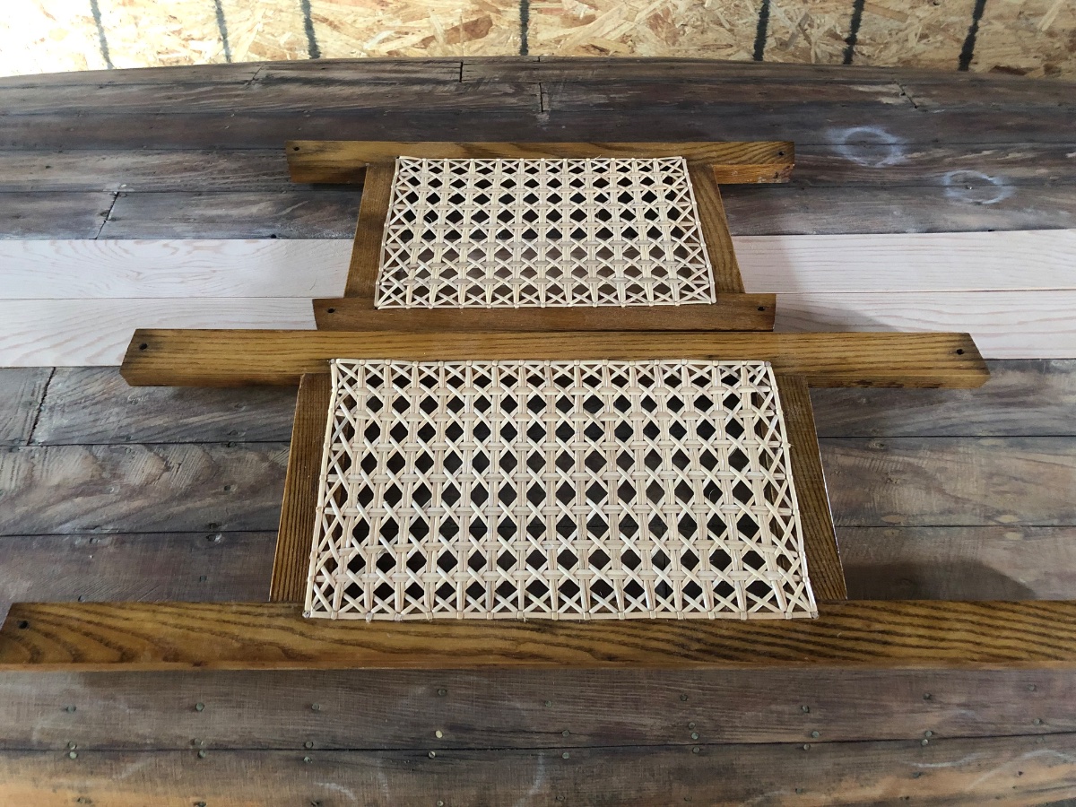

Obviously this can only be done if you build your own seats. But that's what I often end up doing anyway. The example shown below shows what I think a seat should look like - although this one was woven in a different pattern.

I'll tell you what frustrates me most when caning seats with non equal hole spacing: sometimes two holes on one side or the other are NOT equally spaced. Again using Patric's seat as an example, see how the rightmost row holes are spaced further away than the holes on the other three sides. This drives me nuts! And not only because of the additional non symetry because often I'll find myself changing my weave pattern without knowing it. Grrr....
