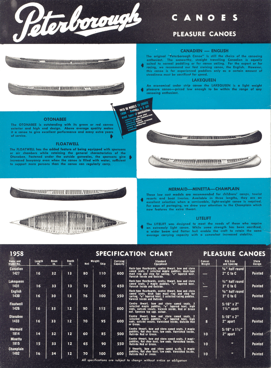

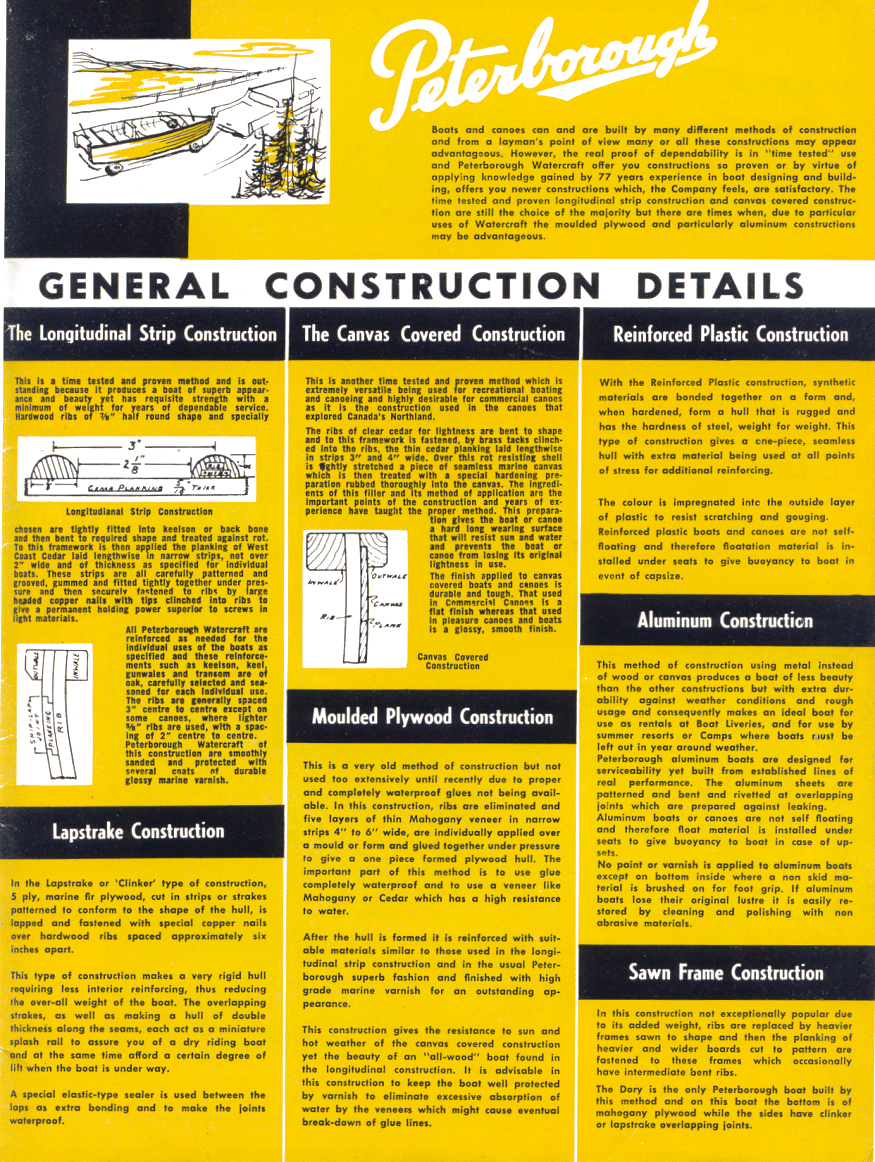

The 1958 Peterborough catalog doesn't specify the wood used for the outwales but ash will probably be fine. The pages below may help. Good luck with the project,
