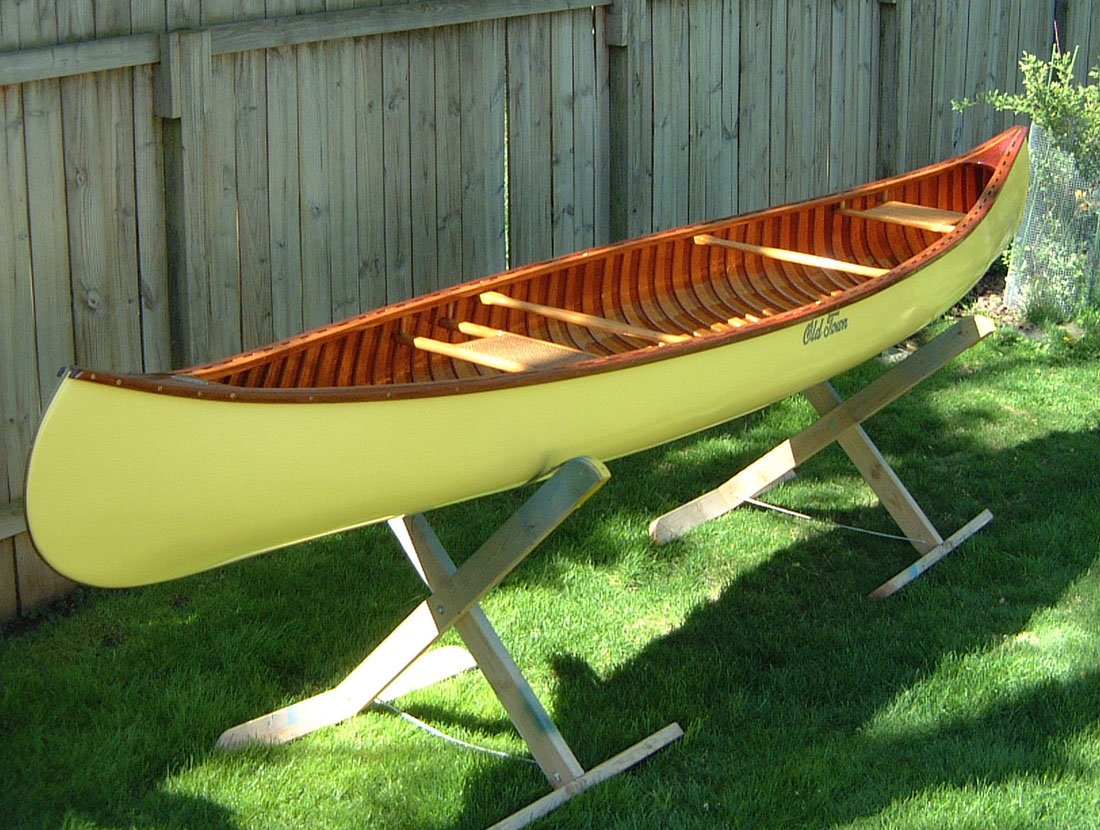

This is my 1972 Guide Special that I special ordered keelless/canvas covered. About a year later the canvas split vertically on one side near the middle. It had been torn at the factory and somebody patched it with some sort of putty and sent it out as a brand new first quality boat. Warranty said that the buyer had to pay shipping both ways to send it back for repair, and that wasn't going to happen, so I bought canvas and filler. There was no forum back then and the "official" Old Town recanvasing instructions just said "Stretch canvas until tight all around." That was all it said.
After fooling around for a whole day, I still had some wrinkles. I filled it, but it looked pretty bad. I eventually took it off and the hull hung naked in the garage for many years while I worked on other stuff. When I did decide to get it back in the water, I decided to fiberglass it, which was something I had plenty of experience with from building strippers. It is WEST Epoxy with 6 oz fiberglass - having a full layer over a second layer on just the bottom and about four layers over the stems and painted with enamel. So, it can be done, but parts of the process can be tricky and it's probably not a good first fiberglassing project.

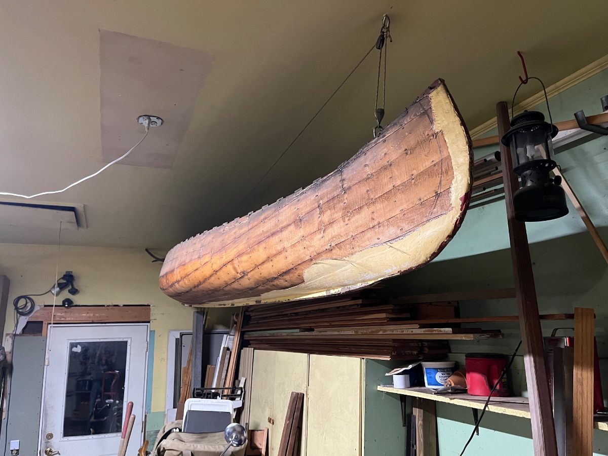

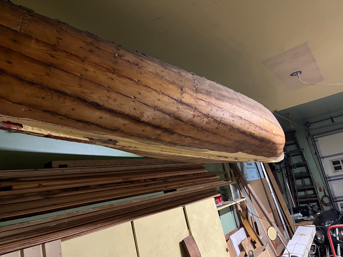

MGC, the stowe canoe is my current ride. I just got a Grumman lateen sail on it this year, but it is being retired in favor of a lighter boat. The canoe in question is hanging in my garage with heart-shaped decks, and no skin at the moment. Pictures soon.
Old Peterborough or Chestnut, not 1901 but much newer. FWIW thats about the worst way to hang a boat, turn it over and put slings under it. Lots of stress on the decks, and not good for maintaining the hull shape end to end. After covering it will be even heavier. Wont really lend itself to decks, sail it open and consider a rigging deck rather than a mast thwart, it will sail much better.

So now the one in the more recent photo; this one makes more sense. Like Andre said, much newer than 1901. As is often said here, "It's your canoe so do what you want," but if it were mine I'd canvas it. Better feel, no nasty epoxy, easier to restore in the future, etc. But this doesn't look like a particularly rare canoe, so no deep societal harm if it gets covered in goo and glass.

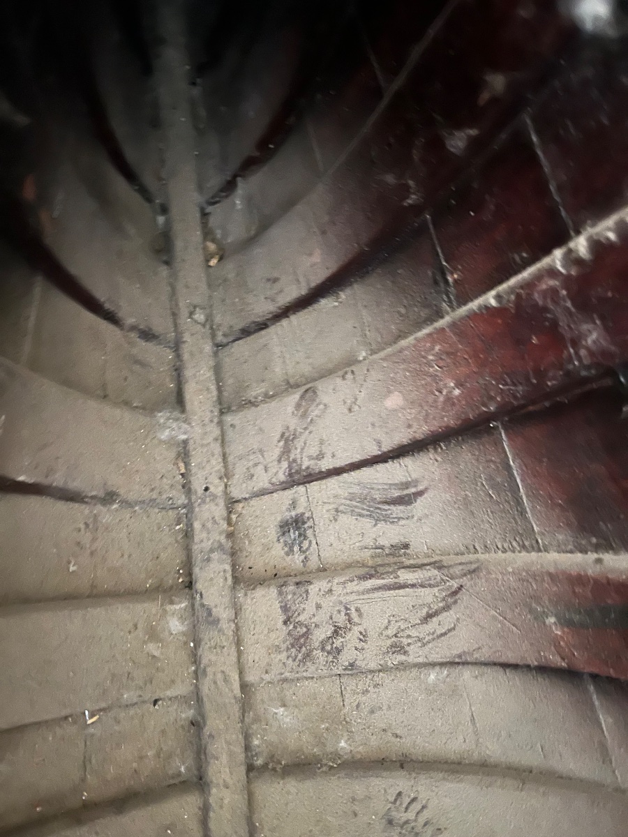

Yes Andre, I understand that is the worst way, because I just learned it days ago. After hanging that way for the last 26 years, it looks pretty good still, so a few more days will pass while I move other boats to make a proper cradle for it. After reading the latest comments, I shall research further an open sailing canoe, in canvas, because if it can’t sail, it won’t be first choice. I paddled this canoe for a couple years before stripping the glass off to see it’s real condition.

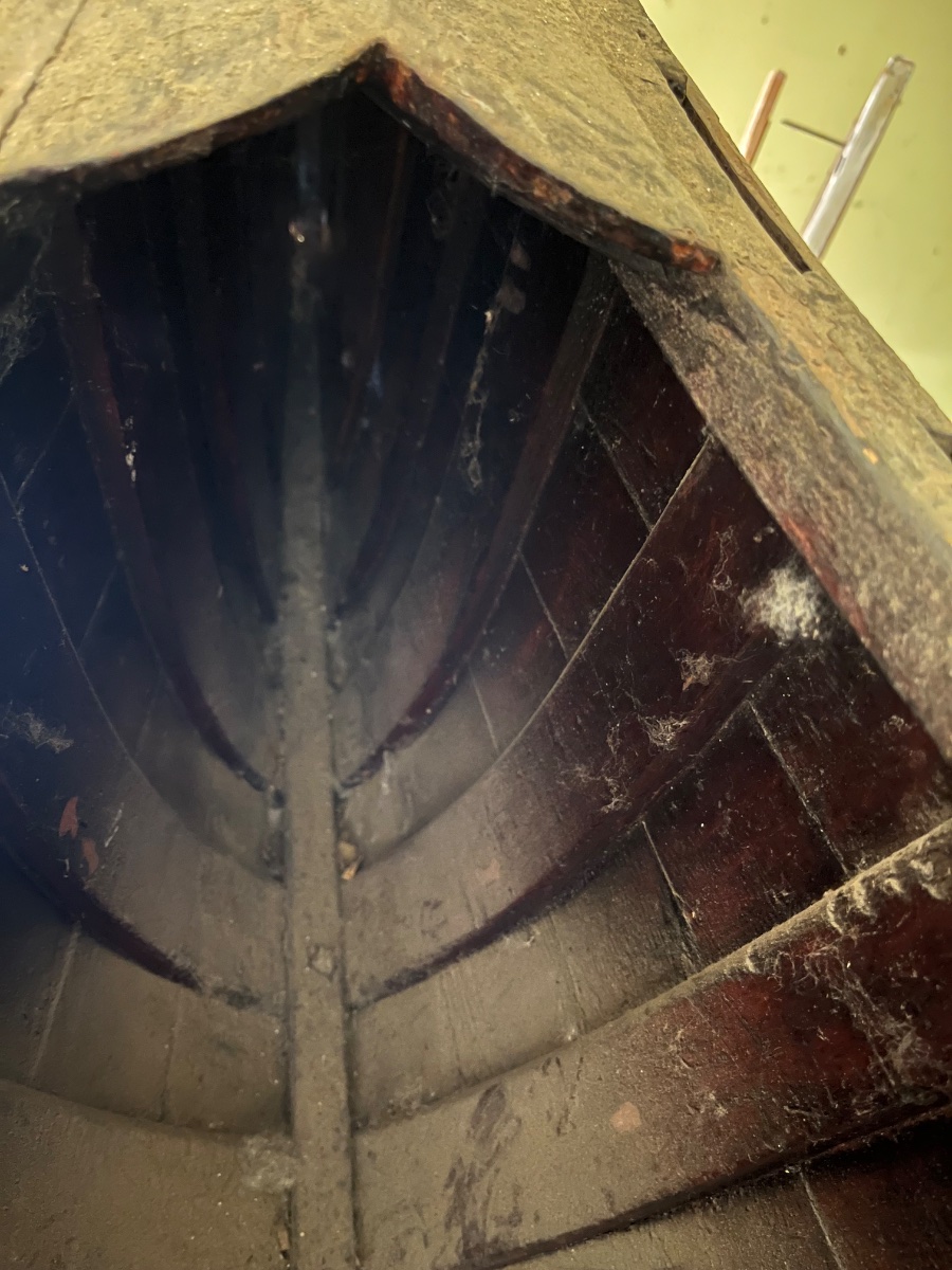

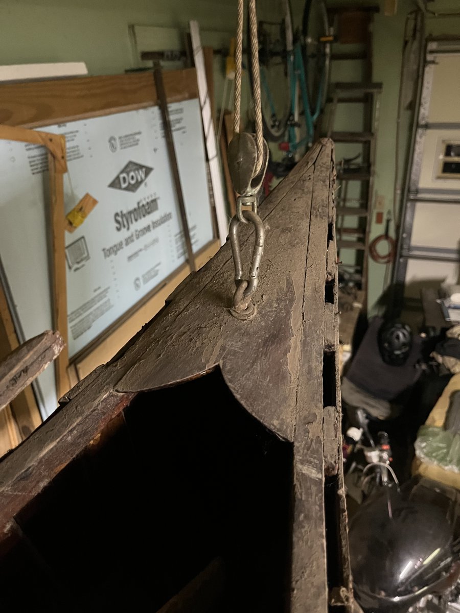

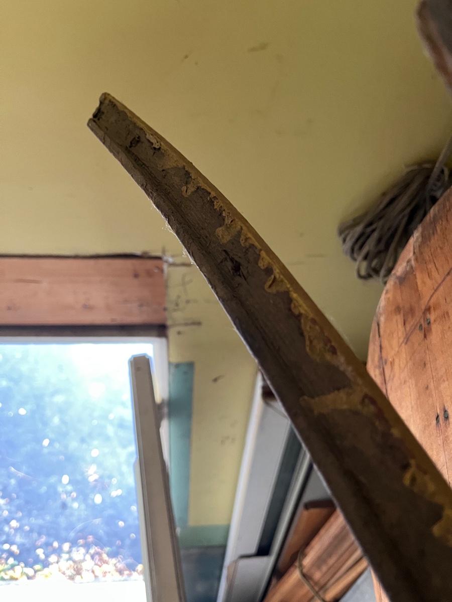

One of the identifiers of a pre-fire Chestnut is cant ribs the same width as the regular ribs. Do the ribs in this photo seam to qualify? The gunnels are said to be “closed”, does this return edge on the inside of the gunnel qualify for that description. I’m not worried about the value of my canoe, ( it’s a hobby) but it would be nice to guess who the manufacturer might have been.

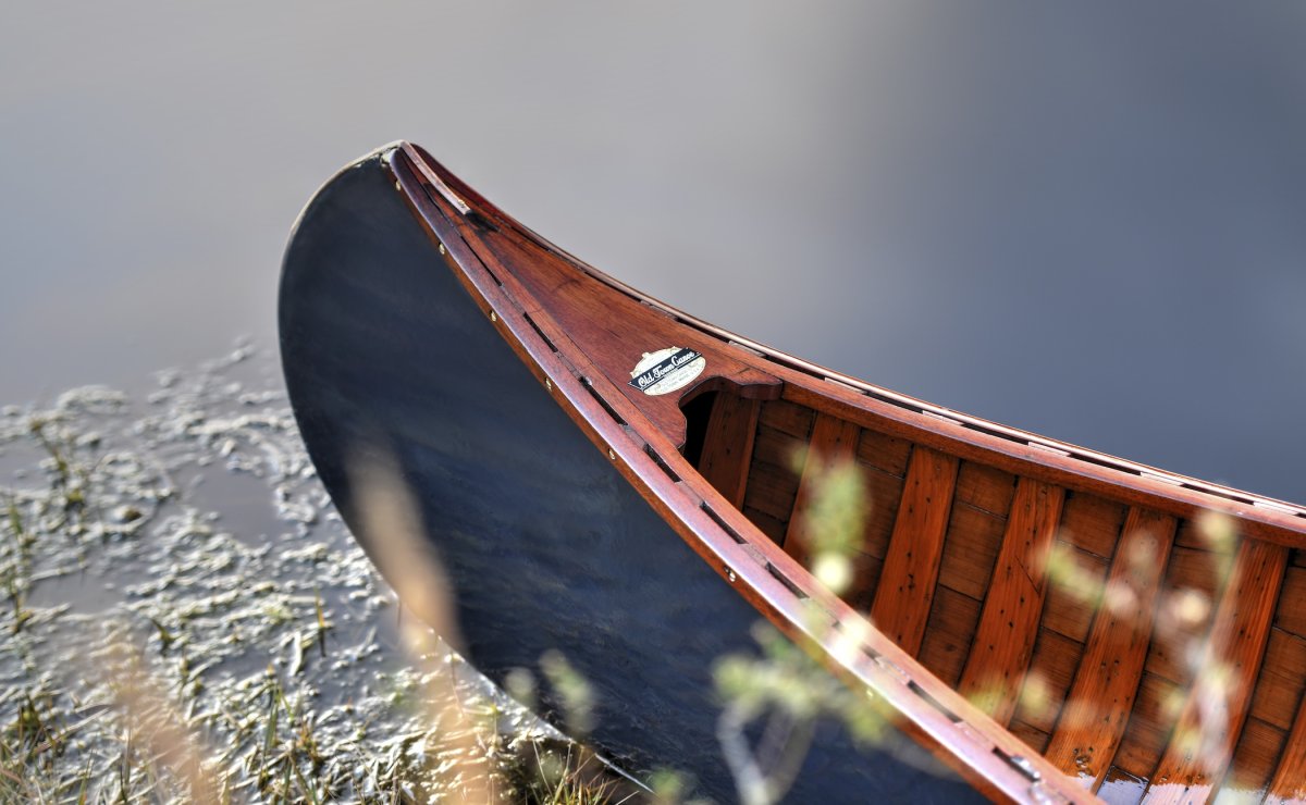

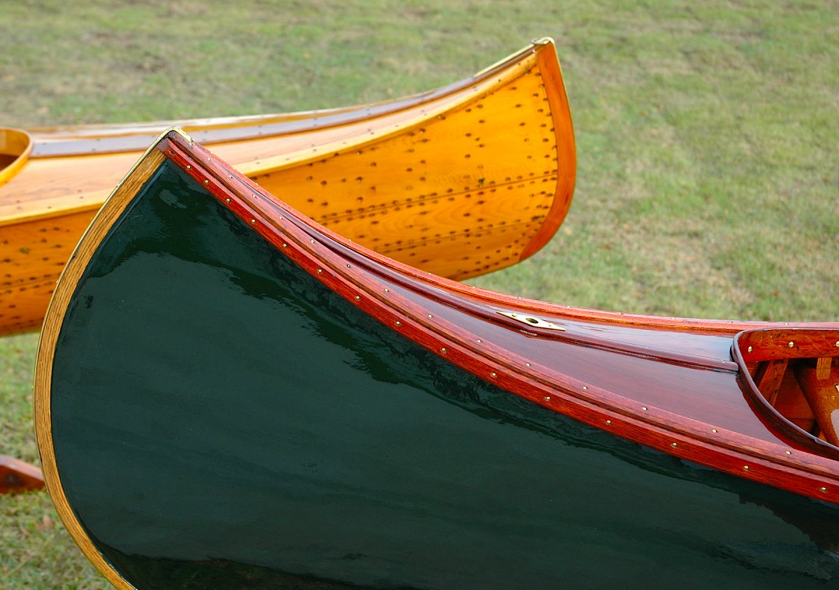

Yours is an open gunwale canoe. The rib tips are sandwiched between the inwale and outward. On a closed gunwale canoe, the ribs are often (but not always) tapered to a feather edge at the top, and then a top cap and a side cap cover the tip and sides of the gunwale so that there are no open spaced left (hence "closed").
Open:
Closed:
