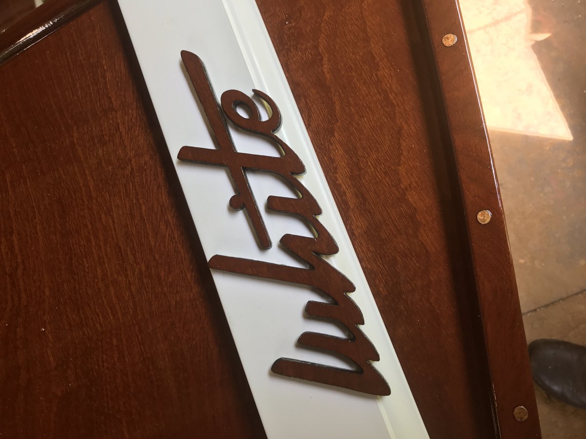

I made this one laminating sapele plywood to black plexiglass. We tried to laser cut the 1/4” sapele plywood but it was too hard for my sign guy’s machine. I took what we had and ran it through the drum sander until it looked clean and was cut out. The plexiglass cuts like butter.
I did it 3” tall. I’m going to attach it to the boat tomorrow.
Heh Tycer...thank you so much! That logo is beautiful!!! Yes, I'd love to get 2 made by Mike@art2sign.com for my boat. Is that the place in on Haywood Rd. in Asheville, North Carolina that is called Cheadles Art and Sign? Do you have a phone # for Mike?

I'm thinking I'd like to get them made in red acrylic or plexiglass to match my red bootstripe and it's the color the White Company appeared to have used. Your Sapele Mahoghany emblem is really classy though...very original.
What did you mean in your previous post that Dan has the "vector artwork"? What is vector artwork?
