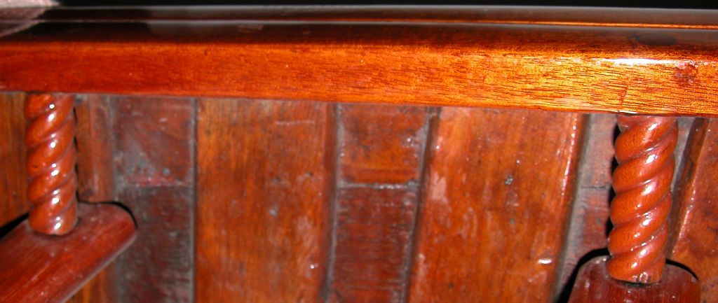

more pics
Odd twist on the seat hanger. Odd deck and comb..... can't see any diamond head bolts...

Now it REALLY looks Old Town. That's the style thwart Old Town used in the early days, and rarely in early, nicer Old Towns you see that kind of spacer between seat and gunwale. The lack of diamond-head bolts is also consistent. In these early ones, bolts were flat head, countersunk, and capped with a plug of the same material as the gunwales (usually mahogany).

Whatever the case, this boat does look OTish. Perhaps it will be cleared in the light of day. I have seen that type of seat hanger on older OT's.
The AA Grade Charles River Ideals had untapered ribs - at least for a while.
The nicely carved spacers on the seat hangers are likely from Old Town. Get a better look at the serial No.

Yep - just as expected. I don't have the records CD, but I'll bet this is going to turn out to be Old Town, early - pre-1910 or so. The thwarts are dead on, the "twist" seat spacers, the untapered ribs, the decks and the double gunwales - all point to OT. Glad you got it.
