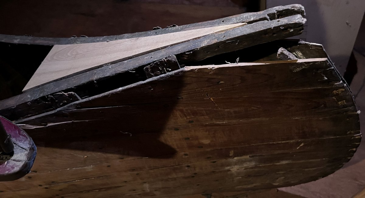

Jerry Stelmok has a canoe that is thought to be a Whitney as shown at the bottom of this message. It was found with another similar canoe that had a Whitney stamp on the deck like the one shown above. The stem through the deck is similar to the one at the Maine State Museum described at the link below.

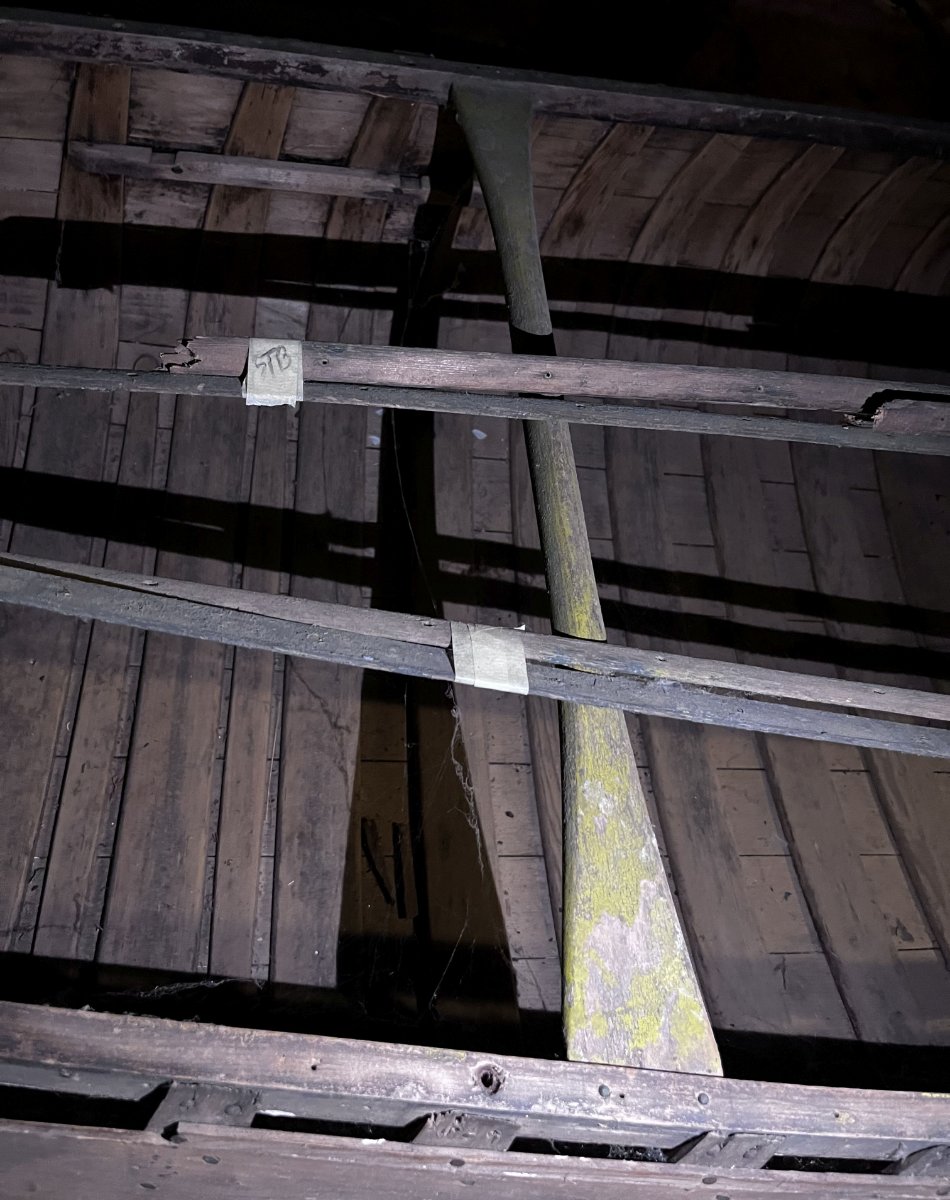

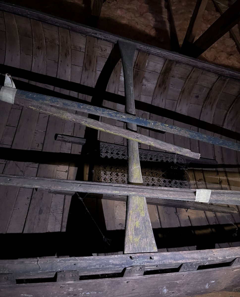

Rear seat photo? That front seat cleat is real interesting. Half ribs only at front and rear paddlers feet like my ancient White. Thwarts are similar but not nicely carved. Where are the old decks?

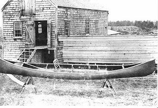

Here is a photo of the same shaped thwarts and the front seat hanging on the same style cleats.

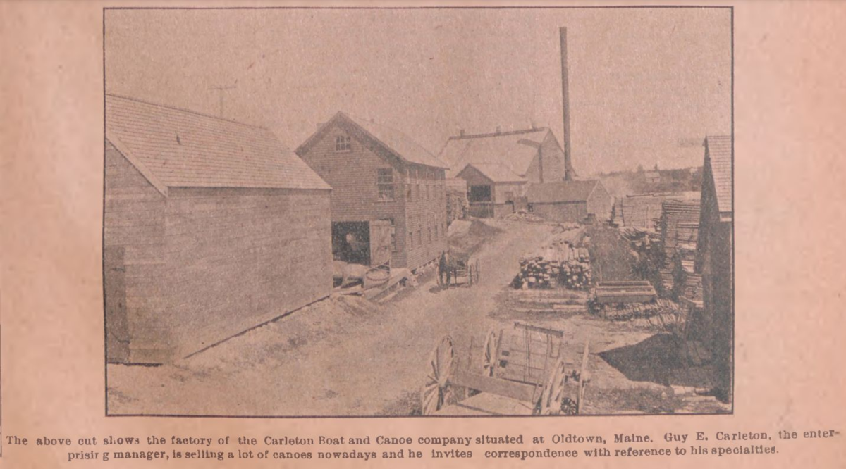

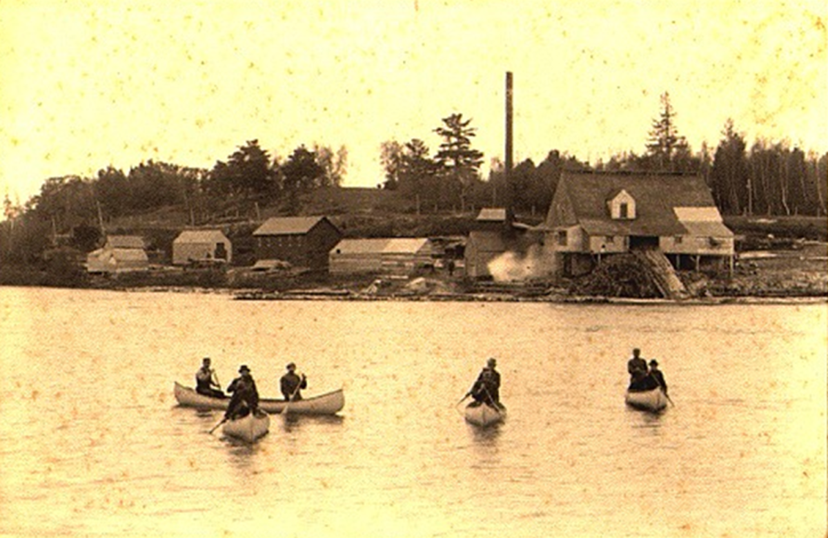

I agree that it does look similar. That image has been the source of some confusion over the years. It appears in Sue Audette's 1998 book about Old Town with the caption "A Carleton canoe is displayed outside the Carleton shop in the late 1880s. Courtesy of Harold Lacadie" on page 13. It also is shown at http://blog.ravenwoodcanoes.com/2017/04/early-em-white-canoe.html in André Cloutier's Ravenwood Canoe blog post from 2017 about an early White canoe as well as at https://oldtownwatercraft.johnsonoutdoors.com/us/heritage in the current Old Town Canoe site that mentions the Indian Old Town Canoe and Robertson & Old Town Canoe companies. The building, lumber pile, and canoe are consistent with other early pictures of the Carleton sawmill on the edge of the river as shown below.
