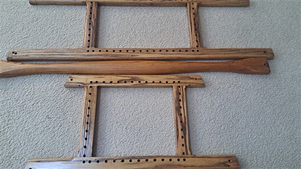

So I sanded the seats down to get as much of the old staining attempts off he wood, then wiped on (& off) two coats of Minwax Golden Oak. The color was in the ballpark but not close enough to match the canoe's ash thwart I had previously stripped & varnished (without stain). So I got some Minwax Polyshades Classic Oak (I didn't see a 'interior use' warning) and applied 2 coats. The color was a bit better, so I then applied 2 coats of Gleam marine varnish. Here's the result. Finally I can start caning.
