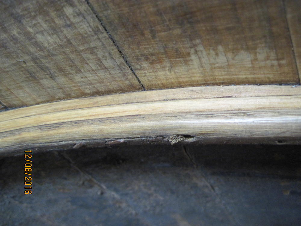

I have a 16 ft canoe. It is similar to Peterborough, narrow ribs. If the picture will show it, the ribs are narrow but laminate of three pieces. The outer piece is tapered at the end. Thus it is three laminates around the hull but when it reaches the gunnel the taper is down to two thicknesses. As you see, it is not a wide board even while it is wide board construction. Got it from a member who felt it worthy of fiberglass removal. Obviously, it was canvas originally. Closed gunnel so must be early 20th century. IMG_4504.jpgIMG_4501.jpgIMG_4500.jpgIMG_4503.jpg
Might add, this canoe must have been built on a Canadian form. It oddly enough had a very wide, 1 1/2 to 2 inch keel and two bilge keels as well.
No replies so far. Ribs are on 6 inch centers. Canoe is 15 ft 10 inches. Laminated ribs, tapered at the top outside to create tumble home. Someone make a guess.

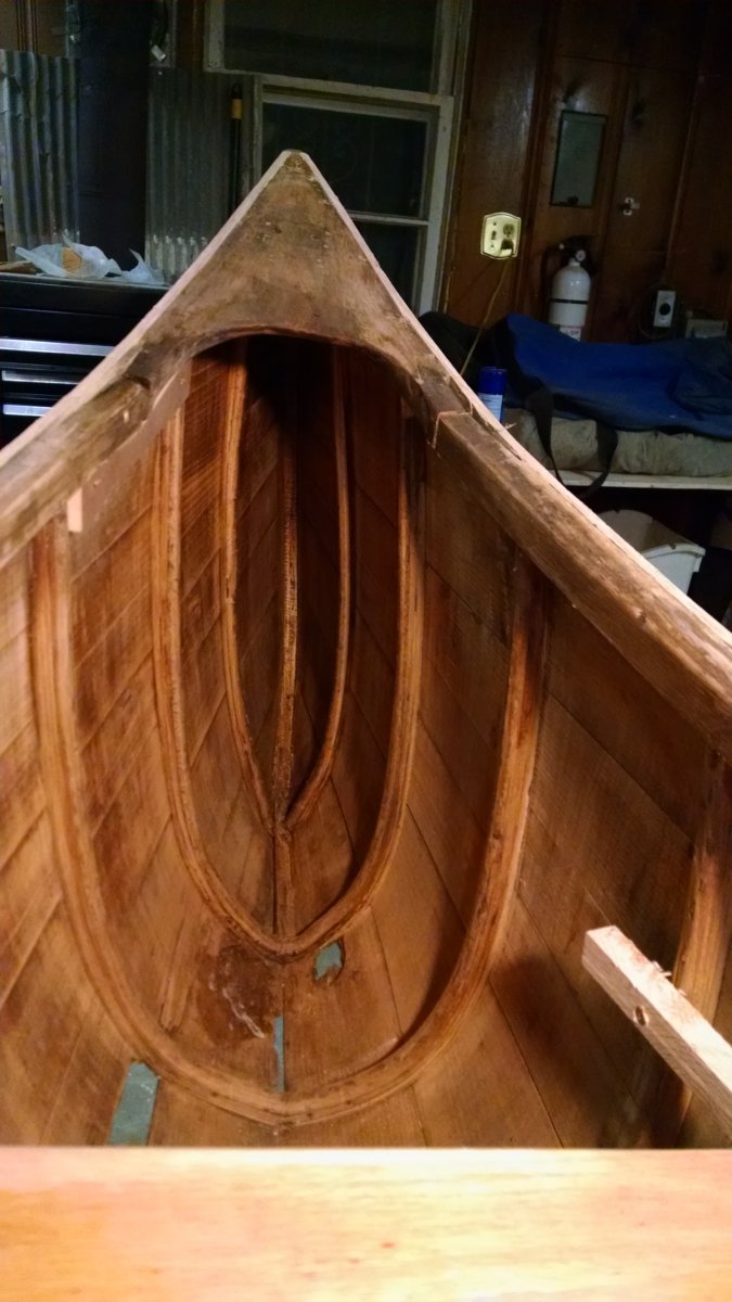

This canoe has typical cedar planking with one exception. The top plank is oak and runs full length, 1 1/2 inches wide. I cannot tell if it was steam bent or cut to follow the up-sweep. Anyone seen something like this before?
Here's the stern with the new oak plank. I'm a little concerned for putting on the canvas. Staples will be hard to drive

Deck view, ribs, holes not fixed and seat hanger on right.
