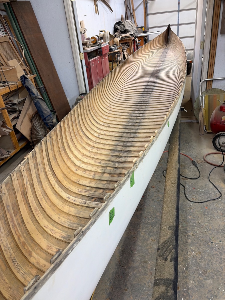

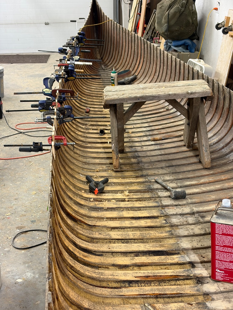

I usually use Epifanes Woodfinish Gloss for build up coats. I like it because no sanding is required between coats. After build up, I sand it out and apply either Epifanes Clear Gloss or Matte.
I’m now working on a 34’ War Canoe and would rather not mess around with 1000ml or quart cans. I’m hoping for gallon cans.
I’ve found out that Jamestown/ Total Boat sells gallons of their Lust Varnish. It is “no sand” as is the Epifanes.
Just wondering if anyone out there has used and has an opinion on the Total Boat Lust varnish?
