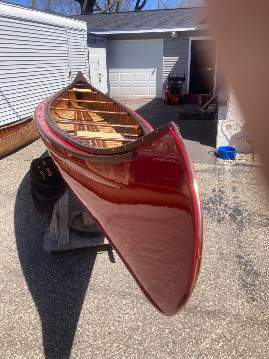

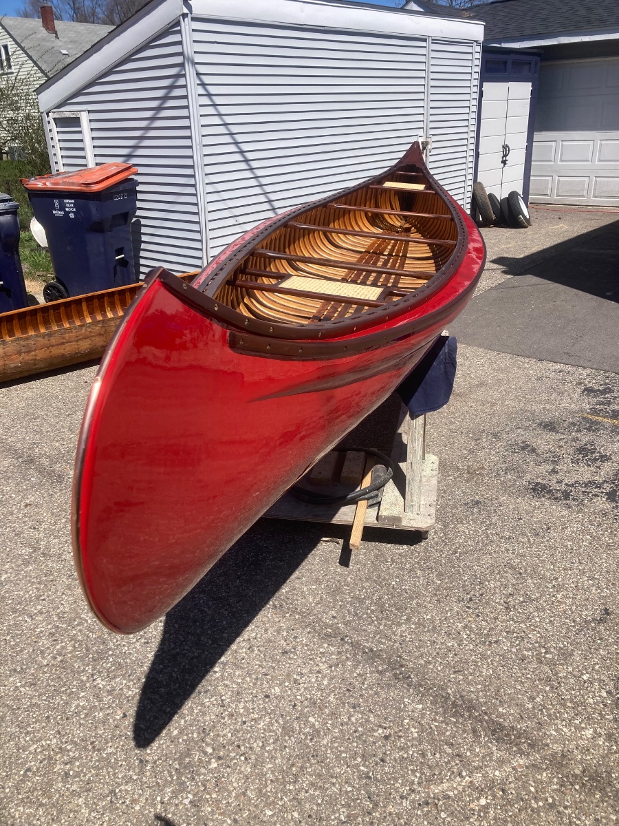

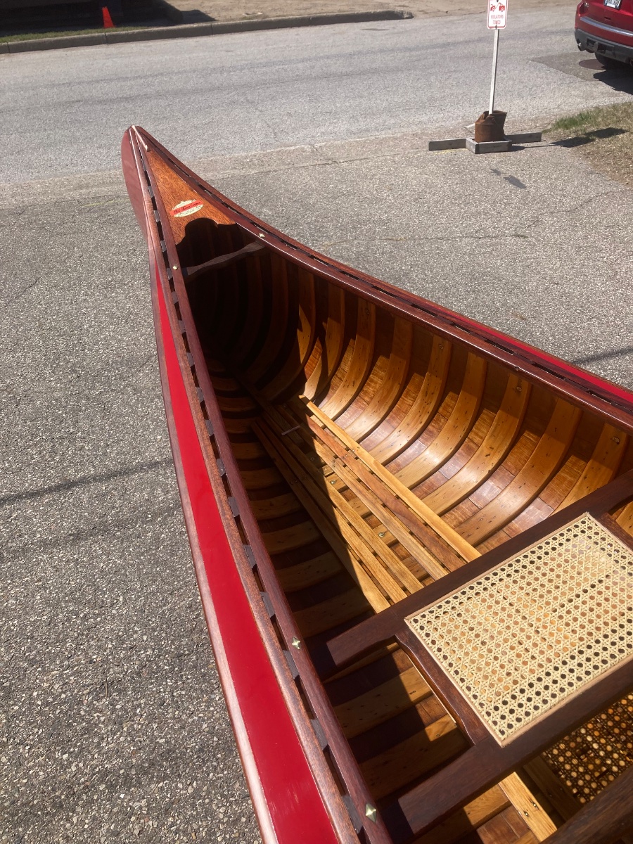

I absolutely love Epifanes paint. Flows like no other. But….gloss is almost too glossy. I block sand down to 320 before final coats. I use Rustoleum as “filler” coats and am wondering if it’s causing a problem that is bugging me. As I know these things aren’t car fenders and will never be perfect, I am always refining and challenging myself to do better. See the images and notice the “ripples”. Now, I will note that you cannot feel these with your hand. I push customers towards satin Epifanes more and more because of this. I use Rollins filler as well so I know it’s tried and true. Perhaps I’m being too critical but it still drives me bananas! I’m wondering is the rust inhibitors in the Rustoleum are maybe causing this so to eliminate that possibility I’m trying another paint to see if that helps. Oh, also use petit high build primer over the filler first….

I have occasionally chosen to use a flattener but for this canoe, the glossy appearance is fine. Its red. Red is a not a shy color. When I drive around in my Guards Red car, I'm not pretending it is anything but a bright red and (if it's clean) shiny car. I see the same here. The ripples do not show in these images, so that looks quite perfect.
I love the choice to use a matte finish on the wood. To my eye, that always looks much better on a restoration than high gloss on old wood.
