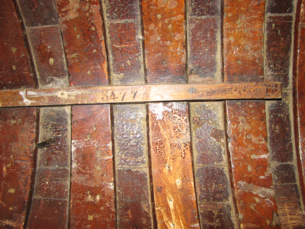

The picture of serial number 3477 below was posted recently in the Fans of the WCHA group on Facebook with the claim that it was an Old Town from 1906 along with a small picture of the canoe.
This could match the Old Town build record below.

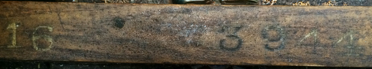

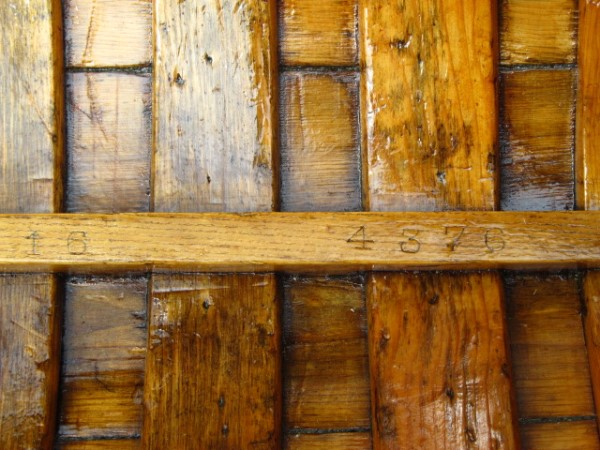

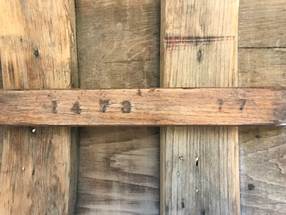

I've asked for a picture of the serial number from the other end and a confirmation of the length but have gotten no response. The font for the number three is what confuses me. The confirmed Old Town serial numbers from that era all have a different font for the three as shown in 3944 and 4376 below.

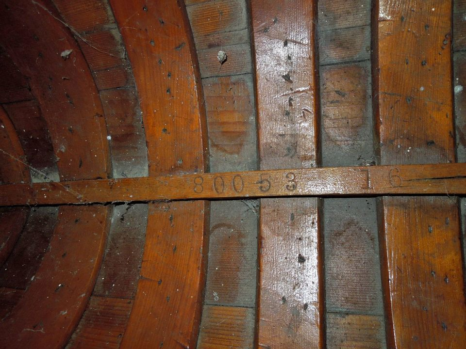

The first time the other style three appears after this in my records is 80053 from 1924 as shown below.

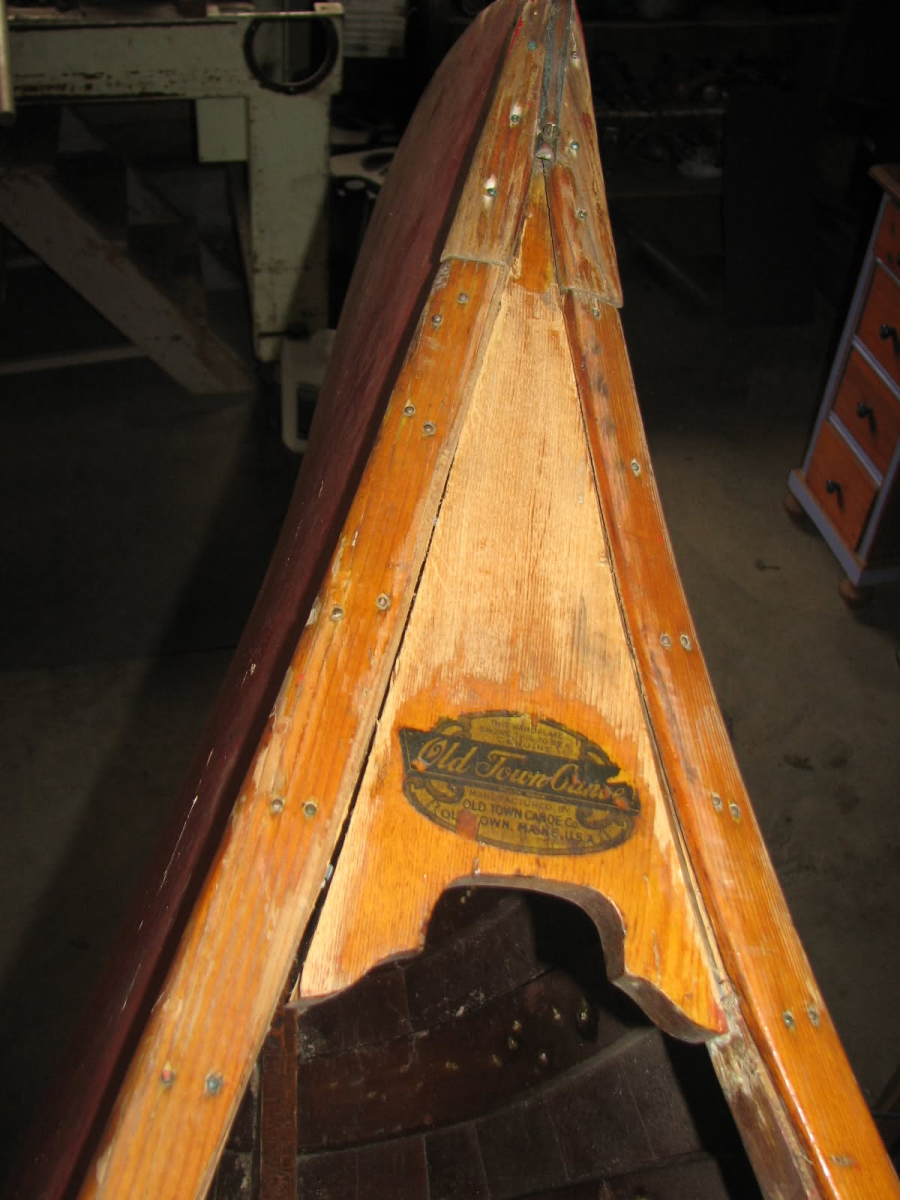

The owner also mentioned in a previous message that the canoe was in Sweden. My guess is that there is a hidden digit. The build record for number 93477 is a reasonable match. It even has the same color and a 1920s style name plate as shown in a previous message.

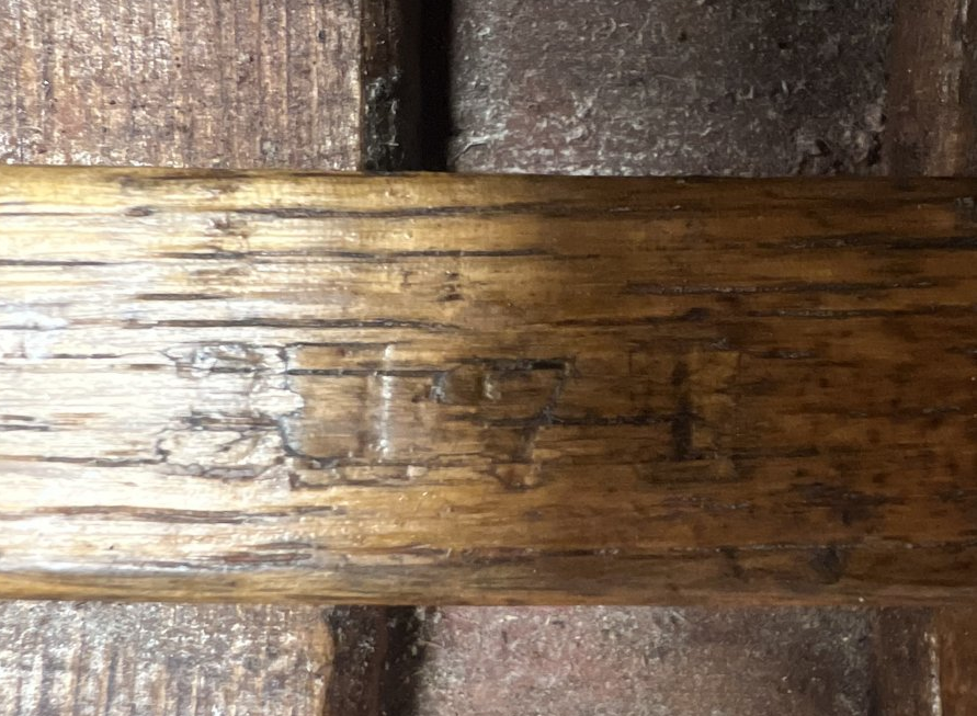

Picture of font from my 1903 Old Town.
Yes, the very early Old Town canoes had threes like that but the font was much smaller overall. It appears that the larger font with the different three appeared between serial numbers 3171 and 3944. Two other examples are shown below.

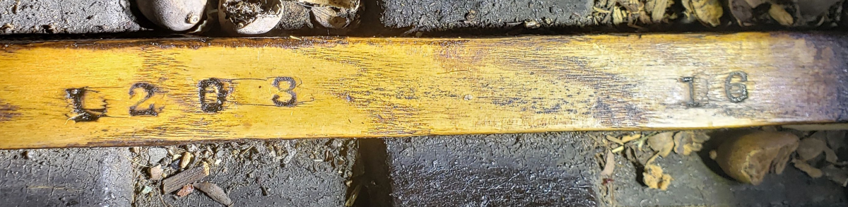

Alright, was able to link up with Jim. Not exactly sure of the serial number, but it is 4 digits and starts with 1. Glad I was able to get it into his capable hands and look forward to his work. Jim has sent a couple pics today, loads of work to include sponson repair. Looks to be an old one.
The serial number is 1852 16. Todd is right, loads of work including undoing the grossly incorrect work by someone decades ago. I should not be too harsh however, the work did keep it together. Considering it's now 120 years old I guess it's in pretty good shape for the shape it's in. Photo of serial number attached.

Well shoot, not sure how may were made in the early 1900's. if a 48xx...was 1906 then the one Jim has may be earlier.
Jim, as discussed when we met in MD and based on the pics you have sent so far. I truly know it is in the right hands. Please share your efforts along the way.
The fully competed Old Town build records start around serial number 3800 in October of 1905 which is about 760 per year from when they started around October, 1900. The estimates at the link below may offer a better idea. Canoes are usually not shipped in strict serial number order which can further confuse things. Serial number 1852 is clearly an early one.
