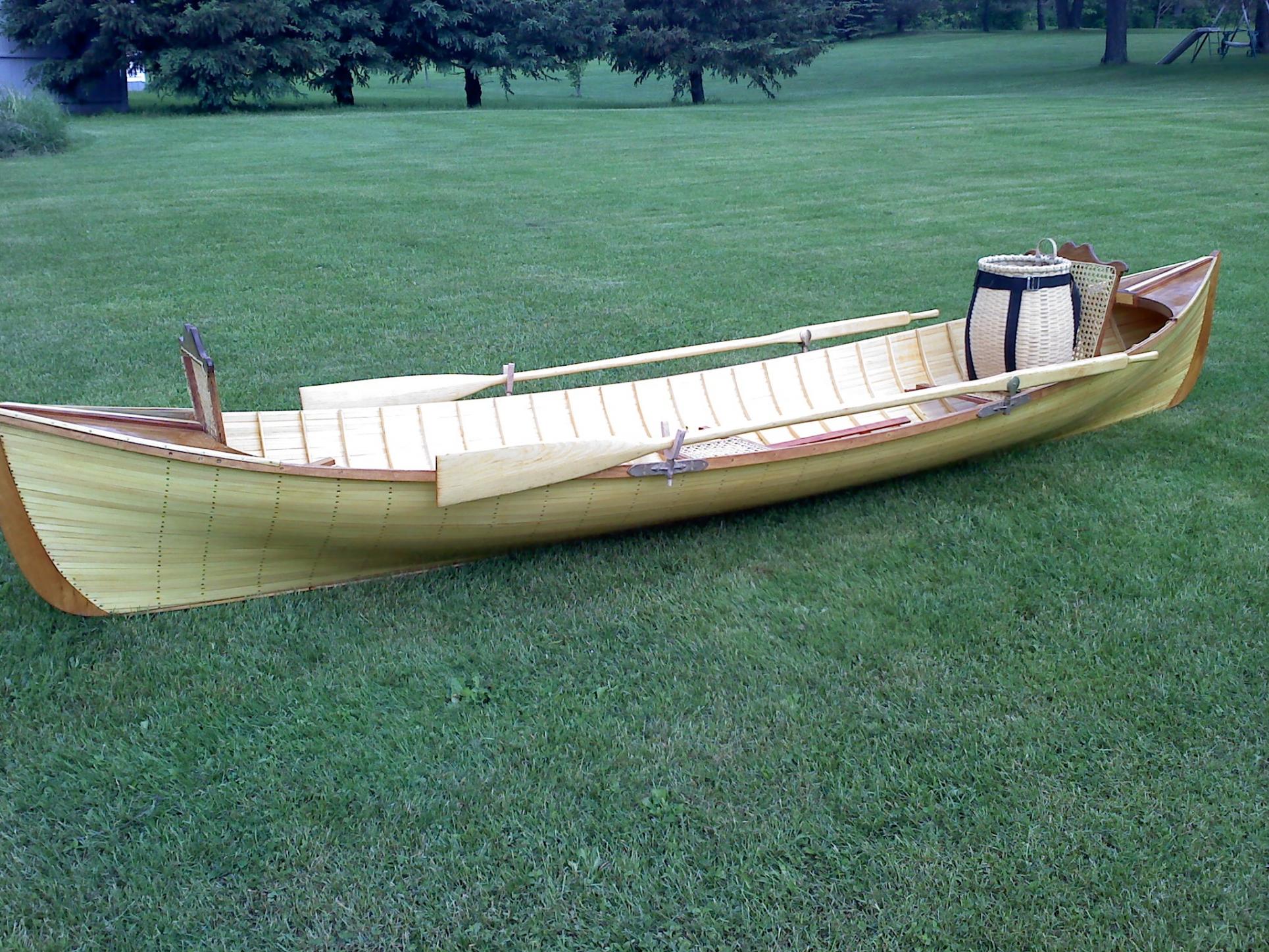

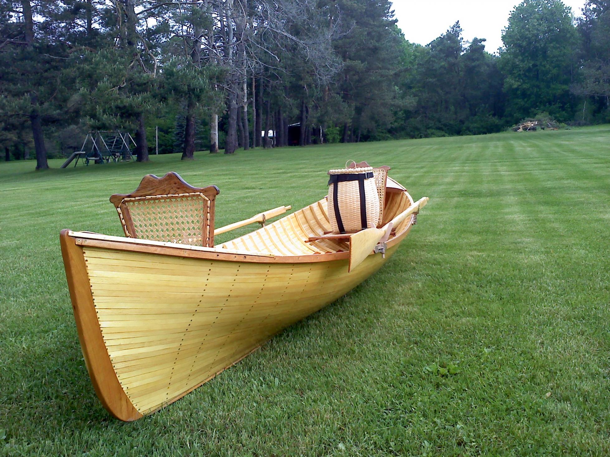

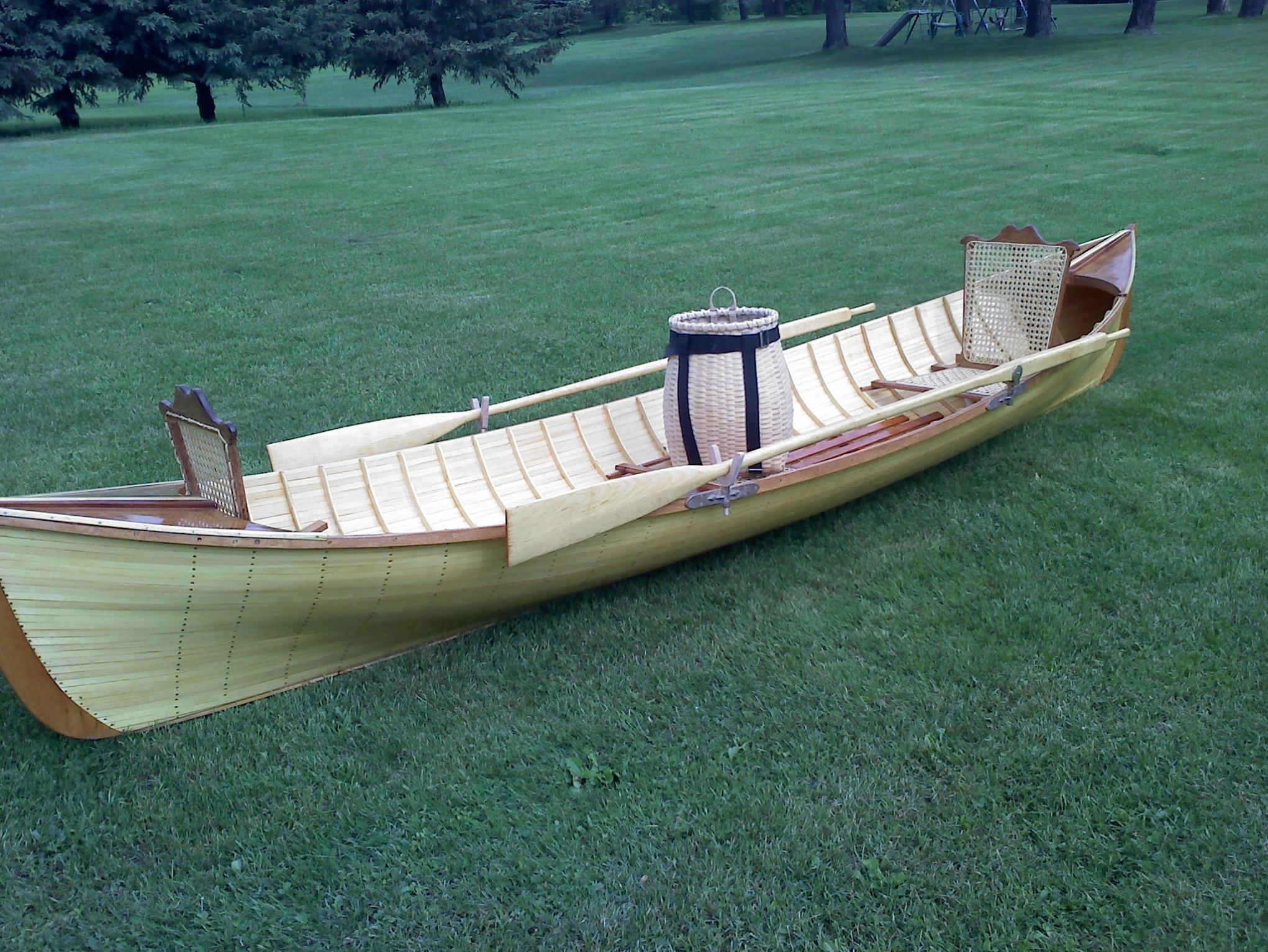

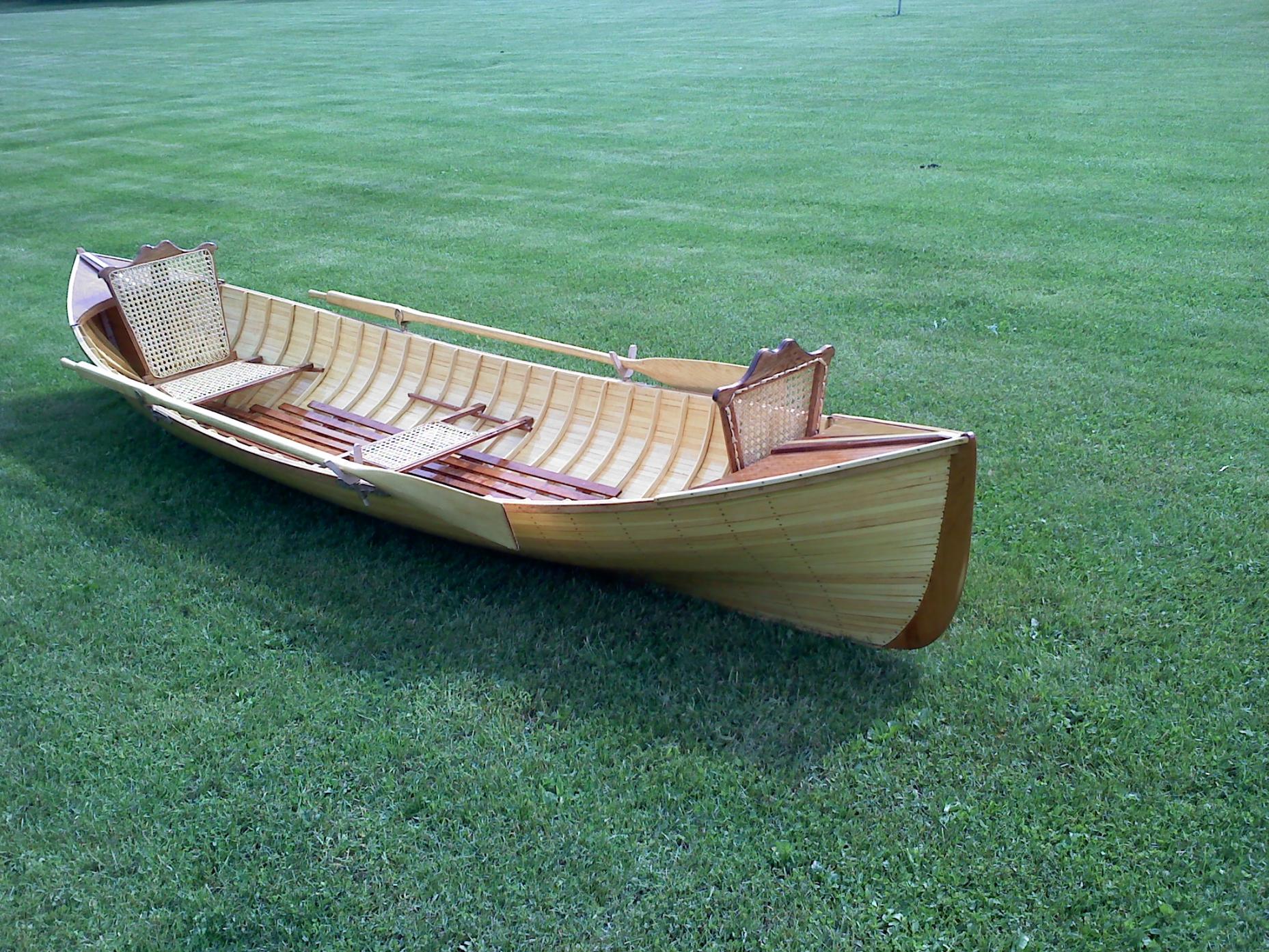

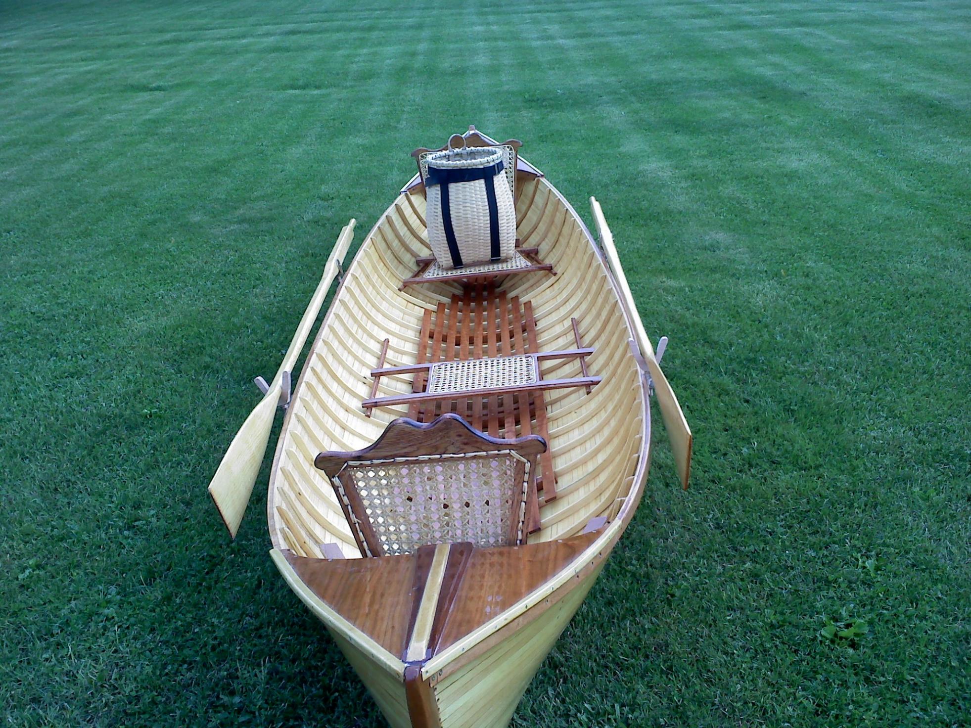

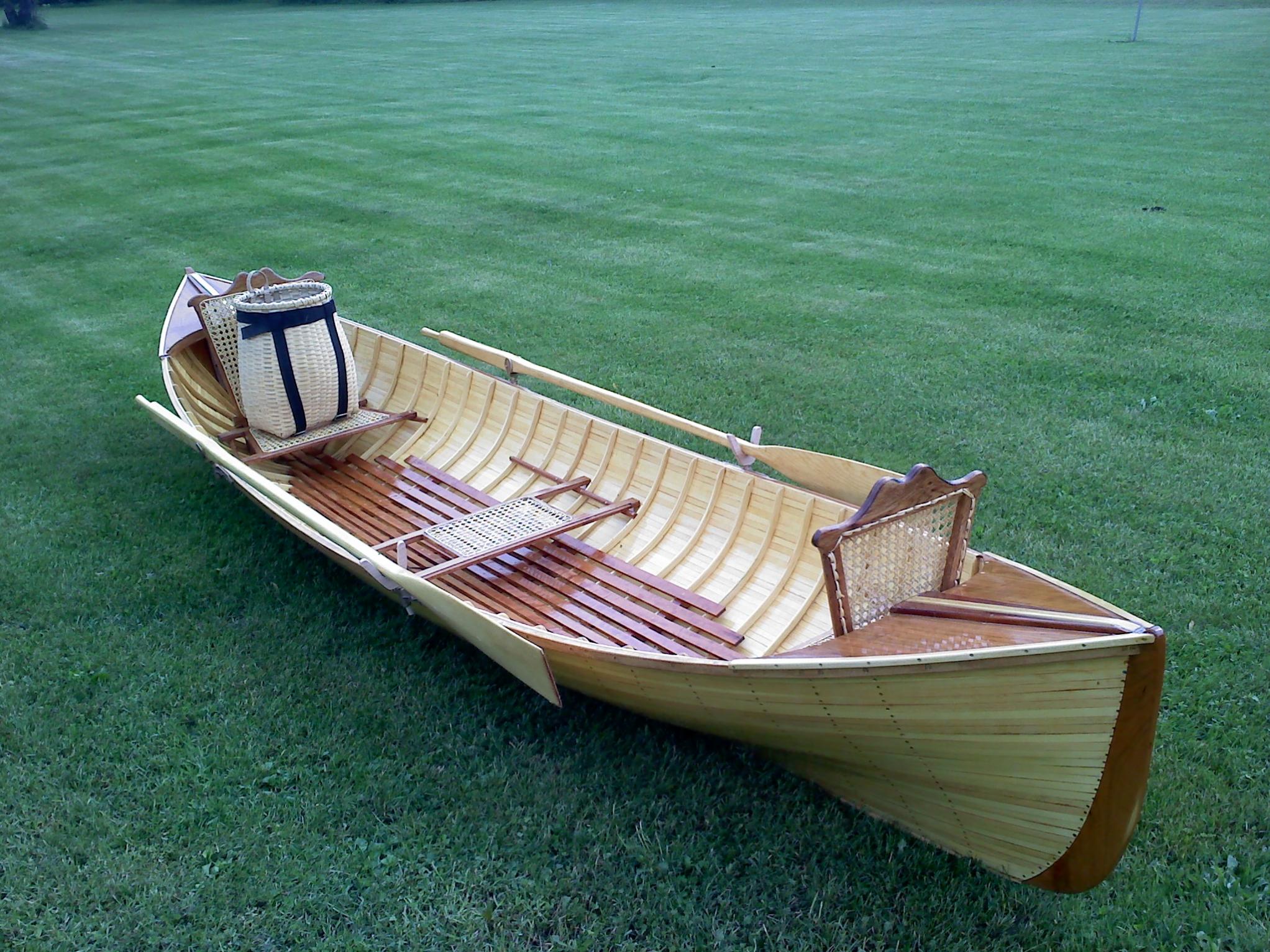

Chargers Guide Boat & New to forum
Hello everyone, Well my Guide Boat is less then one year old. I built it this past Feb. - May. It is a strip built (Pine) with Spruce Laminated ribs. The bottom board is Pine as well. The decks are Cherry, Mahogany & Hard Maple. The gunwales are Hard Maple but stained to look like Cherry. I used the book called " Building an Adirondack Boat " by John Michne & Micheal Olivette. John was very helpful to me while I was building my boat & I thank him immensely. I met John in Long Lake at Hoss's Adirondack Authors Night in 09. He convinced me that I could build this boat with my talents in woodworking even though I am Legally Blind and have a hard time seeing anything at all. I have since finished the boat and loved taking it out in Newcomb on Lake Harris, Beldon Lake and Rich Lake as well as Long Lake. It is a dream to row and is very stable. From what I have seen so far in this forum I am in great company of many very good boat builders and feel honored to be in this group.
Charger, that's some nice work right there. Congratz.
I must price out some pine from the local sawmills and see about building one of these things....after my canoes are restored I guess. Only room for one project at a time. LOL.
Anyone?? Doesn't Adirondack Guide Boats use chamfered joints on their strip planking??? Sorta lock the latest strip down in behind the previous one against the rib or molds when glued? It would eliminate the gaps between the strips.
Thanks Easterivers, I am very proud of her. As to your question about chamfered joints, They are only used when Planking not strip building. The joints in a stripper are Bead and Cove with glue running down the complete joint. I used Titebond IIII on my boat with NO fiberglass on the outside. I also used a very good Marine Varnish on the inside and out, 4 coats on each to seal the boat. I had NO leaks at all and even after banging some rocks up on the West Branch of the Hudson River near Newcomb, New York.
