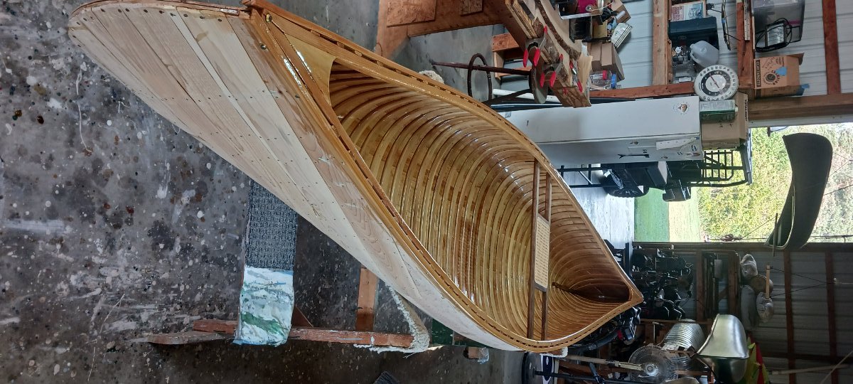

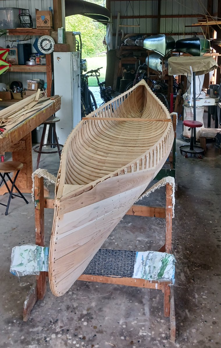

I was able to insert a random photo or two of the canoe. It's awaiting canvas. Like Andre says, the final outcome is a gamble. I'll look for another one that is done.

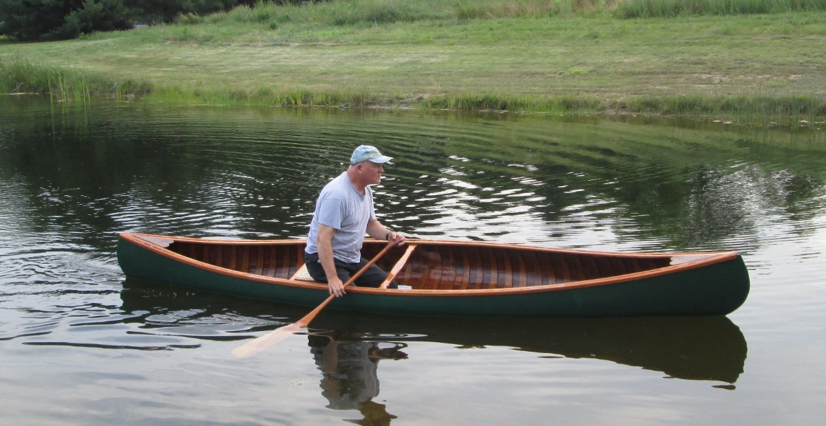

Here are two more photos. the first one with the good looking paddler is the original PY Guide that I shortened. The second one that is upside down is one of the first I built from the shortened form.
Oh, and one other thing. The depth. It will be proportioned to the longer canoe. I did not make the form shallower. What you see is the depth of the original 18' PY Guide.

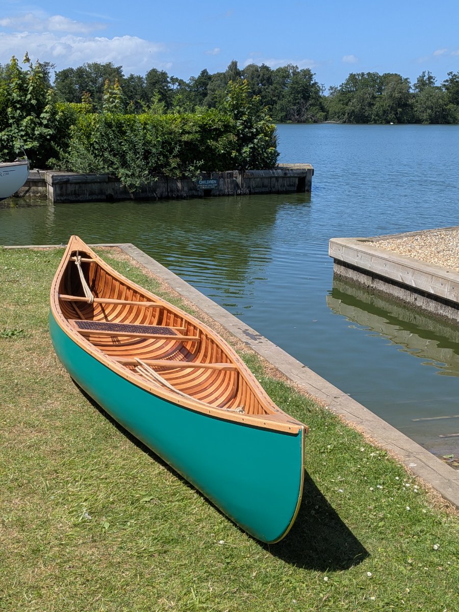

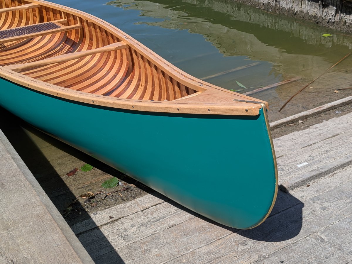

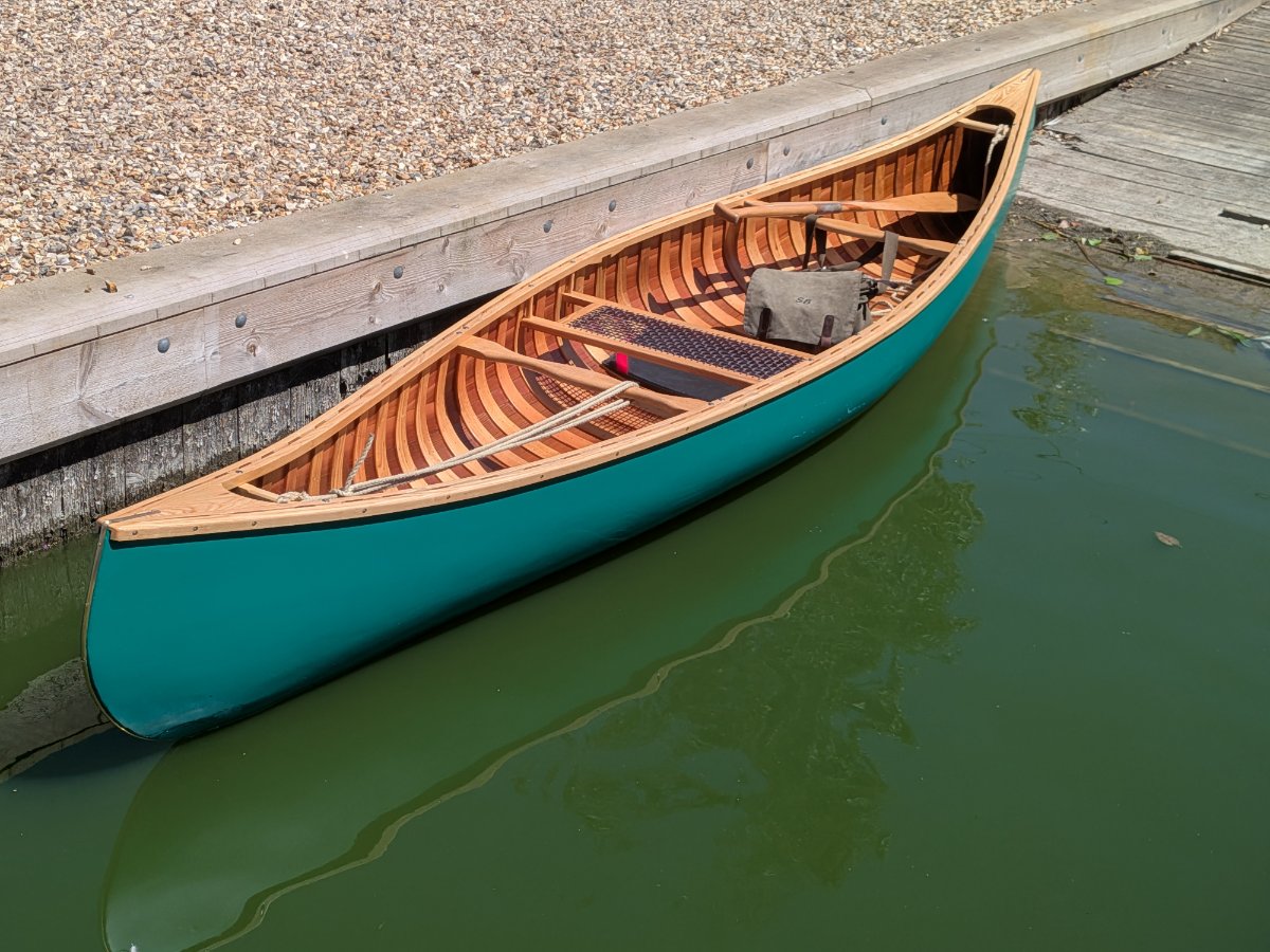

Well, I got the form and luckily the stations were at 12 inch centres. I set about it with a saw and screwdriver to remove the centre station and one adjoining one to give me a 14' form . It needed a bit of work to make it fair where I rejoined it. This is the result, red cedar and ash.
There are a few things to change before the next is made
  • I need to redo the bands on the form; at present there are an even number. This means that fixing the outwales through alternate ribs doesn't work. I've had to put screws in both the central ribs.
  • Some of the bands are a bit loose and sloppy meaning they don't clench as well as I'd like. Some towards the end are at the wrong angles.
  • I need to relieve the angle on the front edge of the seat (or eat more pies) and I don't need corner holes drilling if I'm going to lace it the same way
  • I may pull the next one in a bit more but as there isn't a great deal of rocker at present I won't get much before it hogs
  • I might lower the rails a bit.
I will sell this canoe when I have used it a bit more and confirmed the changes I want to make. Here in the UK, there is little interest in wooden canoes ; loads of people saying that they'd love one but be too afraid to paddle it in case it got damaged. So long as I get my money back for materials for the next one I'll be happy. Decent imported Canadian cedar is not cheap here!
