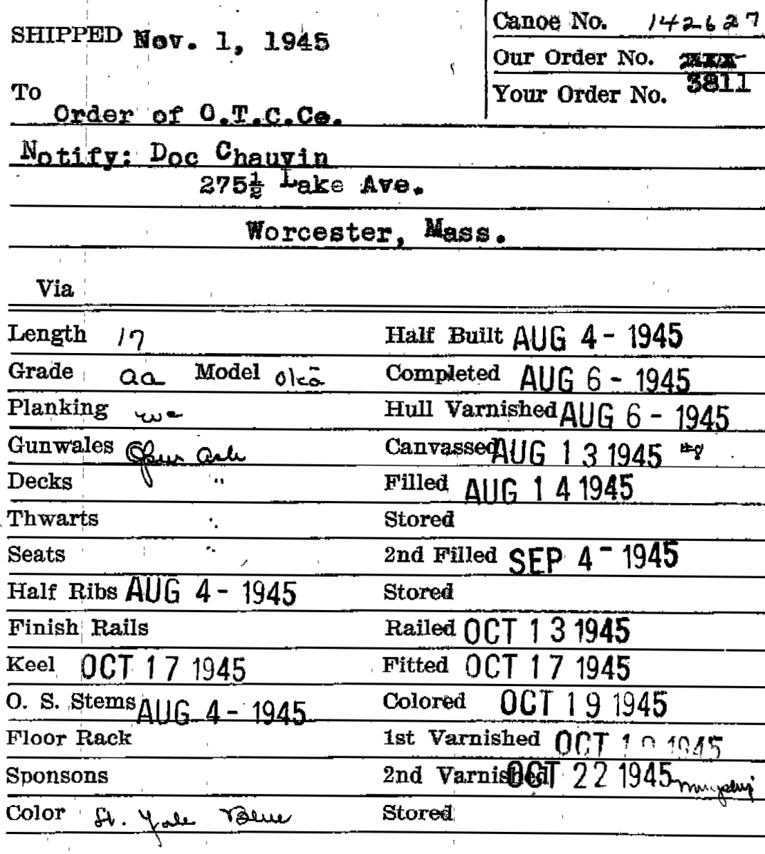

Looking for info on a new restoration project. SN (as I can read it) is 42627 17’ Any info would be amazing. Thanks!
Welcome and congratulations, the Old Town canoe with serial number 42627 is 16 feet long so that isn't a good match. My guess is that you may have the one with serial number 142627. This is a 17 foot long, AA (or top) grade, Otca model with red western cedar planking, open ash gunwales, number eight canvas, ash decks, ash thwarts, ash seats, half ribs, a keel, and outside stems. It was built between August and October, 1945. The original exterior paint color was light Yale blue. It shipped on November 1st, 1945 to Worcester, Massachusetts. A scan of this build record can be found below.
