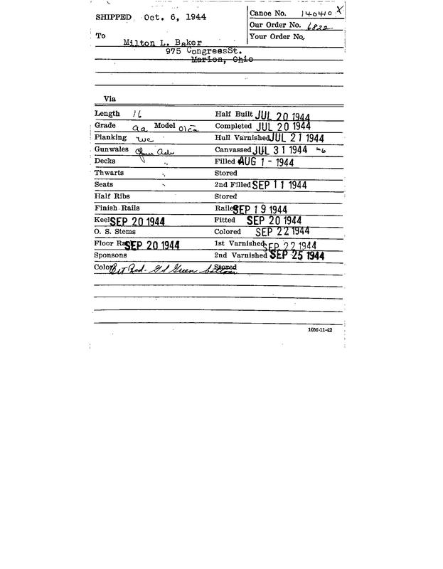

The Old Town canoe with serial number 140410 is 16 feet long, AA grade, Otca model with western cedar planking, open ash gunwales, ash seats, decks and thwarts, and was equipped with a keel and floor rack.  The keel and floor rack were installed on Septebmer 20, 1944 and finishing was completed on September 25, 1944.  An AA grade canoe was typically finished with mahogany rather than the ash used in this canoe, undoubtedly because of wartime unavailability of some materials. The original exterior paint color was bright red, with a guide special green bottom.  It was shipped to Marion, Ohio on October 6, 1944.  A scan of this build record can be found by following the link behind the thumbnail image attached below.
It was not equipped at the factory with a rudder or motor mount, nor were paddles and backrest shipped with it from the factory; such items were often added by the dealer or by the owner.
