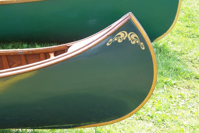

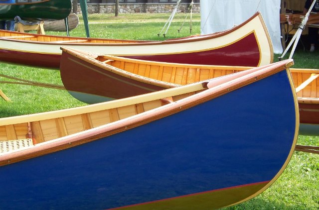

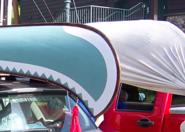

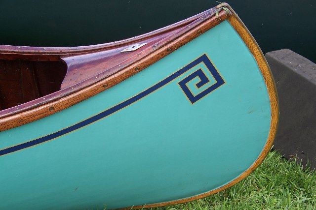

Keep in mind that varnish is not simply cosmetic -- it provides substantial protection for the underlying wood -- protection against abrasion and perhaps more important, against degradation of the wood by ultraviolet light. Almost anything exposed to the elements that is painted or varnished needs a new coat from time to time -- paint and varnish do not last forever. And when the existing coat has failed to the point of peeling or, as in your case, alligatoring, the best course of action is to remove it before applying a new coat.
Sanding the interior of a canoe to remove old varnish is rarely done -- just too much work and too time consuming. Sanding the interior is usually done only when applying new varnish over a sound older coat, when a light scuff sanding is done to facilitate adhesion of the new varnish to the older.
Bleaching is most commonly used after stripping when new wood has replaced old broken wood, as a way of matching the new wood to the old to get a uniform appearance. If no wood is replaced, bleaching is probably not called for -- and some folks don't bleach in any case, not minding the difference in color between old and new wood.
Preserving an old, failing finish might be called for on a museum piece that will not see water again -- but is not appropriate on a canoe that will be used. Paint, varnish, and canvas on a canoe are like tires and brakes on a car -- wear items that a meant to be replaced from time to time.
I'm guessing that the existing paint is not the original paint, in any case -- and at a minimum, you may want to strip the paint from the exterior stems -- most folks prefer to have them finished bright.

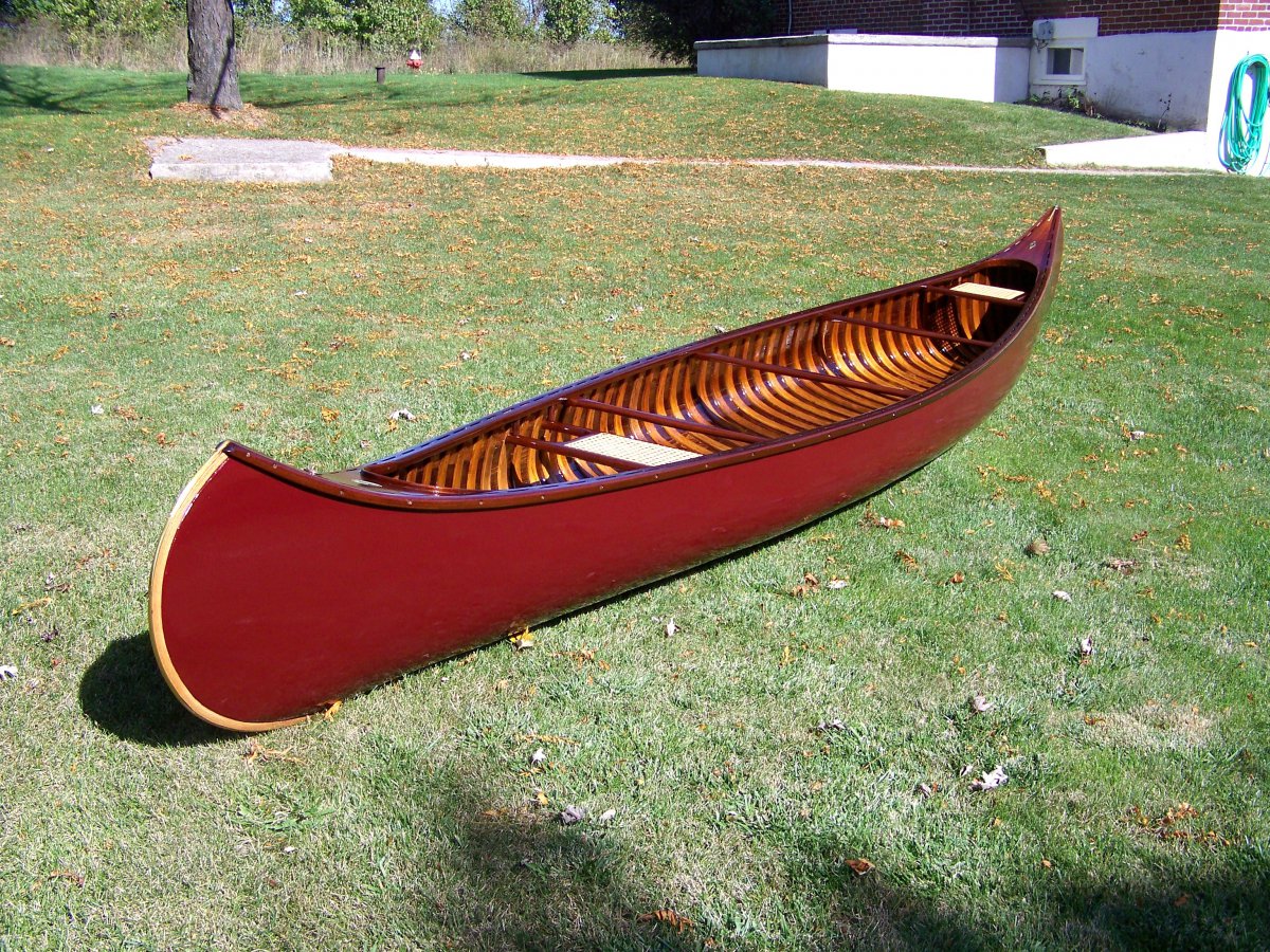

Strip, no bleach, light sanding is my favorite way to go... if it needs the new ribs blended stain to match before putting them in. Strip and sand gunnels and decks light stain if necessary.
Beautiful! I don't think I'll need any new ribs (fingers & toes crossed), there are some splits but no cross-grain damage. One plank has some damage. Cross that bridge when I come to it... Varnish on the decks is pretty intact so I'm inclined to light sand and put a light coat, preserving the original OT decal. Time will tell... see how well I do on repairs to the decks. One has a split from the middle of the coaming up toward the decal. The other has a small chunk missing up at the tip. I'll be asking for help on some of these forthwith as I get to them!
Inspired by your photograph - thanks:)
