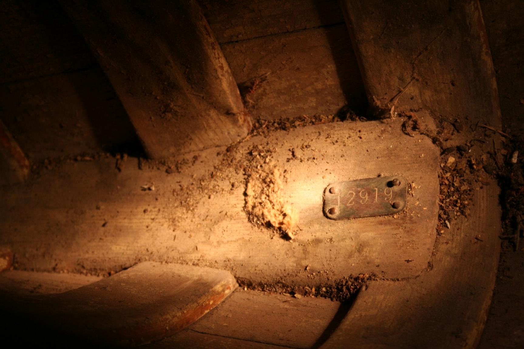

Old Town did not use brass plates on the stem for serial numbers so my guess is that you may have a Morris. The Old Town canoe with serial number 9482 is 17 feet long. Can you attach some pictures of the plate and stem? The pictures at http://forums.wcha.org/attachment.php?attachmentid=9247&d=1259005654 and http://forums.wcha.org/attachment.php?attachmentid=8957&d=1256758898 show some typical Morris stems with a brass serial number plate. Therer are no known existing serial number records available for the B. N. Morris Canoe Company unfortunately.

Kathy will find this thread tomorrow and will be able to fill you in on Morris details much more thouroughly than I will, but the year as best as current information suggests would be about 1911 for your canoe. Yes, B.N. Morris made canoes with long decks and removeable floor racks. The real tell tale sign is the stem with the brass tag. IF the stem is splayed, then its a Morris...by splayed, It spreads out. If you search for Morris canoe on Youtube, you will find a video that Kathryn Klos (Kathy) made and you should be able to identify your canoe.

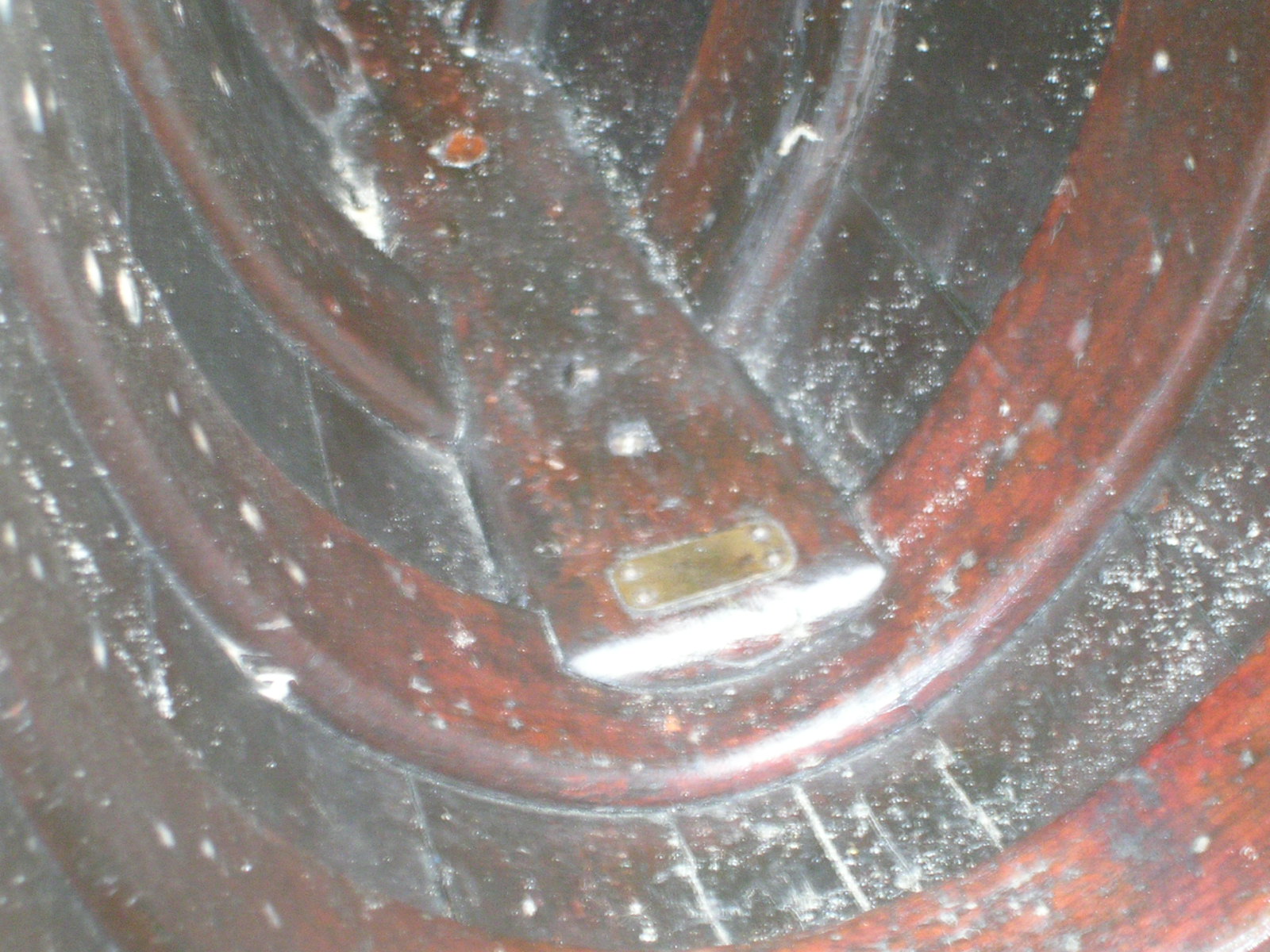

Here are some pictures
Hi,
Here are the pictures, that I said I would send. By the looks of the stem it does have the charteristics of a Morris Canoe as well as the mortised ribs. I am getting the interior paint removed before recanvasing. I will send more picture as the work progesses. Thanks again for your help.

Yes, you have a Morris-- looks very nice. Are the decks 24"? The flag socket on the deck may be from another manufacturer, as Morris flag holders are diamond-shaped... but I will check the catalogs when I get home (am visiting family in Minneapolis).
The painter ring on the stem of the canoe behind the serial number plate is probably original with the canoe--- I think the same form can be found today, but it appears in the Morris catalogs and I've seen it on a number of Morris canoes, in that location.
