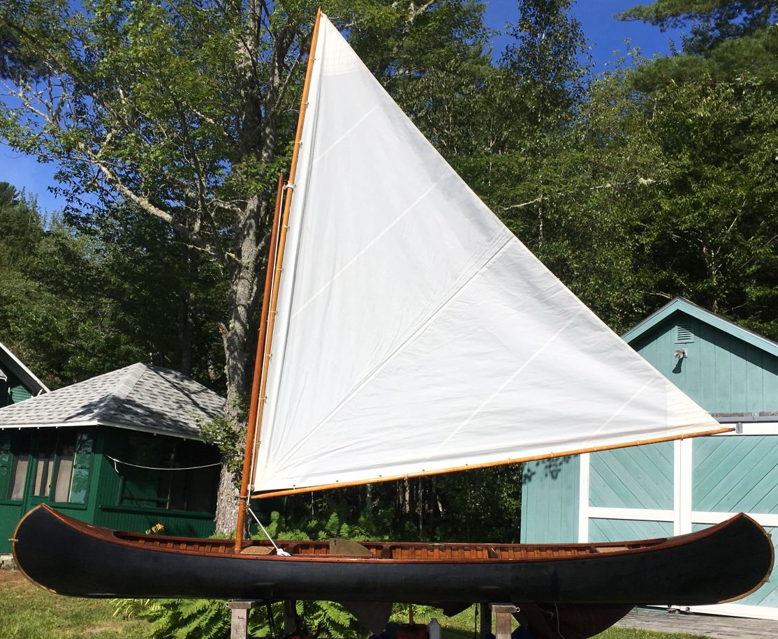

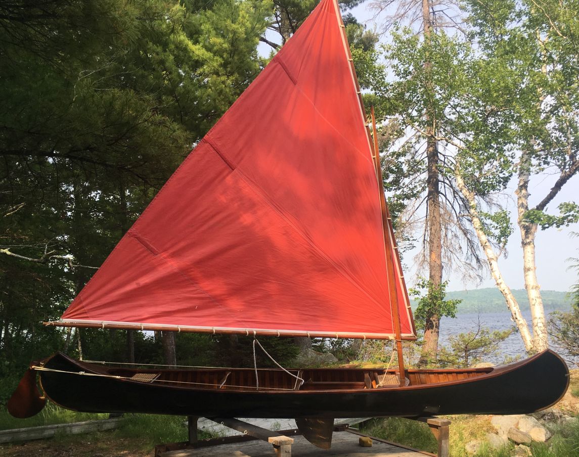

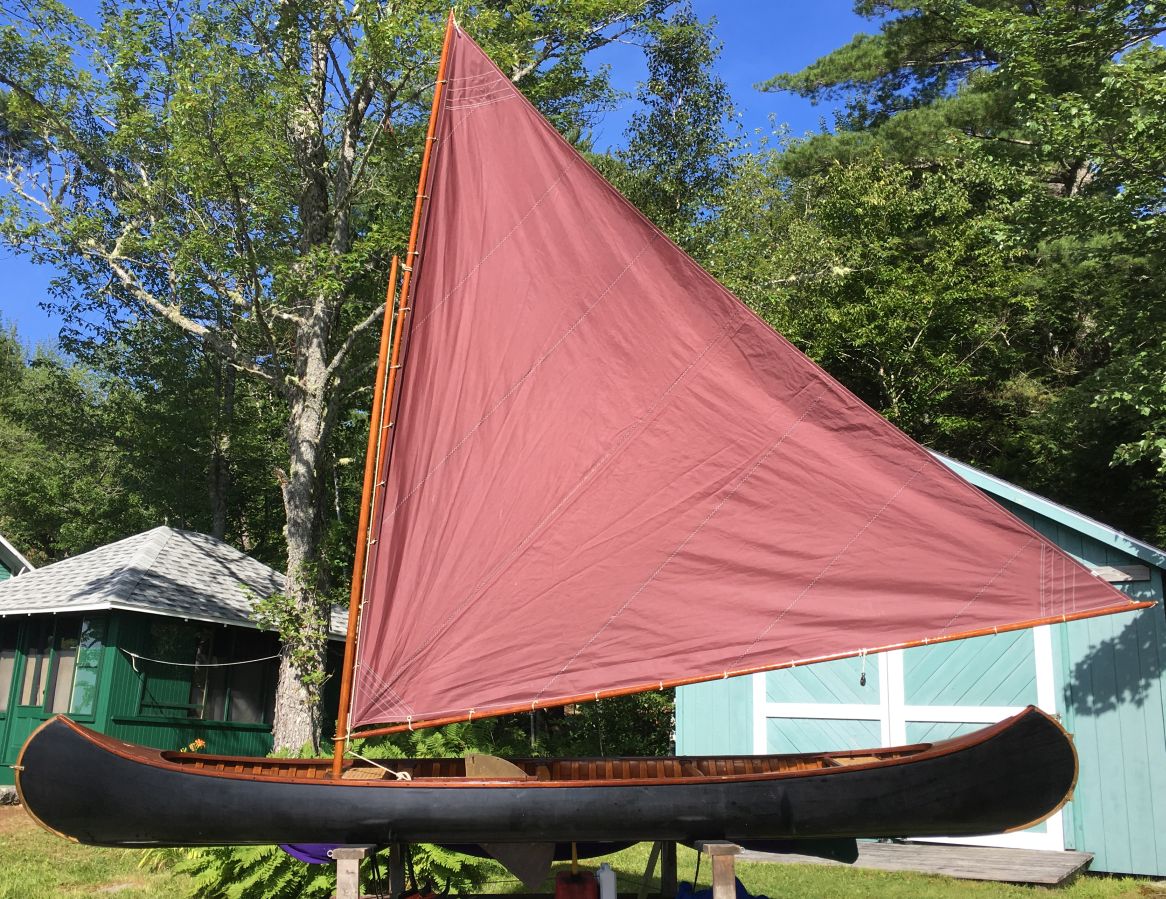

The pictures and information at the first link below show the evolution of the Old Town sail rigs in the catalogs. One from 1913 would have had no rudder. The first rudder was shown in 1917 and the style of gudgeons changed over the years. The stern deck in your pictures appears to have an ordinary case of tip rot. The second link below has some suggestions about how to fix this. The pictures at https://forums.wcha.org/attachments/46941/ plus https://forums.wcha.org/attachments/46942/ and https://forums.wcha.org/attachments/46972/ show how the mast would have looked. I can provide more detailed measurements if you need them. Good luck,
