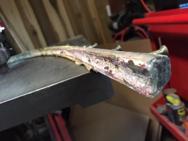

Mostly just out of curiosity I removed one of the outside stems today. It is missing about 3" at the deck. I figure I'll splice it instead of replacing the whole thing. My question is, is it common for the back of the outside stems to to be concave?
In my experience with Old Towns, yes. It makes a good place for the canvas seam and bedding compound.
Thanks Fitz. So when constructing a new stem I could see the benefits and detriments of cutting the cove before bending or after.
Silly question but does anyone have an opinion on which method is best?
