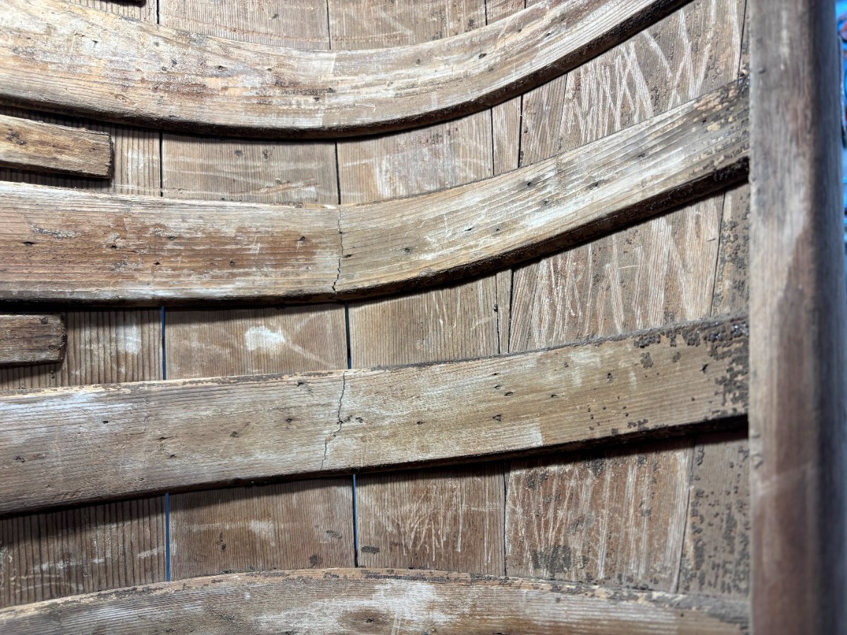

I am working on restoring an old town sn 64558 17. I am wondering what year was made and color or other information on its original configuration.
Picture of the SN

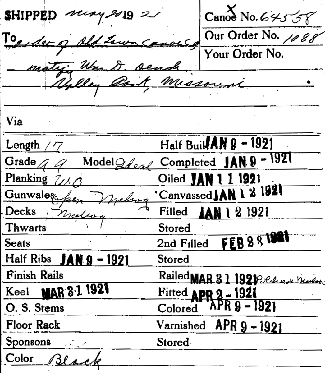

Welcome and congratulations, the Old Town canoe with serial number 64558 is a 17 foot long, AA (or top) grade, Ideal model with red western cedar planking, open mahogany gunwales, mahogany decks, mahogany thwarts, mahogany seats, half ribs, and a keel. It was built between January, and April, 1921. The original exterior paint color was black. It shipped on May 20th, 1921 to Valley Park, Missouri. A scan showing the build record can be found below.
It is also possible that you could have another number or manufacturer this description doesn't match the canoe. Feel free to reply if you have any other questions. Good luck with the restoration,

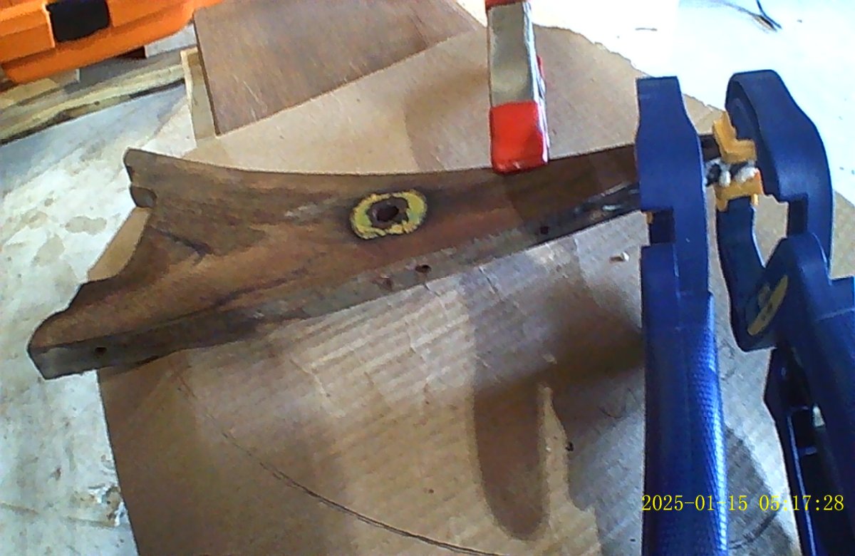

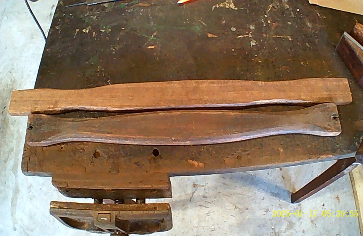

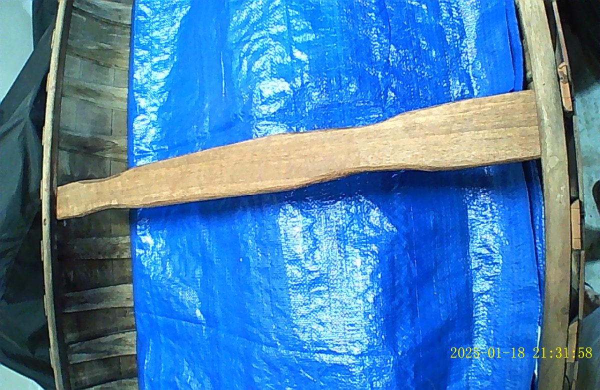

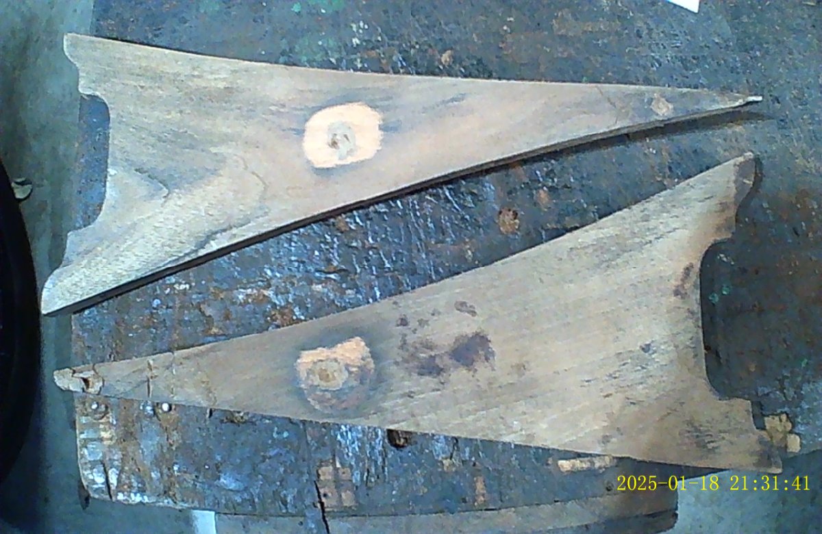

Finally getting into the restoration. I have some mahogany wood for a missing Thwart. Not sure I like how it has turned out. I used one of the other ones as a template. Also, previous owner had added eye bolts on bow and stern that I do not believe are a item on original old towns. I used the sanding dust from the thwart and some wood glue to fill them in. Not sure if I'm going to have to make totally new ones. Attached are photos. Any suggestions or advice is appreciated.

I'd suggest reaching out to someone near you who has an Old Town from this era. Neither of the two thwarts shown in your photo are original. The shape of Old Town thwarts changed over the years, so it would be good to attempt to replicate one from the early 1920s for your canoe. On the other hand, thwarts can be replaced at any time, so if you just want a useable canoe, you can think about this later (if ever).
First, right on for removing those deck abominations. You are correct. They do not belong, although it is not unusual for people to add all kinds of bazar deck contraptions and in doing so, ruin perfectly wonderful decks, or breasthooks as those "boat people" like to call them.
I'd be inclined to plug those holes with some mahogany. You should be able to remove the paste you made and insert a few plugs made from some of that errant thwart wood. If you get the right piece of wood and rotate the grain to match, you should almost be able to make those holes disappear.
