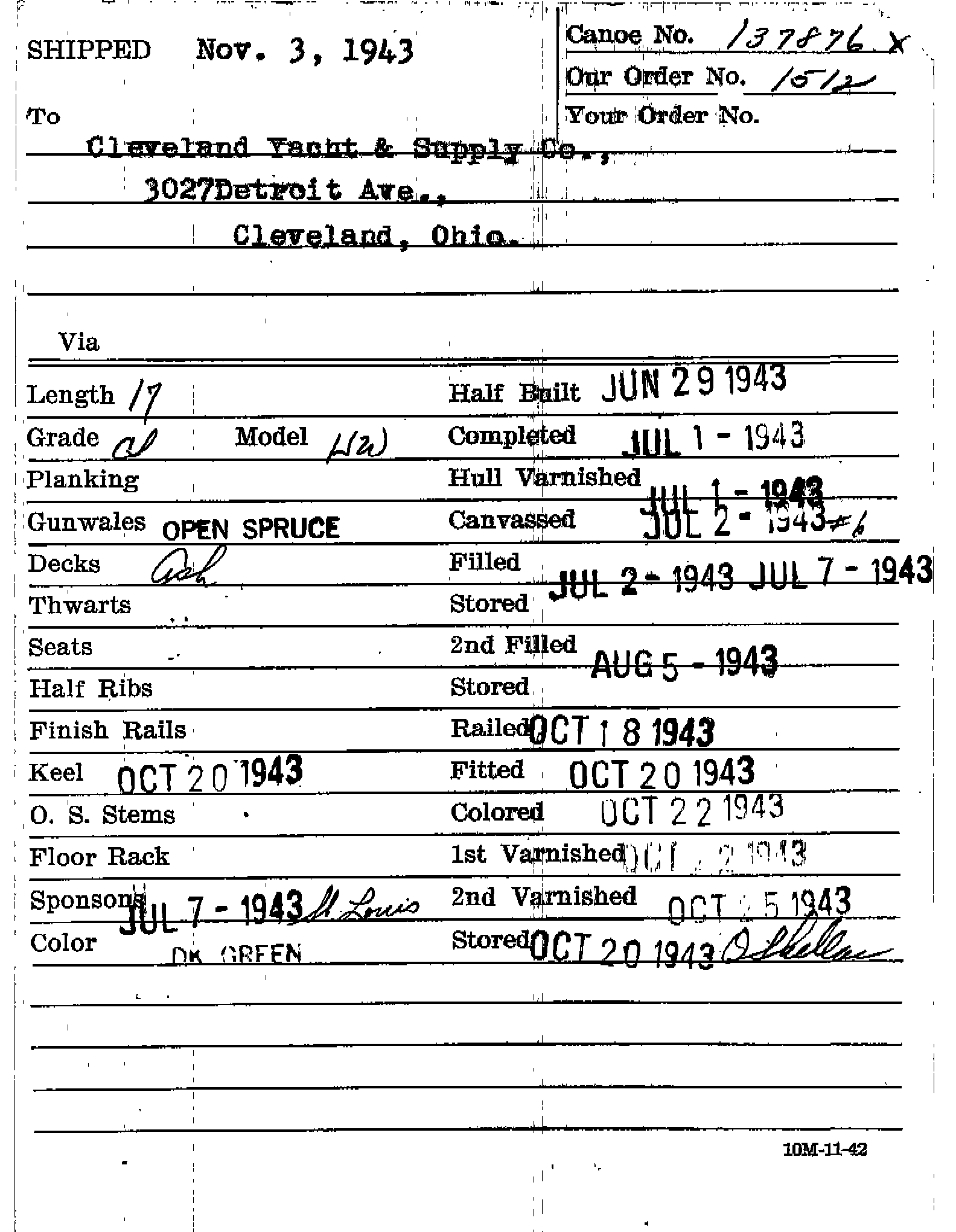

On the build record where the entry for sponsons would have a date when they were installed, it says "St. Louis" with no date. Any ideas what this might indicate?

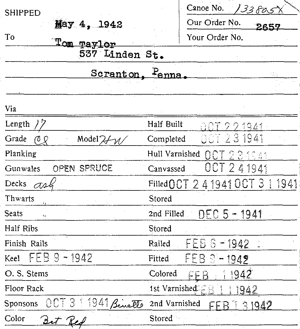

The usual format was to rubber stamp the date when they were completed and then hand write in the last name of the person who did the work. The record at http://forums.wcha.org/attachment.php?attachmentid=3168&d=1184590772 shows that the sponsons were added on July 7th, 1943 by Mr. St. Louis and http://forums.wcha.org/attachment.php?attachmentid=4144&d=1203040968 shows some that were done on October 31st, 1941 by Mr. Binette.
Occasionally the ink pads would run low and the stamped numbers are very light with a low contrast. These would not appear on the black and white scans so only the hand written part would show up. You can see an example of this in the "Hull Varnished" line on the two images of the same build record attached below. Color scans are significantly more expensive than black and white ones. The original preservation project could not afford to do everything in color.
Please reply here again if this doesn't answer your question.
