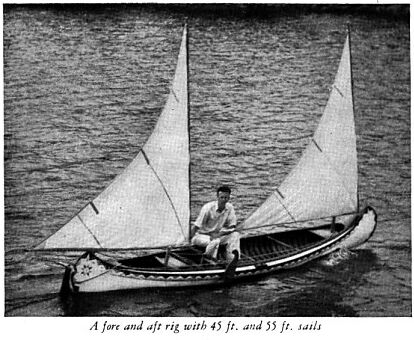

My guess is that it had a pair of lateen rigs like the sailing canoes as shown at http://forums.wcha.org/attachment.php?attachmentid=1665&d=1151334414 but it could also have had gaff rigs like the dinghies. The Sail Sled records that I have seen are all from 1929 which is before most of Old Town's more unusual sailing experiments.
John Alden designed an interesting decked canoe for Old Town with two sails in 1932 as shown in the image below and another twin sail design is shown at http://forums.wcha.org/attachment.php?attachmentid=1066&d=1136757320 from some company records in 1931.
