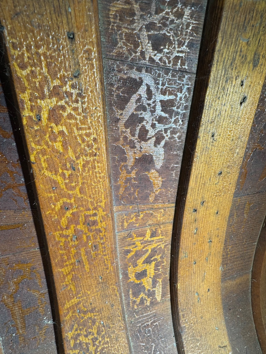

When you described the sanding process to be difficult and that the varnish seemed gummy, that suggested the possibility. I am not sure how I can explain the difference to you. I can tell based upon many years of dealing with both. You can most certainly tell when poly fails due to water getting behind it. It tends to bubble and peel in layers. Spar will dry and flake, or alligator.

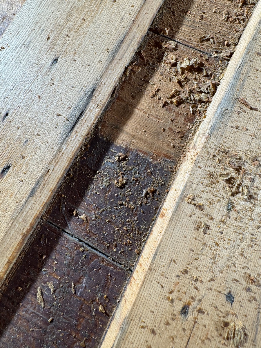

if it helps, here's what the finish looks like, including where I've scraped it, so you can see the texture of what I've removed.

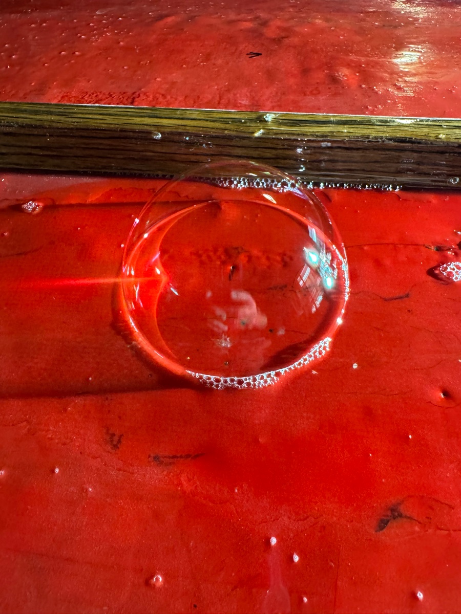

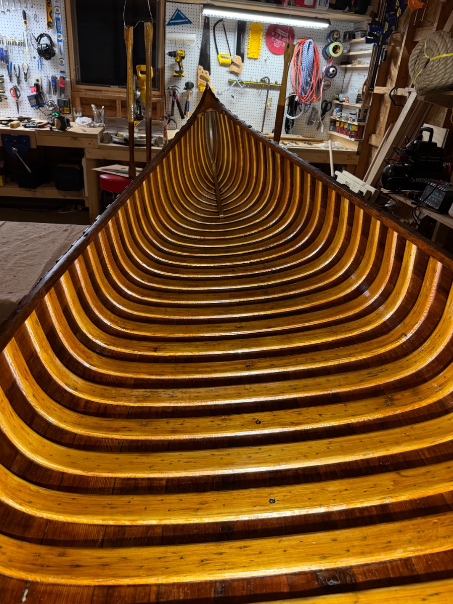

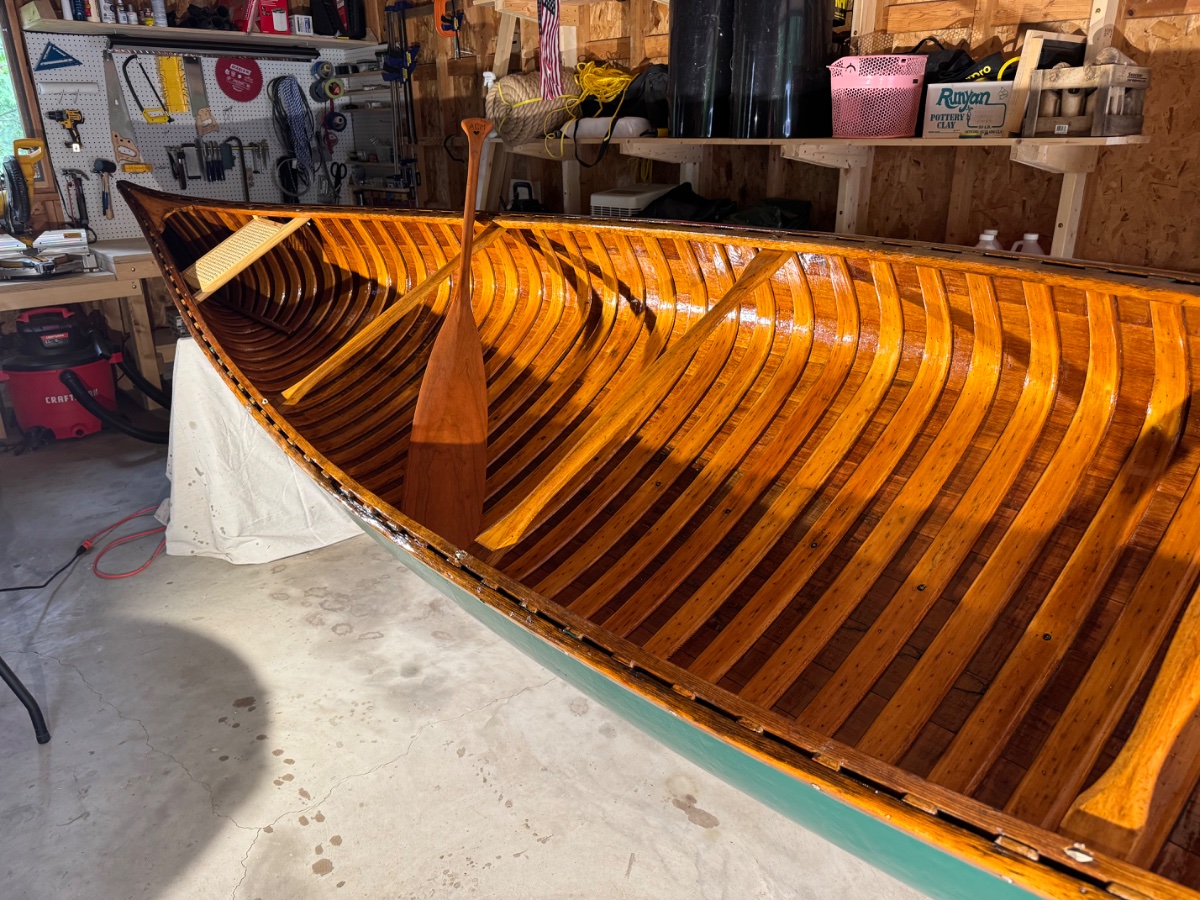

I'm making progress. before painting I thought I'd better check to see if the fiberglassing and epoxy had caught all the holes but I'd missed one. it was tough to find given all the potential spots, but I adjusted the vacuum so that it blows out, and had my wife sit under the canoe with the wand testing various spots while I put soapy water on the hull - found the culprit, but this delayed painting while the additional fiberglass/epoxy cures. however I did finish the scraping/sanding of the interior and put what I expect is the last coat of varnish on this morning. As recommended by Dave - I did 50:50, then 75:25, then 100:0. The character accumulated over 84 years was really brought out nicely with the finish. We are off to Temagami tomorrow to pick up my son from his adventure canoeing north to James Bay and then up the Moose River. There's a canoe company originally operating from there that you probably all know about.

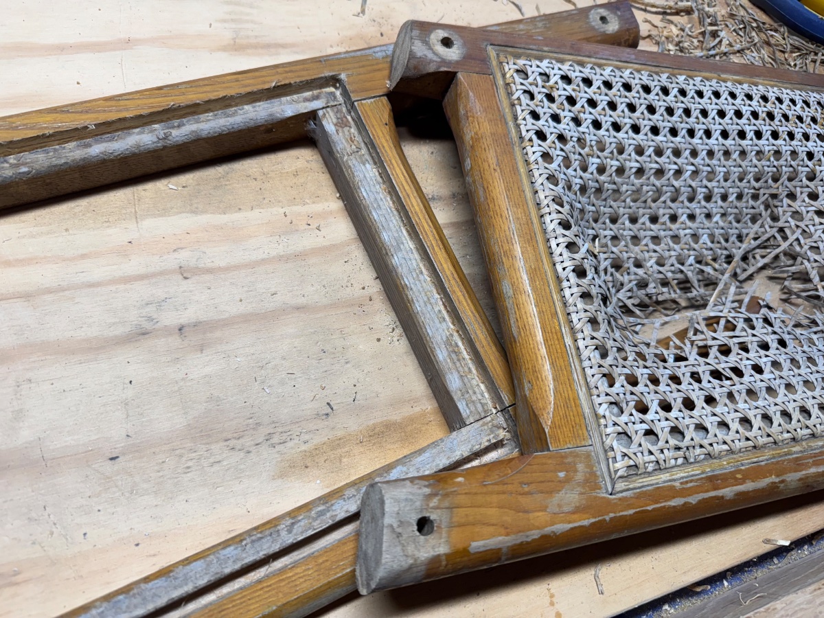

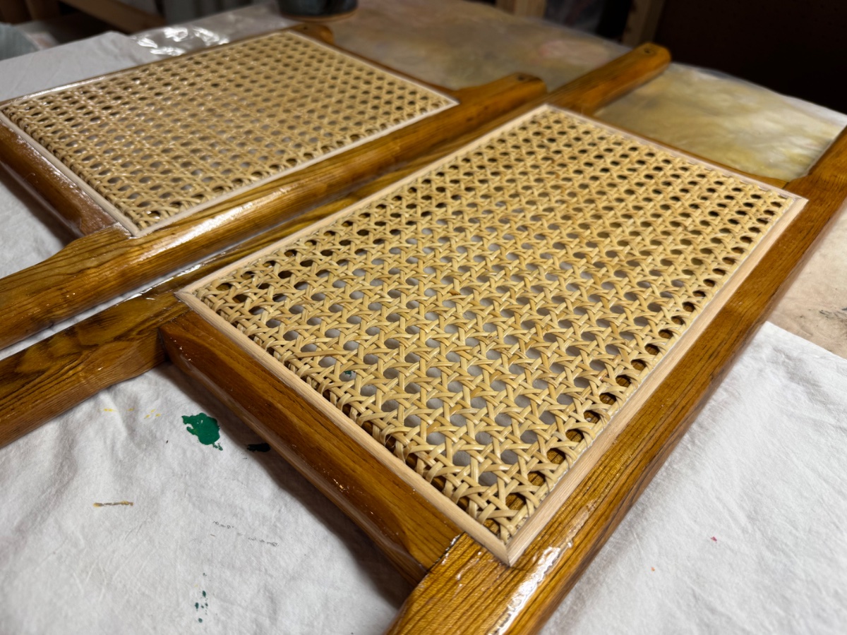

I hope someone is still out there following this thread as I could use some advice. I wasn't that happy with how the purchased new seats matched the canoe, and I was interested in how to recane the seats, so I stripped out the old caning, and tried my hand and adding new rattan. My question for you wise ones is how to best protect the new caning. I've read not to put spar varnish on it because it'll make it brittle, but I've also read to put it on, especially with a thinned first coat. I've also read boiled linseed oil or tung oil, with annual reapplications. Any advice out there on best practices?

Years ago this question generated some heated responses in this forum. Old Town traditionally did not varnish their cane seats. The link below and others have more details. Your mileage may vary...
Thanks Benson! Very helpful. I'll do the top surface and see how how well it holds up. Life is full of experiments!
