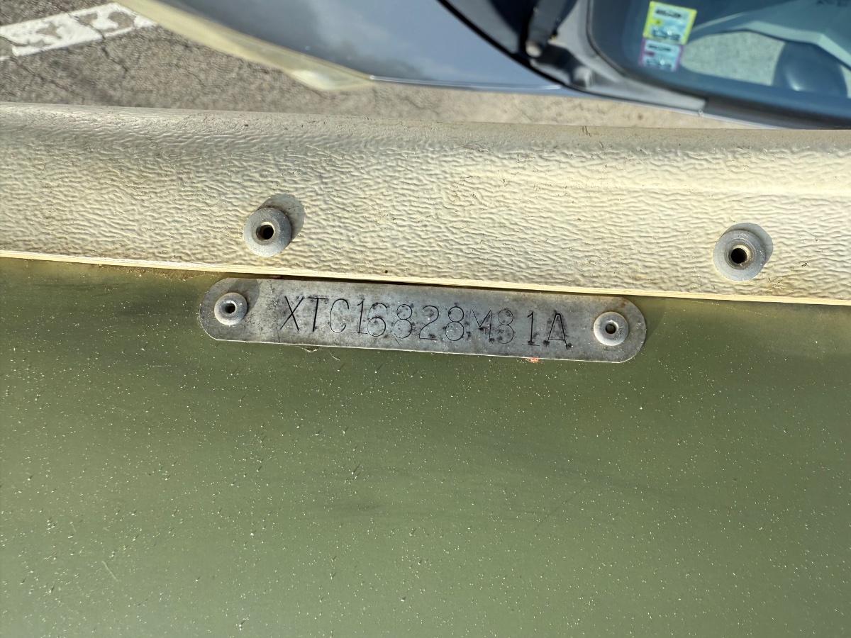

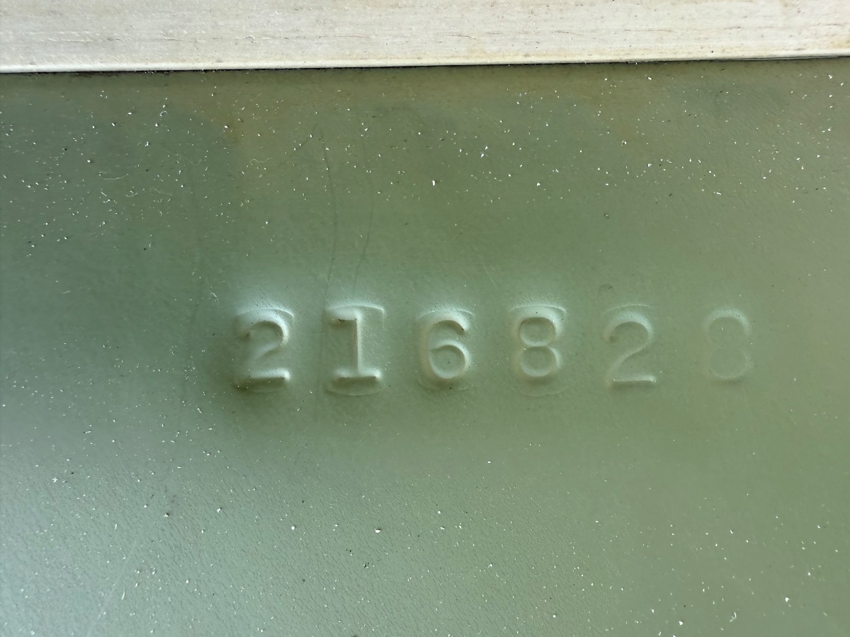

Hi there I’m new to the forum and I’m trying to get a date and model of a used Old Town Canoe I just bought. The number stamped into the plastic is 216828. The number on a plate is XTC15328431A. I was told it was Royalex Pathfinder from1980. Thanks in advance.

Got the serial number wrong here is the correct one XTC16828M81A. From what I gleaned from the google the year it was made was 1981?
Welcome and congratulations, the Old Town canoe with serial number 216828 and hull identification number XTC16828M81A is an 15 foot long Chipewyan Pathfinder model that weighed 65 pounds with aluminum inserts in the rails. It was built in March 1977. The original exterior color was avocado. It shipped on August 20th, 1980 to Pittsburgh, Pennsylvania. The back side indicates that it had some scratches on the inside along with skuffs and scratches on the outside of the hull on the bottom. Scans showing both sides of this build record can be found below.

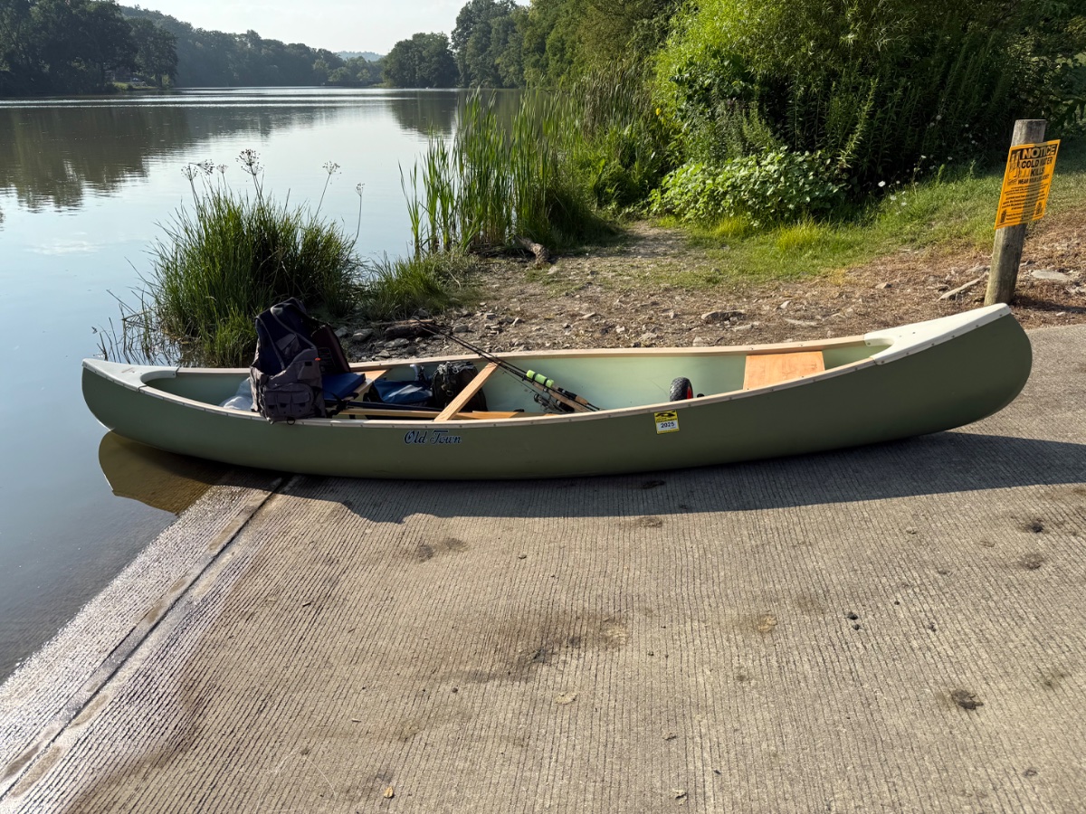

This will help me tremendously trying to restore the seats and portage yoke. It also needs a skid plate to cover where it was dragged
tbonebell, skid plates are easy to do, but be sure you get bias tape instead of plain fabric. That way it will follow the curve easily. Check out West Systems (Gogeon Brothers) or Jamestown Distributors for epoxy and good advice on doing it.
That canoe is well worth fixing!
Bias tape? I thought Kevlar fabric with G-Flex 650 was the way to go? At least that’s what I’ve seen on YouTube.
You can make regular fabric work, but it won't follow the curve of the stem unless you cut it on a bias, i.e. diagonally. So you will waste a couple yards of fabric just to get a thin strip. And Kevlar is really hard to cut.
G-flex is a good product, but I would visit the West Systems (Gougeon Brothers) website to make sure 650 is the right one.
