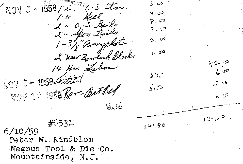

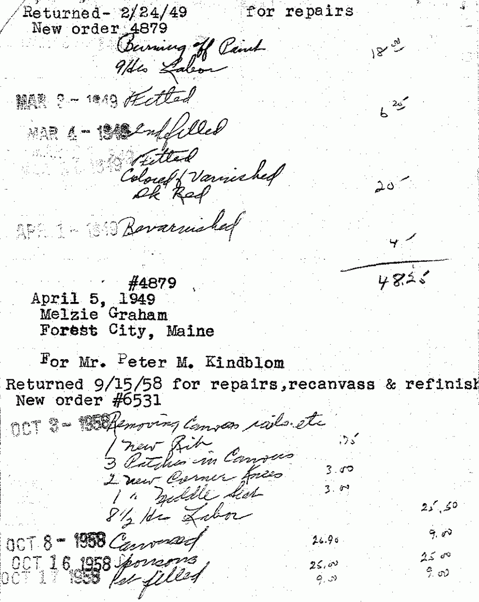

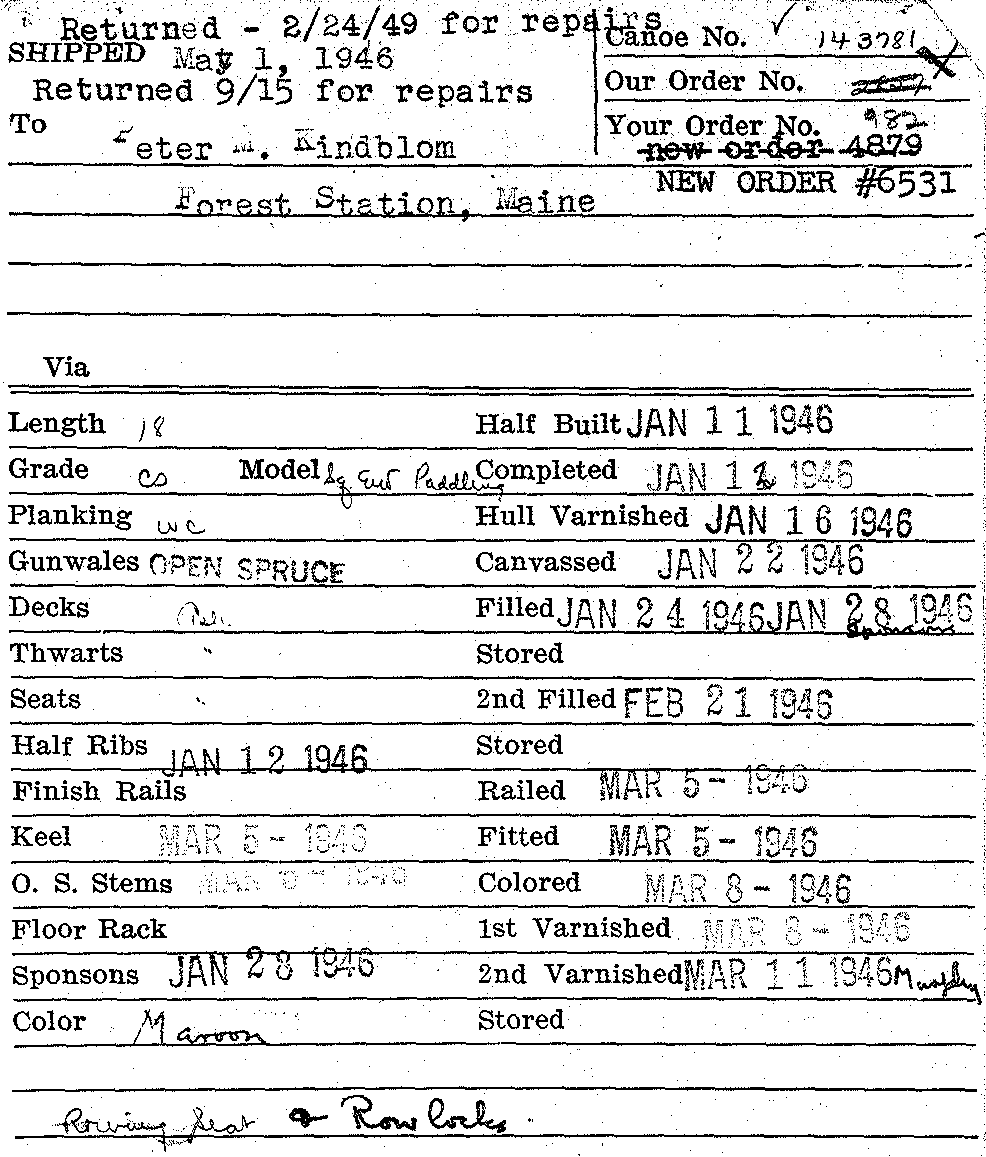

Shipped 1946 to Forest Station, Maine, CS grade. Returned in 1949 and 1958 for repairs. Shipped 10JUN1959 to Mountainside, NJ. There are several documents. Looks like a nice canoe. Benson should be able to attach copies. Congrats.
The Old Town canoe with serial number 143781 is an 18 foot long, CS (common sense or middle) grade, square end paddling model with red western cedar planking, open spruce gunwales, ash decks, ash thwarts, ash seats, half ribs, a keel, outside stems, sponsons, a rowing seat, and row locks. It was built between January and March, 1946. The original exterior paint color was maroon. It shipped on May, 1st, 1946 to Forest Station in Brookton, Maine. The back side of the card indicates that it retuned on February 24th, 1949 to be repainted. It came back again on September 15th, 1958 for repairs, recanvas and refinishing. These were finished on November 13th, 1958 and it was picked up on June 10th, 1959. Scans showing all of these build records can be found below.
