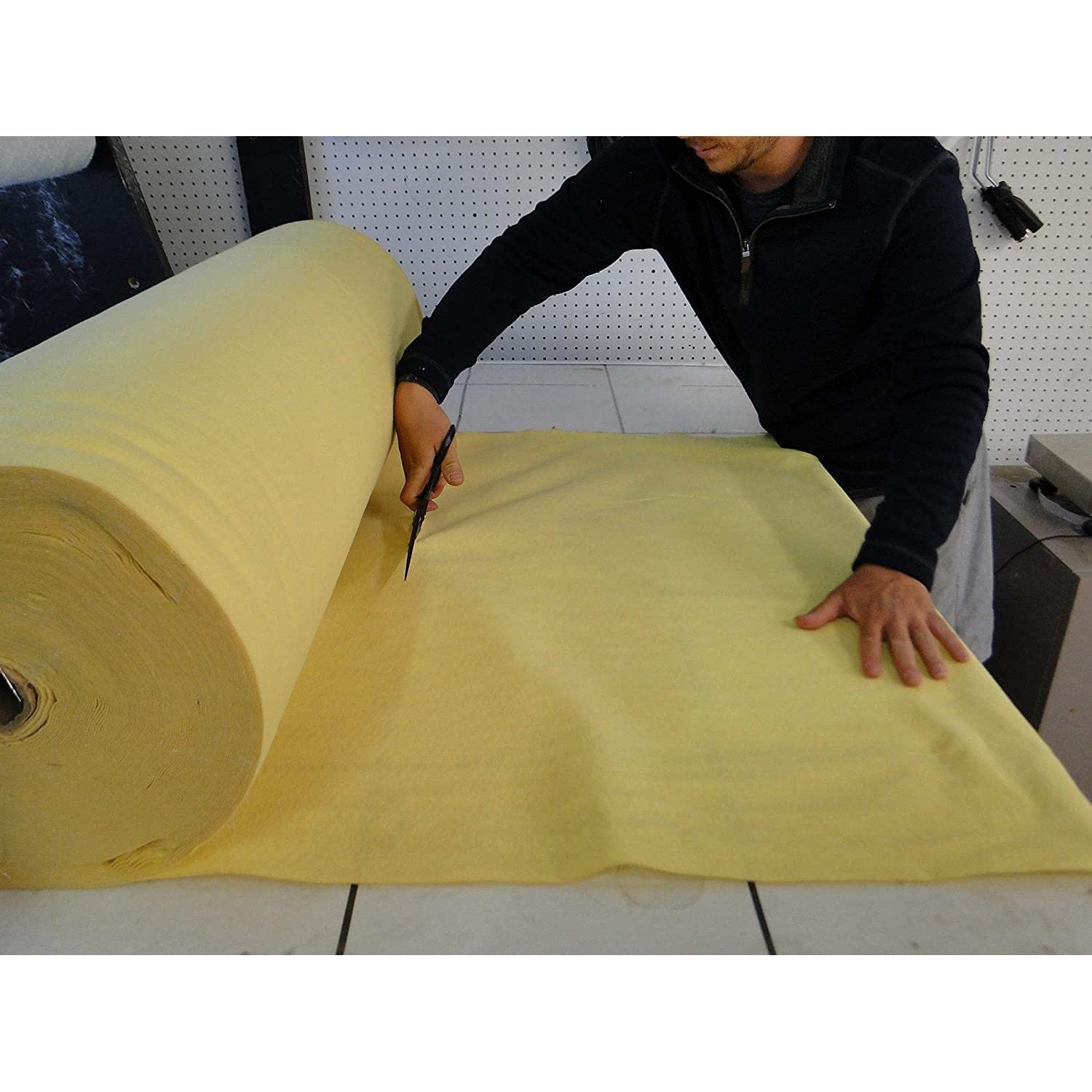

I would suggest not using the tape in lieu of felt for this repair. I have repaired dozens of these over the years and have tried everything you might imagine. If you ever loaned one of these to a Boy Scout troop, it would look about like yours, shot.
Fiberglass should not be used. Use Kevlar felt or an old polar fleece.
Tape should not be used, use felt.
The reason that you should use felt is that you will be able to make it conform to the damaged areas and hull. Tape will not attach and will lift. Glass or Kevlar cloth will do the same. It will lift and leave pockets.

Yes, Kevlar felt set into a flexible brand of epoxy resin (Gougeon G-Flex or equivalent) is the proper repair, rather than woven cloth. The canoe's initial construction is actually colored vinyl skins inside and out, over ABS plastic layers, inside and out, over a foam core. This is different from the cross-link polyethylene, 3-layer foam-cored canoes which Old Town makes these days. 'Oltonar" (which is what Old Town called their Royalex) made somewhat lighter boats and could be selectively reinforced with extra internal layers in places. That being said, the Tripper model in particular had a high-wear area at the bottom of each stem due to the hull shape, which you can clearly see on your boat. If ignored, it would wear all the way down and through the foam core. A strip over the stem is the only truly durable way to stop the abrasion for good. When they first came out with the repair system, Wendall Tremblay (Sales Manager at the time for Old Town) told me they hung a Tripper out the back of a truck and spent half a day dragging it around town, dragging the stem on the pavement and it survived. Fiberglass would have worn through easily in a minute or two. Woven Kevlar not long after. The felt, being thicker, Will get fuzzy when abraded, forming an abrasion-resistant surface that is really tough. You wash the area, then run a touch quickly over the area (you aren't trying to melt the plastic or even really heat it. Just flick the blue part of the torch flame over it which does some sort of scientific mumbo jumbo to the surface, like polarizing it for better adhesion). Apply the felt with the resin, saturate it well and as neatly and smoothly as possible (remember it's Kevlar and just fuzzes when you try to sand it), let it harden and you're good to go. A coat of paint is also a good idea once done, to protect the epoxy from UV.
