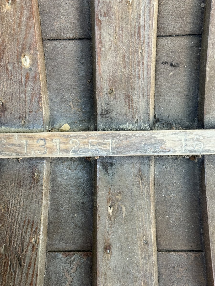

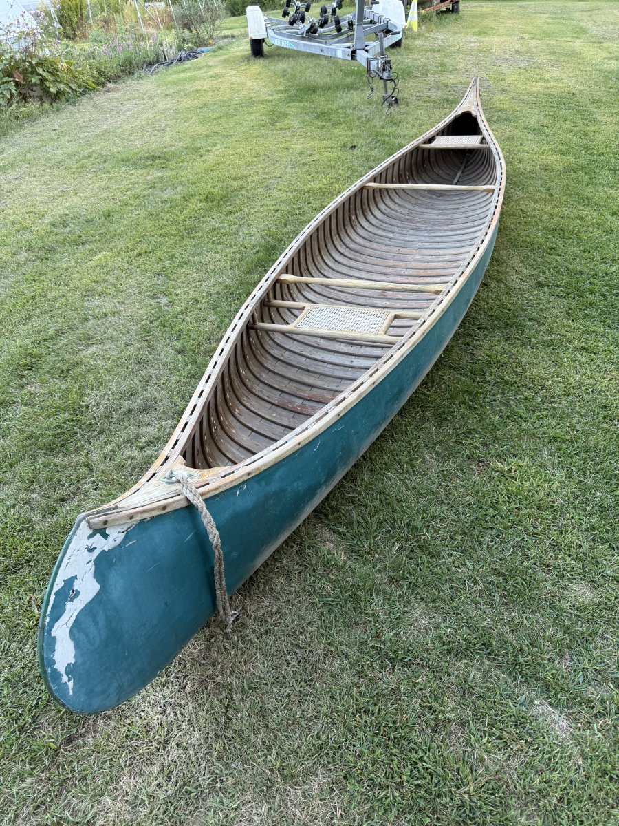

This fell in my lap today and I would love to know its history. Very solid condition, just needs new canvas.
You've got a nice-looking 1940s Old Town there. It's in great shape compared to most. Consider doing more than just re-canvassing. The interior and trim would REALLY benefit from a complete stripping and re-varnishing.
The white spots on the interior are salt halos or salt blooms (two terms for the same thing) - evidence that salt water has been corroding the fasteners. The corrosion breaks don the surrounding wood, so now water can get into the wood much more easily, especially with old, failing varnish. A thorough stripping and cleaning with water rinses will remove residual salt from the wood, will lessen or eliminate the white spots, and will allow you to do a great varnish job that both you and the canoe will greatly appreciate.
Your salt halos are not bad at all - they come much worse. But still, refinishing the interior will make this a much better and much more beautiful canoe. Search these forums - no need to repeat everything again in this thread but there is a ton of advice on these forums, and some great restoration books in the WCHA's store. See:

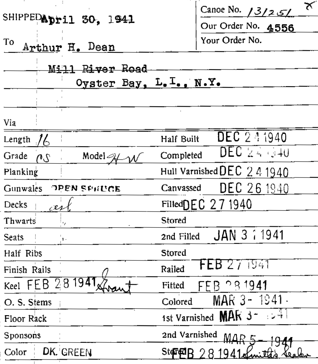

Welcome and congratulations, the Old Town canoe with serial number 131251 is a 16 foot long, CS (Common Sense) grade, HW model with open spruce gunwales, ash decks, ash thwarts, ash seats, and a keel. It was built between December, 1940 and March, 1941. The original exterior paint color was dark green. It shipped on April 30th, 1941 to Oyster Bay, Long Island, New York. A scan showing this build record can be found below.
It is also possible that you could have another number or manufacturer this description doesn't match. Feel free to reply here if you have any other questions.
This is great, thank you. Woman who gifted me the boat is the grand daughter of original owner. Boat is in really good shape other than needing new varnish and canvas. Looking forward to getting this boat back out on the water.
