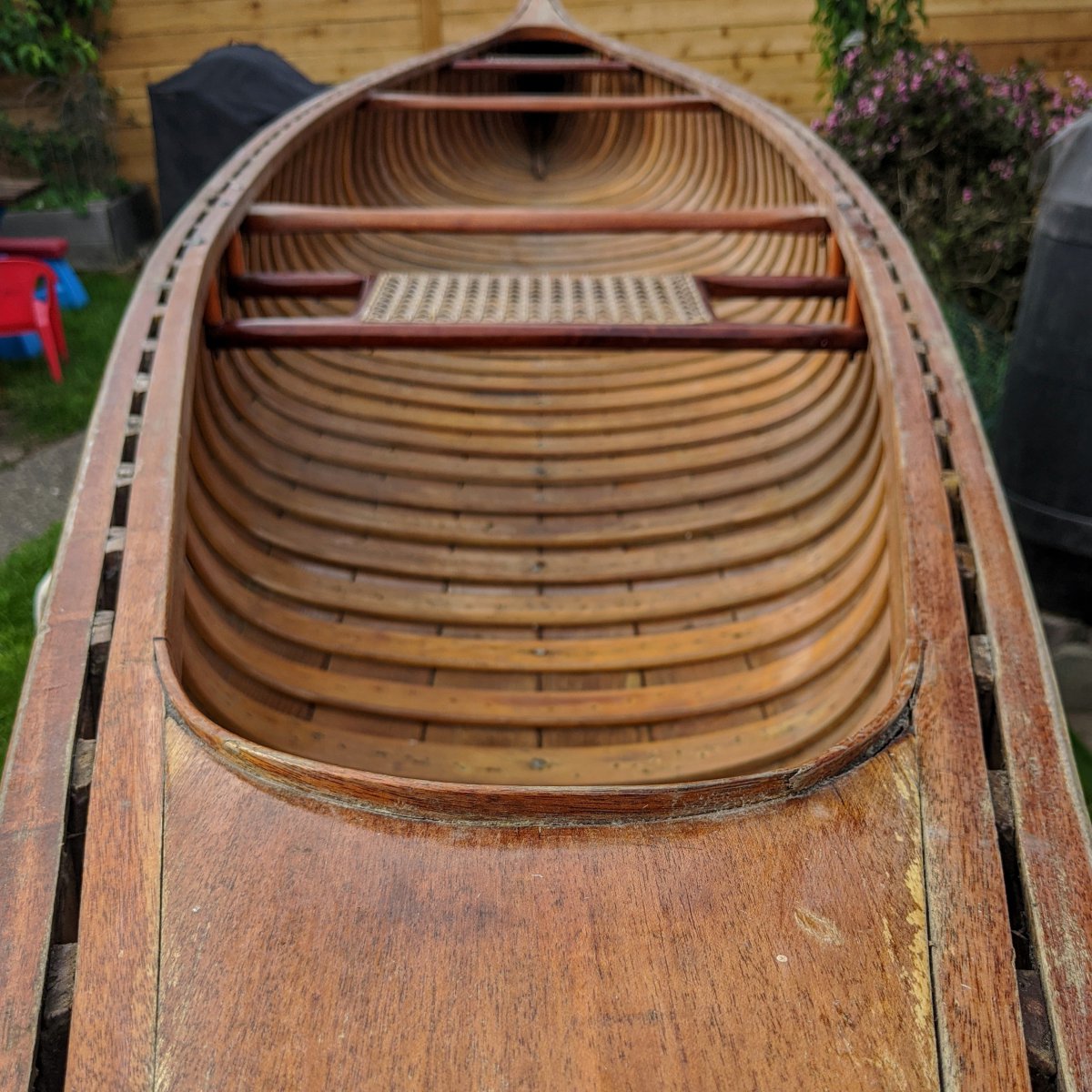

Here's a quick question for starters though: the Otca doesn't have a center thwart or yoke at the balance point. I generally prefer to solo portage. Is that something I can/should add? I'd also like to build several wannigans for camping and am wondering if I should add some half ribs for a bit more strength underneath.
I'll add a few photos here too.

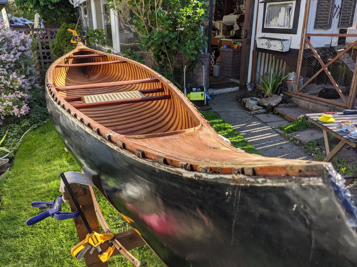

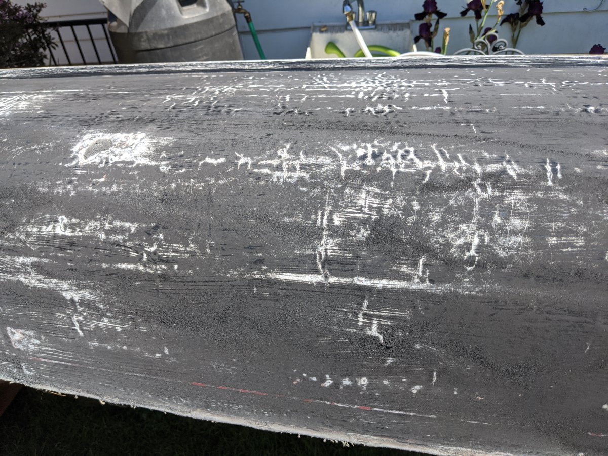

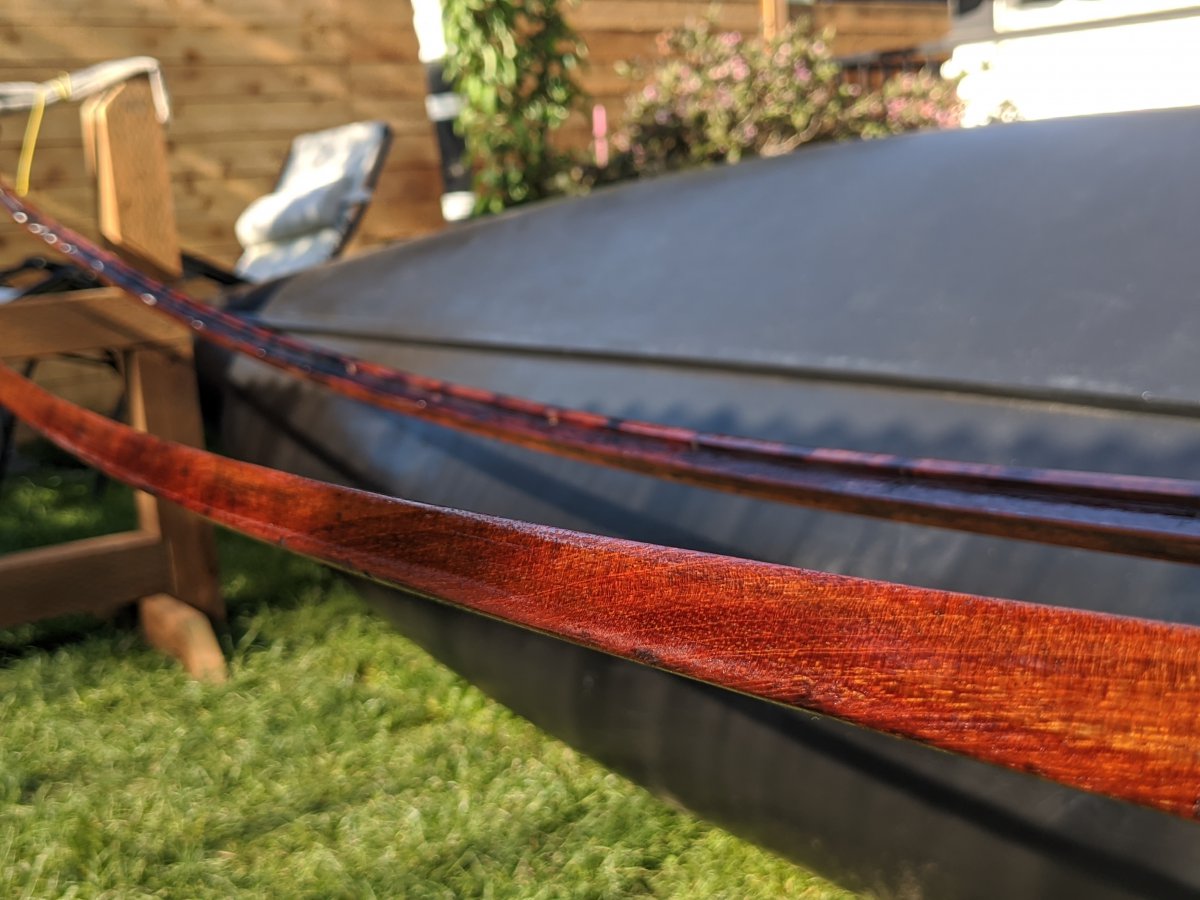

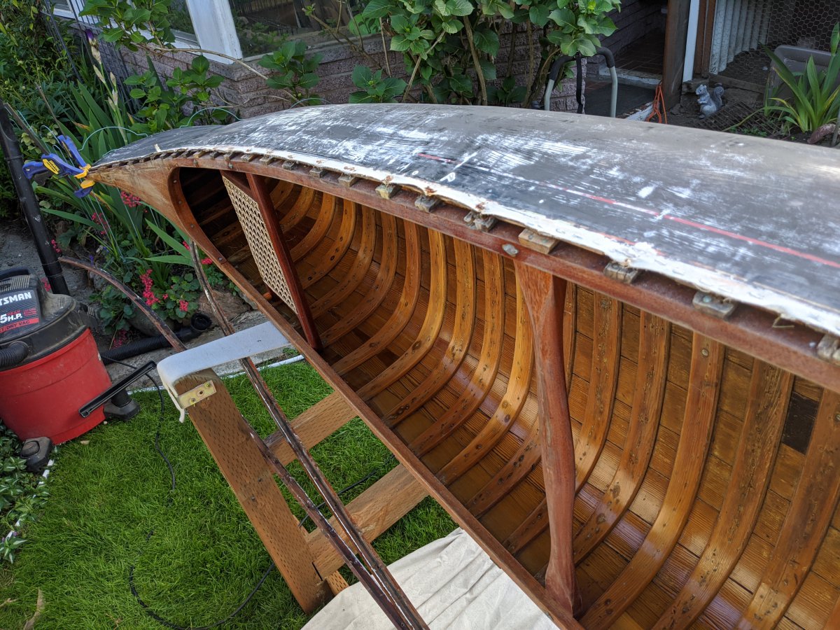

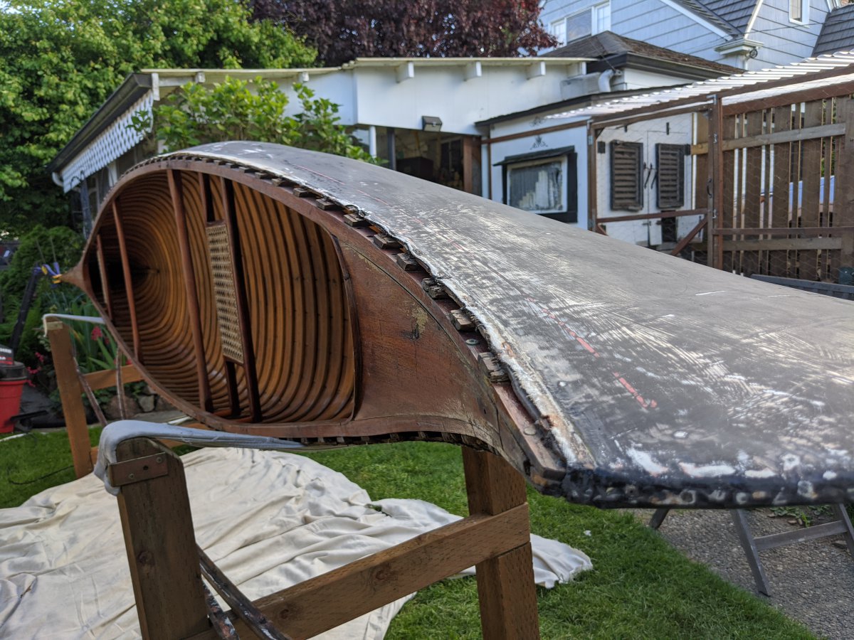

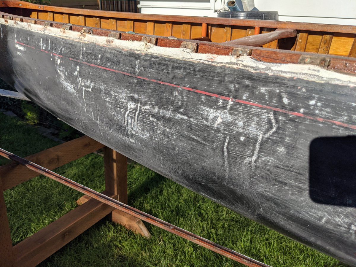

Few more pictures. Took off the outwales and started the first exterior sand. I'm doing the lazy option for this season and just slapping paint onto the old canvas and new varnish over the fading layer inside.

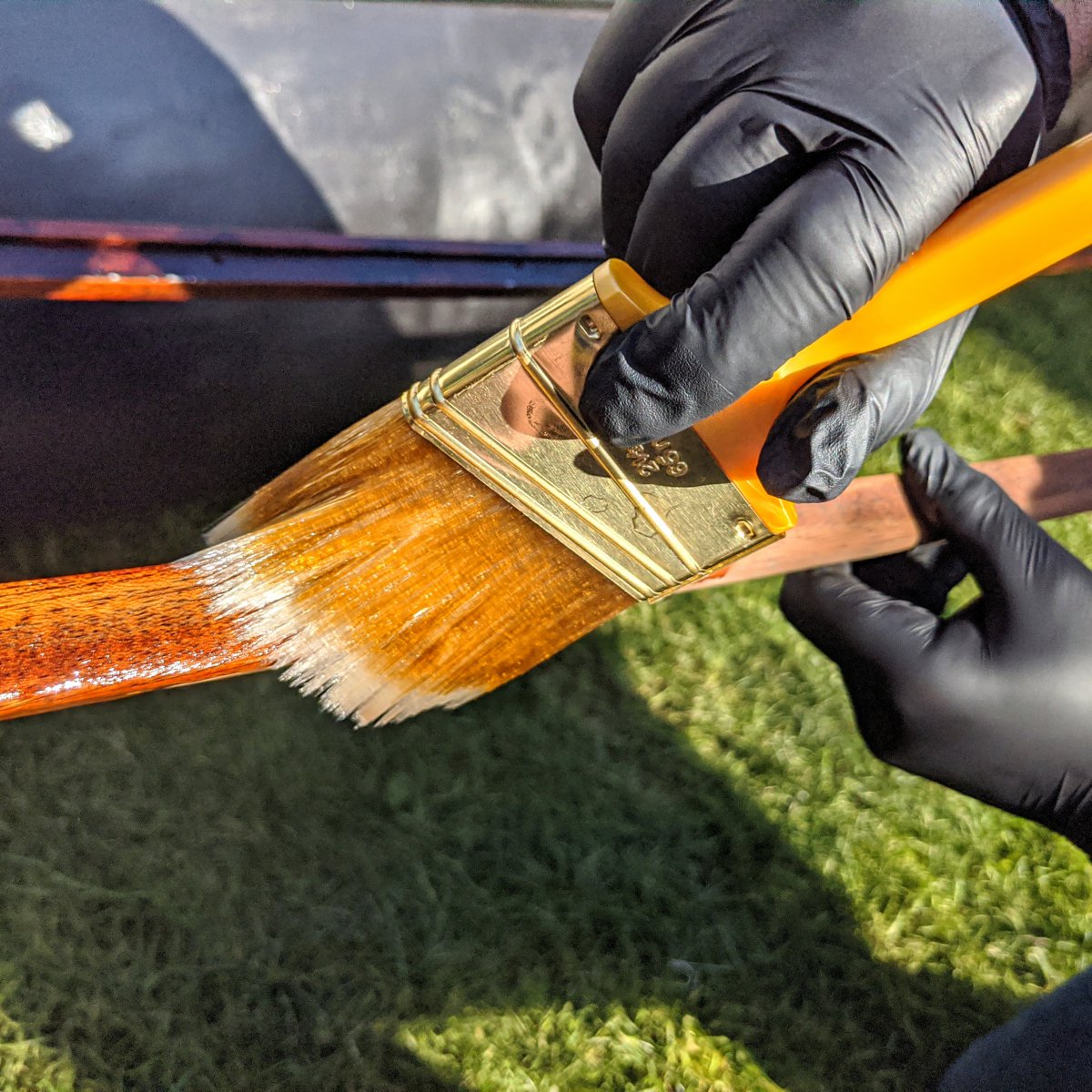

I decided to paint first, varnish second, but am open to recommendations for the reverse. I thought maybe better to overlap varnish over paint at edges, and it would be worse to have paint drips on new varnish than the reverse?

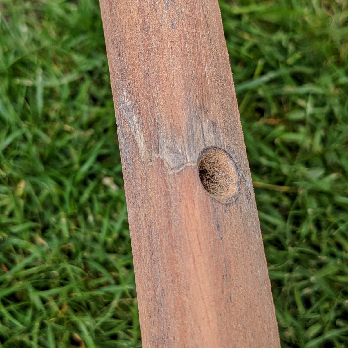

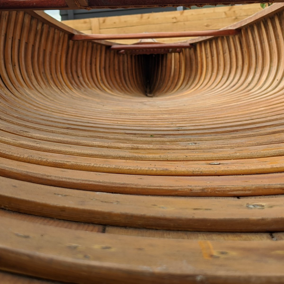

There are a few spots of rot at the tips of some ribs. I'll scarf in fresh wood over the winter but for now will probably add a little epoxy. Maybe it's better just to leave as is for now? What do you think - if it's only for a season does it make sense to put in some epoxy filler or will I just be giving myself a headache a little way down the road...
I did add a few drops to the gap in the stern deck and clamped things down as I was sanding.

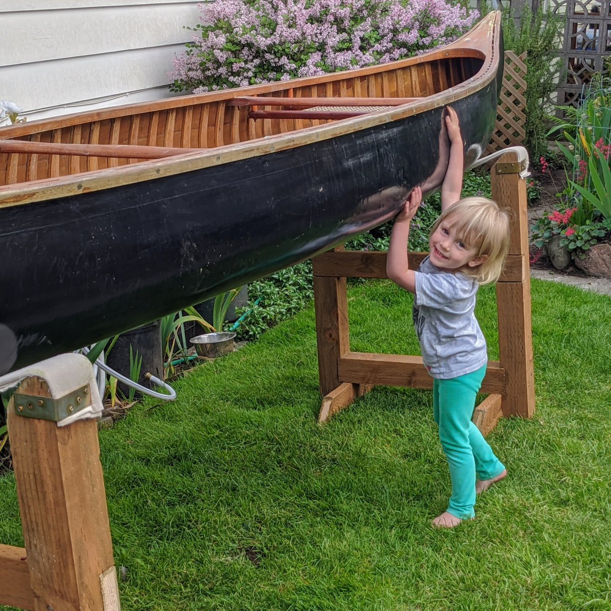

That is going to be a great Canoe. I'll be watching your progress. Nice canoe hauler too! Did you say what color you are going with?
Norm
Hey Norm, Thanks! Your hauler looks just as good. Gas milage is terrible with the '72 suburban but it does look nice under a canoe.
I'll stick with recoating in the original black for this season but most likely will change it up after recanvas.
The black is... interesting. I
have owned black cars and they are a pain to keep looking clean. There's also the fact it heats up so fast. I love the classic green but maybe an off white or cream? I'm a fair hand with a brush so I'll probably make up a trim design at some point. Might ask the forums for input on a few different pinstripe or graphic options.

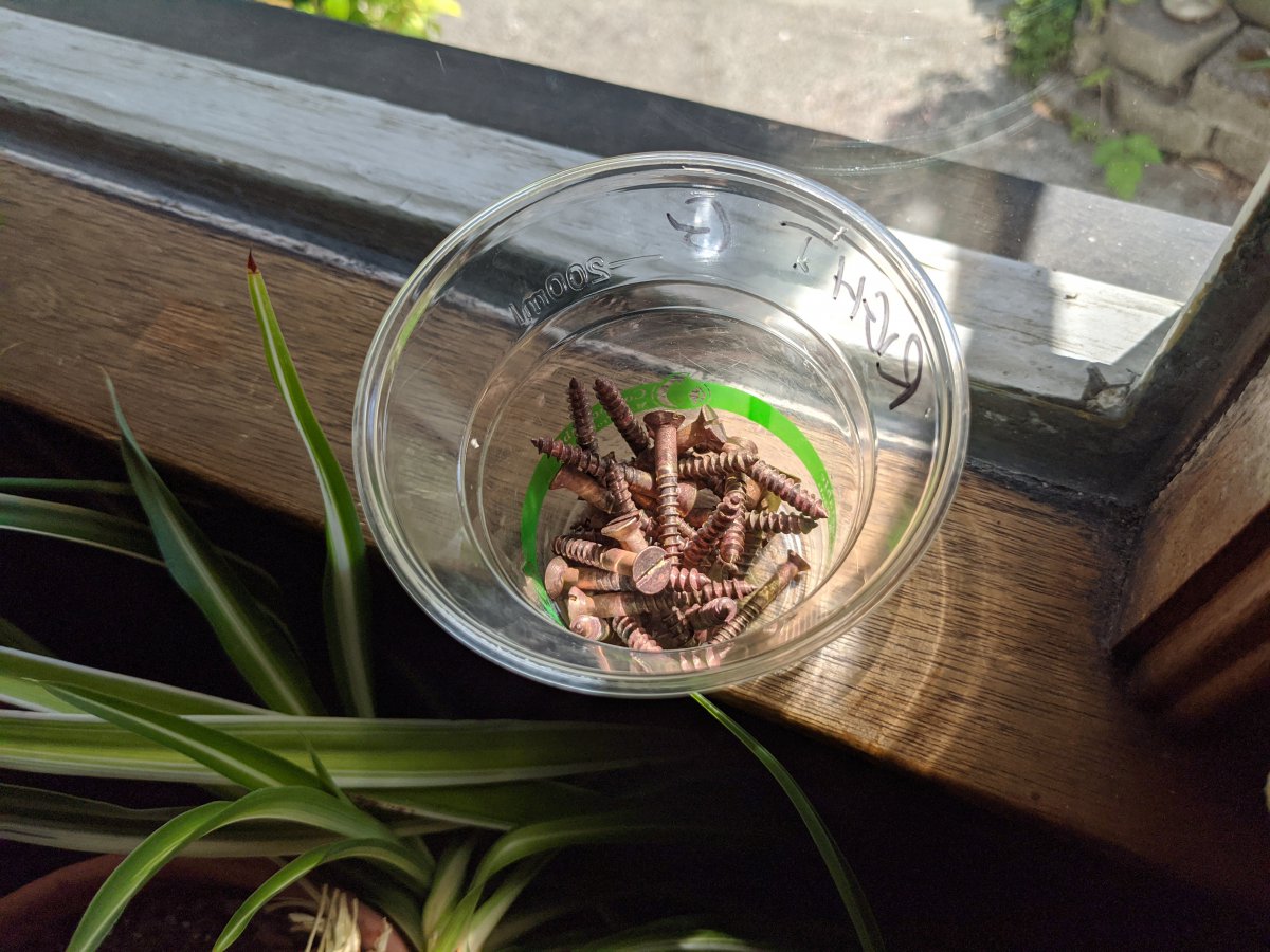

Question: Should I try to clean the old brass fasteners or just replace them? I've read baking soda and salt, followed by lemon juice can work.
Anyone spent the time to freshen up used fasteners? Worth the effort?
I save, clean, and re-install all the brass that is not damaged. Heads of screws or bolts get polished on a buffing wheel. Hacksaw blade gets run thru the slot to clean it. Once shiny, a shot of spray lacquer to the head, and install. TM..
If you have a friend with a rock tumbler or a reloader with a similar tumbler for shell brass they can restore your screws nicely with little effort.
Thanks guys! I lost two that stripped out in the slot as I removed them but all the rest are totally salvageable. I'll ask my lapidary buddies if I can borrow a tumbler.
Quick shout out to Jim Clearwater for sending me plans for a removable carrying yoke made from a motor mount. Great solution.
I find the old screws are much better quality than the stuff you can buy today.
Not only that, the sizes are not the same. There are significant variations if you measure them. I save all boat brass and re-use it if it's in decent shape. I do not like to polish up the old screws. They have a patina that is impossible to duplicate. I clean them, give them a very light buff, repair the slots if necessary and then re-use them. I try to move screws with bunged up slots to places where I don't need to turn them very hard to install them. I use a bit of bees wax or soap on the threads..and pre-drill. Always try to select the correct driver bit to fit the screw slot...they are not all the same! An undersized driver bit will slip out of the slot and wreck it. It's inevitable that you'll need to replace some screws and if you don't have the right ones in your "collection", you may need to buy some new hardware. I've had pretty good luck with the bolt depot...https://www.boltdepot.com/Wood_screws_Slotted_flat_head_Brass_6.aspx?nv=l

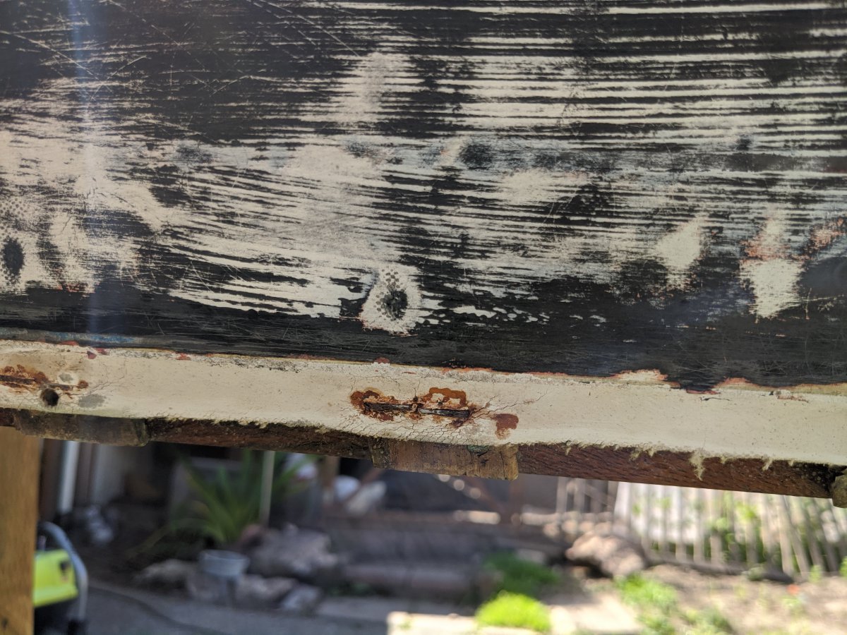

Thanks MGC. I'm also finding some sneaky little staples somebody wicked used on the canvas. Corroding, obviously. I'd be more upset but this canvas will be pretty temporary. Hoping the wood underneath isn't too damaged by the oxidation.
The paint I'm removing is awful. So many drips and brush marks and thin spots.
Staples are standard. these days, though those of us who feel sorry for future restorers will use stainless steel or monel staples. One former WCHA president, now on the other side of the grand portage, once said using steel staples was no big deal, as by the time they rusted out, he'd be long gone (guess he was right :( )
I guess the staples aren't a major problem, but I do see half dollar size patches of rust that are forming around some of them. I think the corrosion is acting like a fricative between the canvas and the wood, to the detriment of both. I suppose traditional methods have drawbacks too, and these staples date back to the mid nineties: so they worked ok for 25 years. They will be easier to pull eventually too...

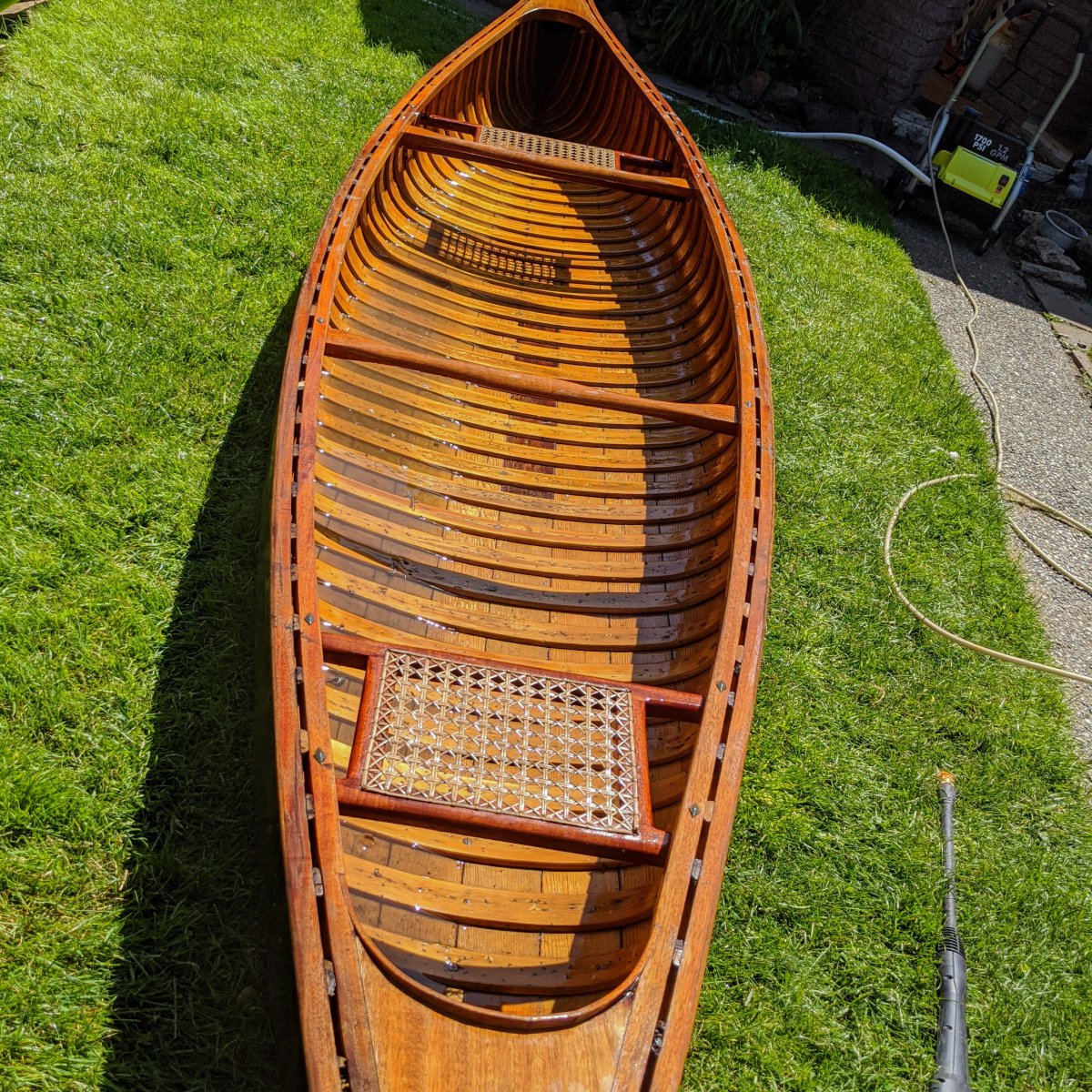

I was able to get a few coats of paint over the sanded canvas but won't have pictures for a bit. Had to suspend operations due to inclement weather so everything was tucked away. Gave me a chance to start sanding the trim. I found a greenstick fracture at the end of one of the outwhales but it epoxied back together fine. It's nice to see good wood under the salt damage!
You see a red boat and you want to paint it black
Don't. Don't do it. I'm already regretting repainting in the previous owners color. Black is a bad choice. The sun came out in full force as I was doing the second coat and the boat got HOT. It was like painting a pot bellied stove after a while. I'd be worried about it on a trailer on a hot sunny day. Even with a temperature controlled setting, the final result immediately started looking dusty/dirty. I suppose once the shiny side is in the water it won't matter, but I'm not a fan.
At least it will only be a single season with this canvas.
