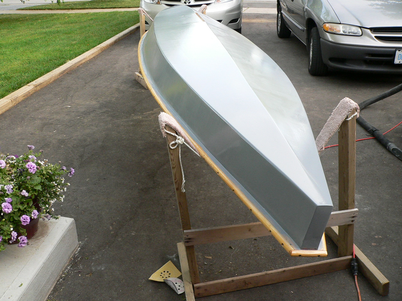

its finer in primer
Andre Cloutier
Brings back the old bike building days:cool:
S&G forum's kinda lonely; next up two part poly finish, rolling and tipping and fingers crossed.

Life's too short to sail an ugly boat
Gil, good pointttttttt.
Sailing wont introduce anywhere near the same torture as your fishing machine, and this is my opportunity to practice finishing before some upcoming restorations. In fact, this hasnt taken much more time than other cheaper finishes would have, but your point is well taken. In days gone by my snowmobile and dirt bike were fairly embarassing cosmetically although mechanically bulletproof. Even my restored Nortons got used, like we used to say "ride em dont hide em":p

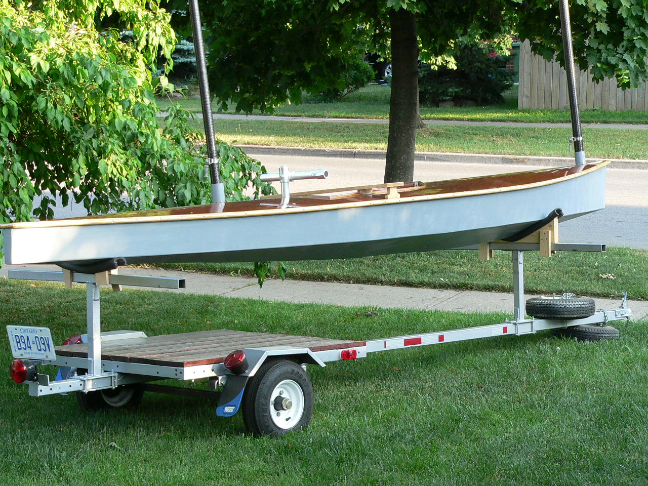

racks
Gil,
the tongue steel I used was 2"x2", so I used a 3" base plate to weld them to ( and 3" plate under to bolt to). I like them adjustable so didnt weld them direct. I left the cross bars 48", but you could go any length, and if shorter steel is used just bolt a 2x4 or similar to widen them. Steel is great since you can add to it even if you've cut it twice and its still too short. That thing is the greatest, I dont put canoes on the roof anymore and you can do warp speed down the road with no worries about your boat. If you were closer I'd whip up a set for you in no time.
what did you use to tighten up the fit of the masts in the tubes? Oh and do you have a shot of the arrangement you used to hold your dagger down?
I pretty much followed John's lead on these. Main mast I didn't do anything with. For the mizzen, I got some rubber gasket material from Home Despot, and wrapped it with self-bonding rigging tape (cool stuff!). Used the same tape on the crosshead too.
For the daggerboard, I put in a couple of 3/8" grooves across the top. Bolted 6 eyes to the cockpit sole to hold down a couple bungee loops. I've been tucking my spare paddle under the loops too...
