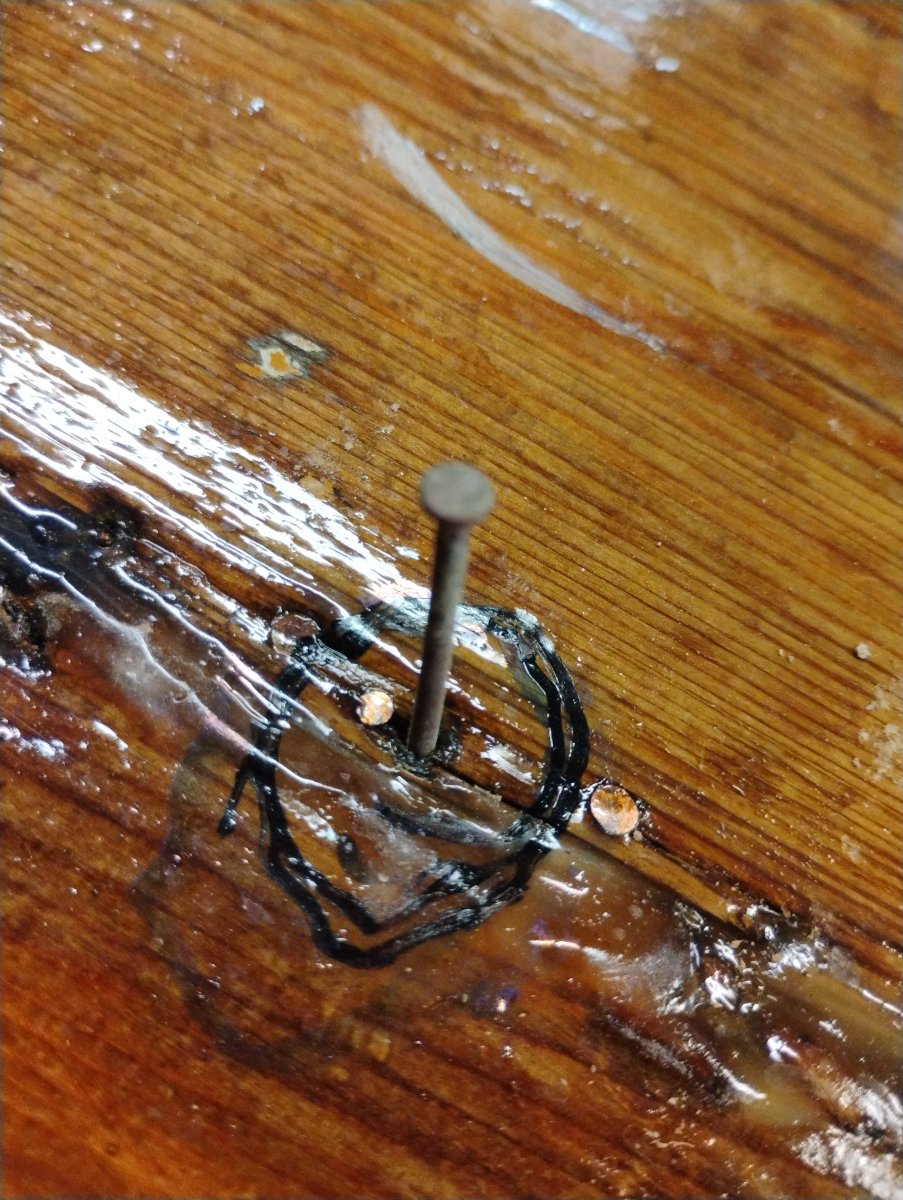

I took it twice to the lake and immediately returned to shore since it was leaking. This time I kept it in the shop and added water on top. No leaking.... maybe water only goes one way.... I'll wait for a warm day and go to the lake again. I never had this problem with a canvas canoe
