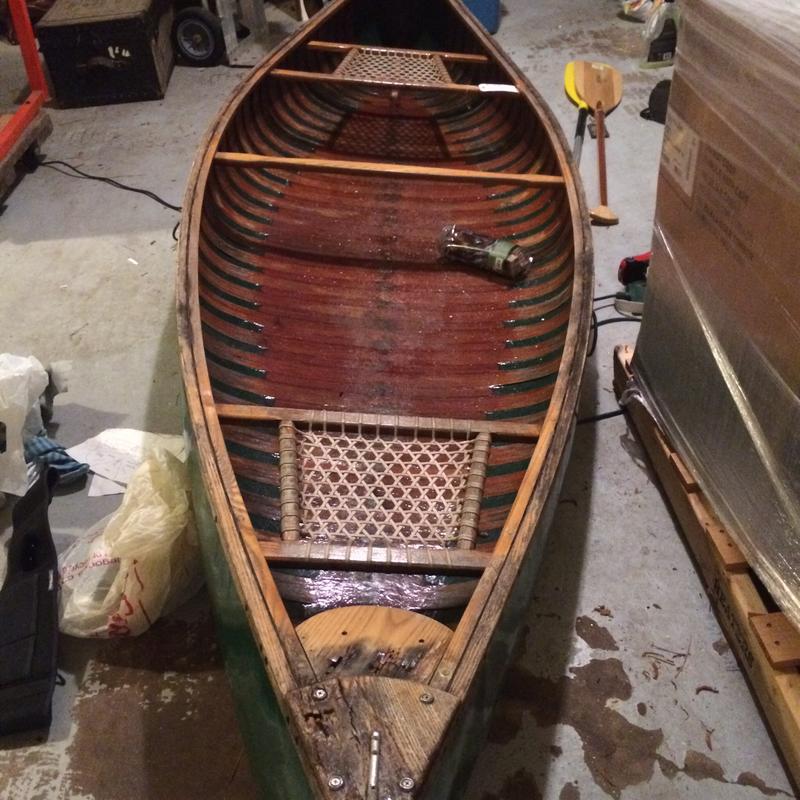

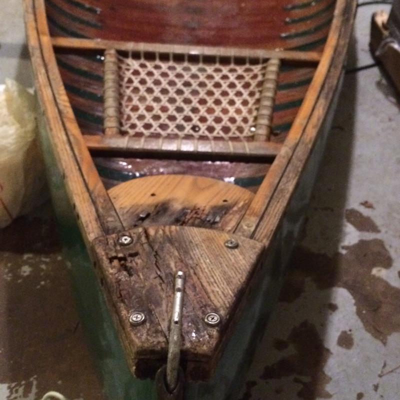

image.jpgimage.jpgimage.jpgimage.jpgimage.jpgI have no idea what to do
Have a wood canoe
Serial
SWE 31308-873
It's wood inside
Green on outside
Help please

Hey thank you so much for all the info on my canoe! I live in atlanta, ga
Is the canoe a good one? Company went out of business. Huh I sent some picss
I want to take on the river soon
What do you think about these canoes? You seem to know a lot :)
Is it something to hang onto? Keepsake? Or just put on wall or use on lake? No idea
It has been refinished I think
Yes
That is exactly the same canoe. Mine appears to be in good condition a little dry rot on tip end. Other than that it is pretty

There is no reason not to use this canoe, on a lake, river, or whatever water you have available. It is not a rarity, and has little or no value as a collectible or antique. If you like how it looks enough to hang on your wall, why not? But most here would think its better use is for on-water recreation. Of course, you could hang it on the wall when not paddling it.
It looks like the interior may have been varnished -- a good thing if marine or "spar" varnish was used -- to protect the wood inside the hull from ultra-violet damage. The "green" of the hull is fiberglass, I believe -- an occasional waxing of the outside will help to keep it looking good. Revarnishing with marine varnish from time to time will keep the interior in good shape -- ordinary varnish will rapidly deteriorate and peel off.
The rotted/damaged wood deck should be replaced, as should any other wood with rot -- rot never goes away, but only spreads. It's hard to determine the exact condition of the gunwales from the pictures -- the discoloration may only be surface UV damage, in which case you could remove them from the canoe, strip all old varnish off, sand away the discoloration, revarnish (with marine varnish), and reinstall -- all quite simple tasks, if a bit messy.
The dry rot on the canoe tip(s) comes from storing the canoe upside down on the ground -- something that is ok for a few days when camping, but is not a good idea for regular storage -- store it inside if possible, and if not, upside down raised from the ground (sawhorses are commonly used).
A wooden canoe stored outside should also be covered...or under cover. IMHO, just off the ground, upside down is not a good practice for long term storage. Short term...while on a vacation or camping trip, not an issue, but.....
I've had canoes come to the shop that were not stored on the ground, but outside and upside down on horses or some kind of supports, that have rotted tips of the stem, gunwales, and decks.
Water will run off of the hull, down to the gunwales, along the gunwales, and the largest percentage of water will run off onto the ground. What doesn't run off to the ground will secretly...over time, and each time, wick back into the the tips...and over time, begin to rot.
Based on my theory of wicking, I caution wooden canoe customers to support their canoes with horses or supports with a distance between them that equal 1/3 of the length of the canoe, upside down, and under cover from sun and rain.
