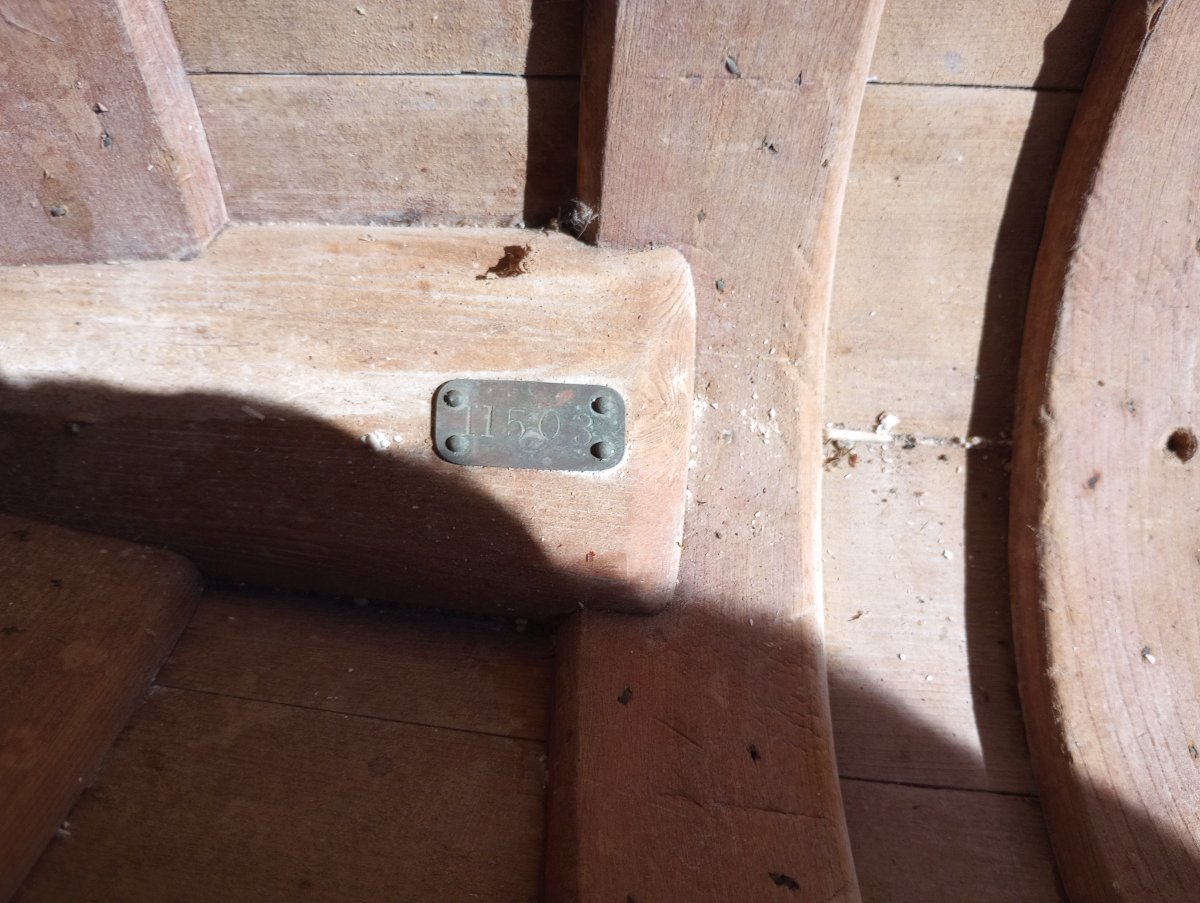

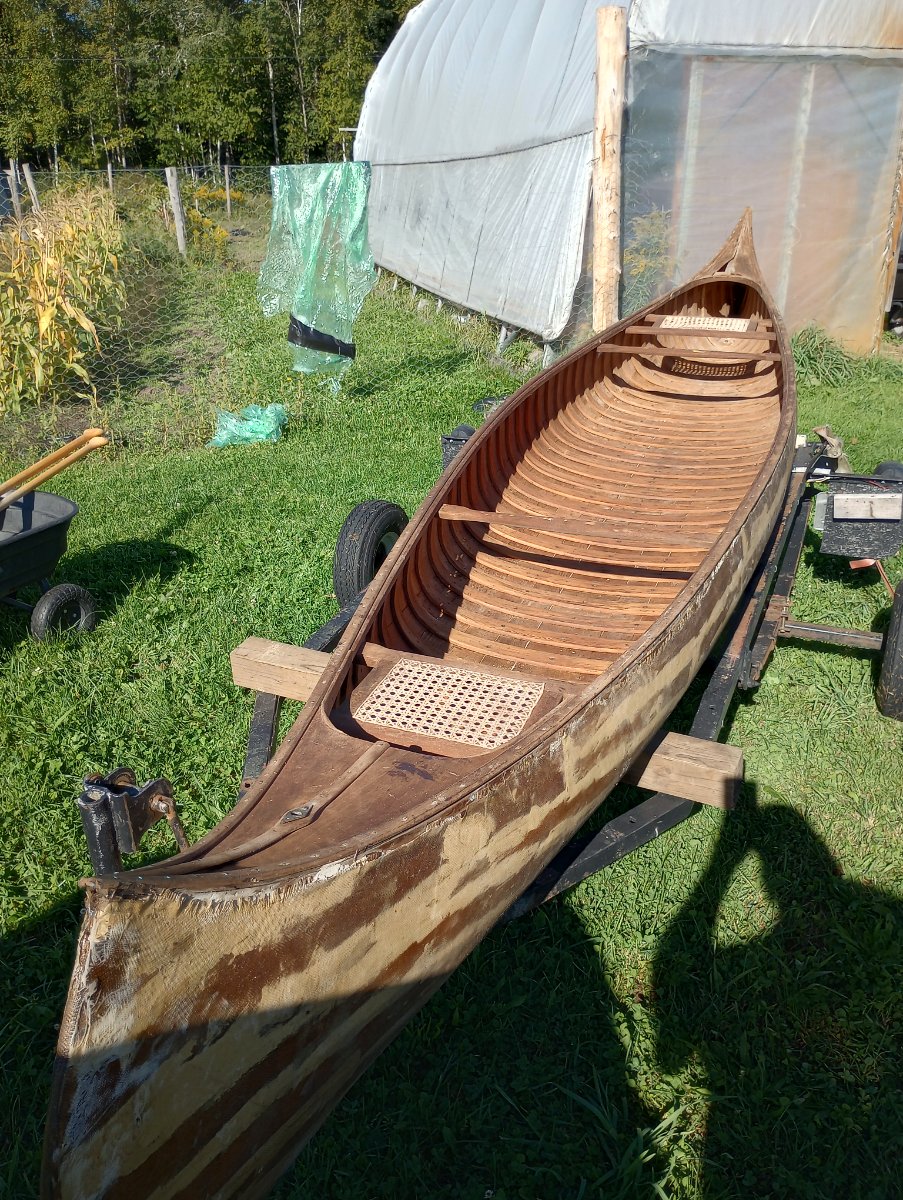

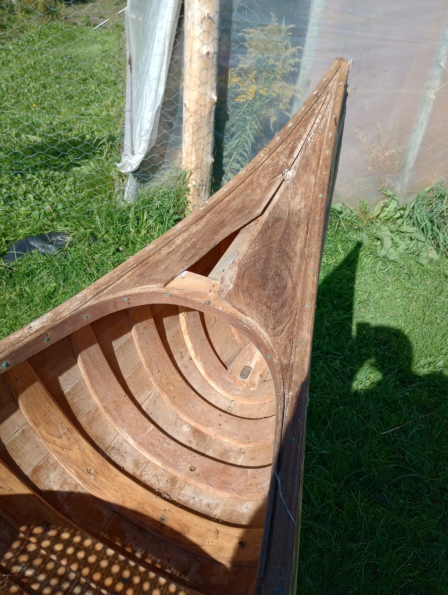

You have a BN Morris, made in Veazie, ME in about 1913-1914. Morris canoes are among the finest cedar-canvas canoes ever made, in my opinion. They are beautiful designs and expertly made. The stem shape, the brass serial number tag, and some other obvious features identify this clearly as a Morris.

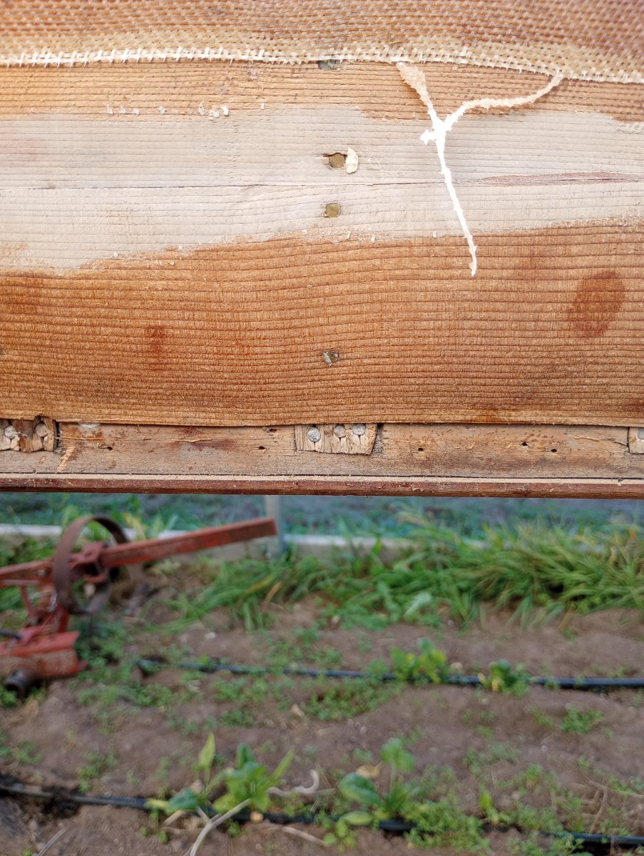

Your canoe has the longer Morris decks, and they and seat frames and thwarts are likely made of Central American mahogany. The hull is cedar. Your canoe looks like it's in good condition but it is covered in fiberglass, not the original canvas. The canoe looks like it may have once had outside stems (search these forums for more info on them if needed), and the center thwart is missing. The gunwale on the starboard (right) side might have a crack or break, but this could be an optical illusion in the photo or the gunwale could be misshapen because of the missing center thwart. Other than the fiberglass, all other components of your canoe appear to be original.

We plan to remove the fiberglass and replace it with canvas.
The outside stems, brass stem bands, outside gunwales, keel and two courting backrests came with the canoe.
