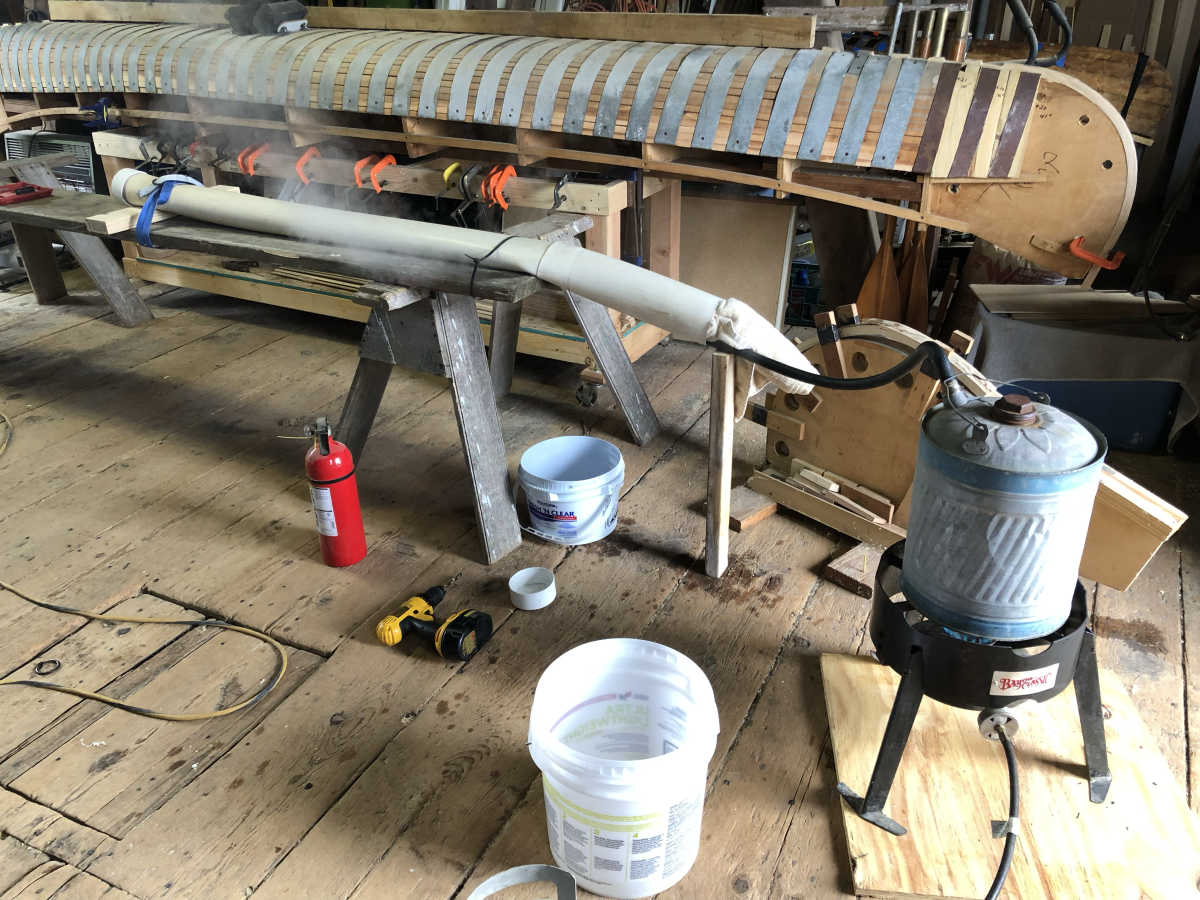

An old gas can will do.
I use an old kerosene can, and no matter how many times I fire it up it still smells faintly of kerosene. No ill effects on either ash stems or cedar ribs however.

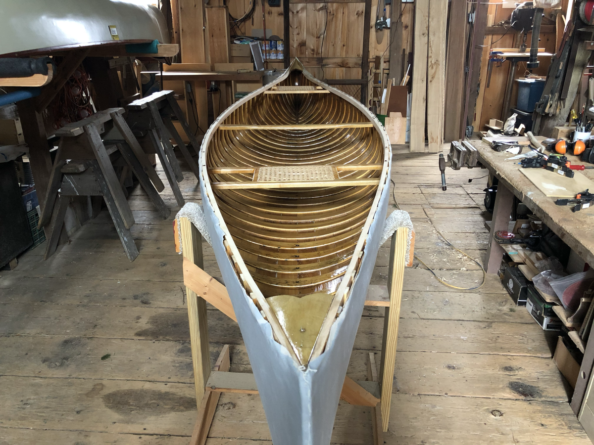

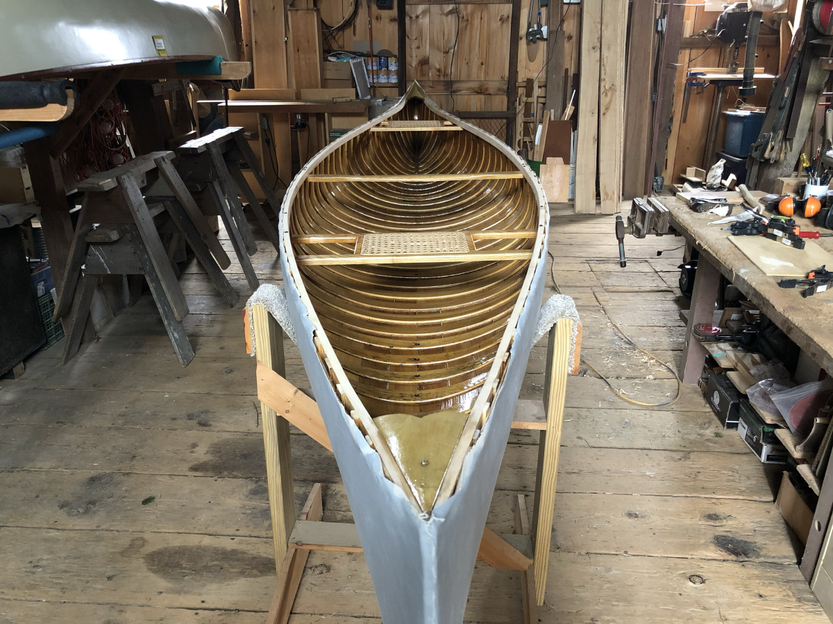

The canoe looks lovely. Did you re-cane the seats yourself?
Thank you. The seats were beyond repair. At some point a previous owner had nailed plywood over the frames (and ruined cane), and the bow seat had been moved so far forward that it was too small to re-position in the correct position anyway. I made new frames of Ash, and caned them in the Chestnut pattern. My fourth and fifth cane seats... I enjoy the process and have done two different patterns.
I use an old kerosene can, and no matter how many times I fire it up it still smells faintly of kerosene. No ill effects on either ash stems or cedar ribs however. View attachment 55065

Beautiful lines and looks super. Did you re-cane the seats yourself?
