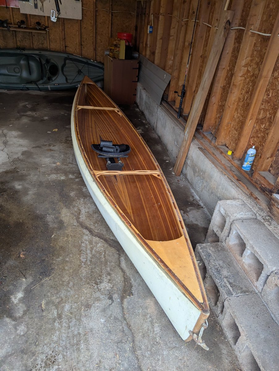

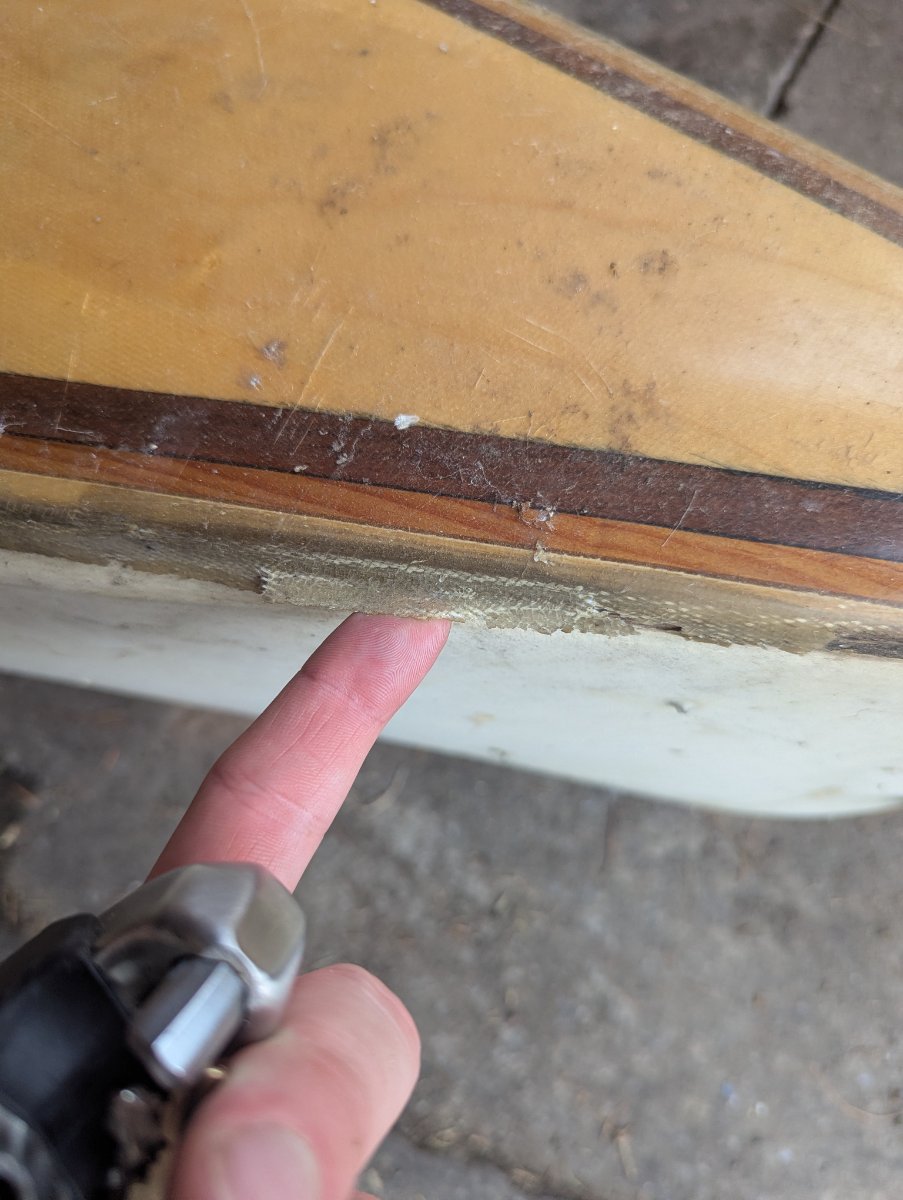

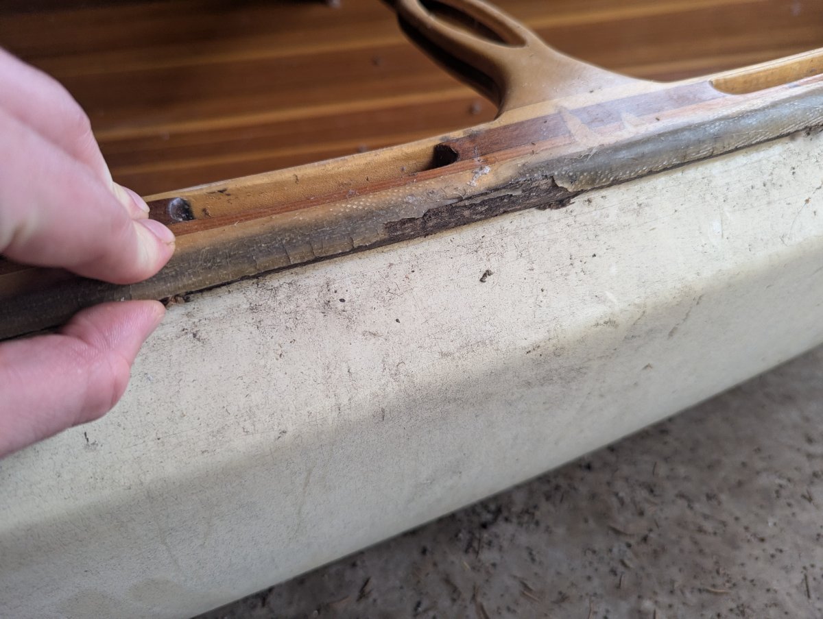

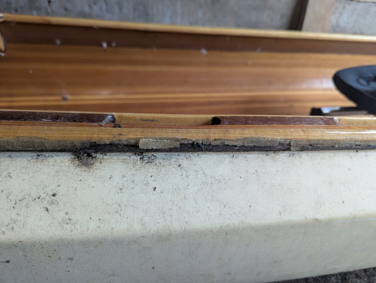

Ive recently come into possession of a handmade wooden canoe! The only issue is that the fiberglass finish on the gunwales has started to peel off. From what I was told is that it was stored outside for too long and the weather/water started to make it peel off. What would be the best way to approach this repair? Just peel/sand off the fiberglass and reapply? Ive never worked with fiberglass so im not sure where to start and I have not found any great resources yet. Thanks for the help!

That's a handsome canoe. I would probe the wood underneath to see if it is soft. If it's sound, clean up any dark areas with wood bleach and sanding if needed. I have patched fiberglass on wood by starting with a sharp scraper. Any fiberglass that comes off easily needs to come off. Either scrape or sand the remaining glass to a feather edge. Apply new fiberglass over the bare parts, overlapping the edge. When it's "green" (dry but not completely hard) the scraper can cut off the overlap. Sand and varnish after.
You may do well to address the question to members at canoetripping.net, there are several active builders of strip-built canoes like yours, as well as many detailed posts of strip canoe builds.
Like Dave, I can't imagine why they thought that fiberglassing the gunwale was a good idea or any sort of improvement. It's not. Don't even think of replacing it, because it won't work, as you have already seen. Your job is to remove it as neatly as possible without disturbing the glass on the upper part of the hull. This might involve sanding, heating carefully and scraping or cutting it away and some peeling when possible. You will be pretty lucky if the gunwale wood under that old fiberglass is free from rotten spots. It wouldn't surprise me if the easiest fix turned out to be replacing the outwale with new wood. In any case, the best finish is going to be varnish on clean wood along with indoor storage. It won't deteriorate when you are out paddling but leave it out in the weather between trips and it won't last long. It's a nice boat and deserves decent care.
