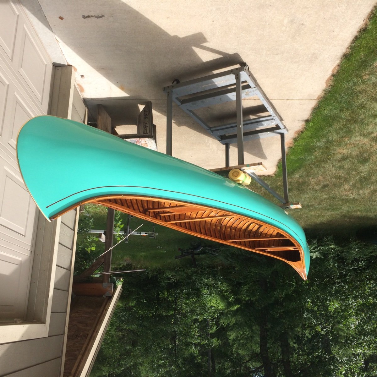

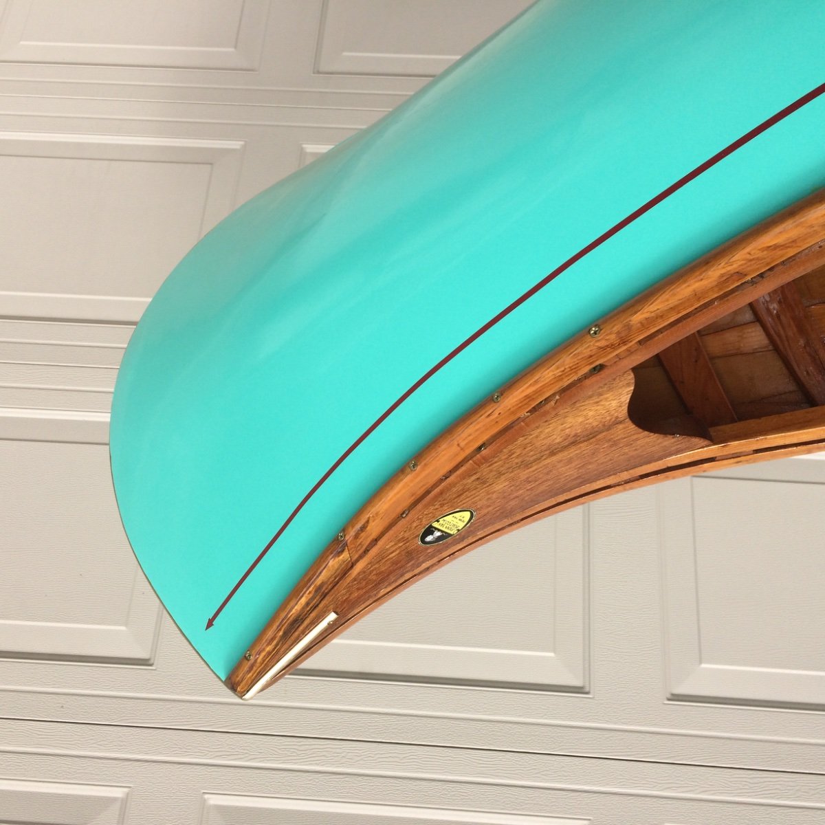

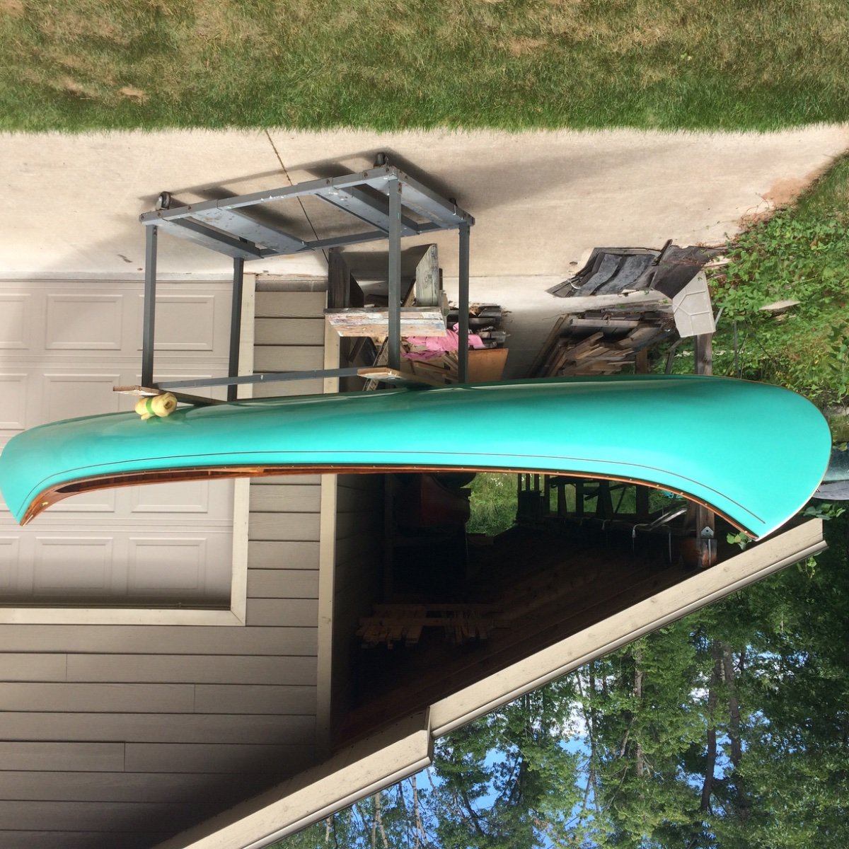

Reviving this old thread to see what folks think about the “Teal Green” #30 in reference to the Penn Yan original blueish/greenish color.
I know Kirby’s has a Penn Yan Green, which I was originally planning to use, but had heard/read good things about Epifanes and was thinking of giving it a try.
Thanks for any feedback!
Dan R.
A Penn Yan in Kirby Penn Yan Green.

That paint looks really good.
Looks like I’m going Kirby’s. Can’t argue with that paint job!
